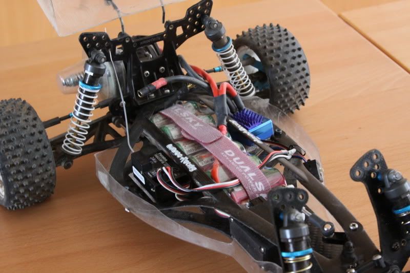

I can say for definite that the DS is great fun with a Novak SS5800 setup hiding in there (seriously tight fit though!).
Entertainingly fast, but required suspension changes due to the weight of the motor.

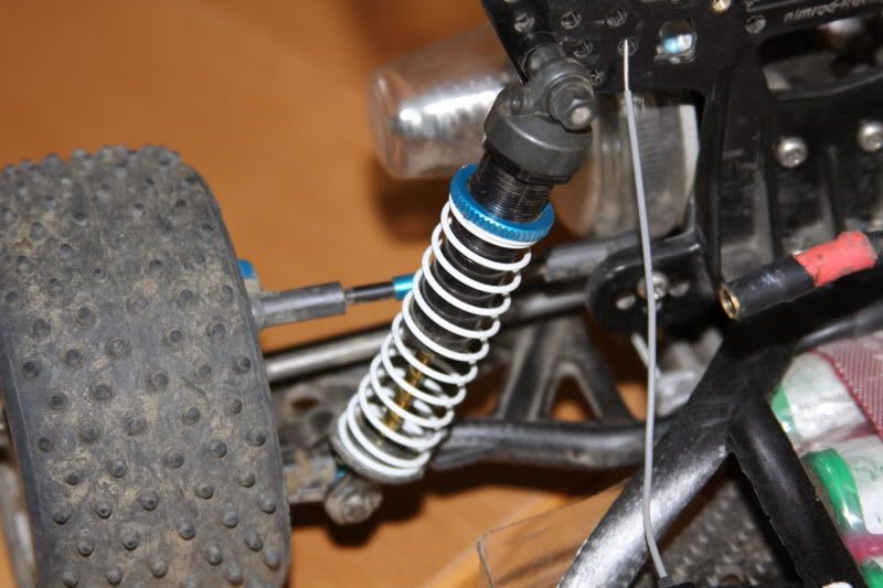

You might want to lower the front a touch, and make sure you have thick oil in the rear dampers. I like these modern receivers too, so tiny. Nice shiney wheel nuts!

I am also very interested to see how this brushless system goes - I picked it over an EZrun system because I thought Tamiya would be a safe choice on quality, and really, a 100A limit on the ESC vs. 60A on the new EZrun systems and only 35A on the old one really shows that Tamiya did put some reserve into it - Plus it has some adjustability features I have yet to check out. I'll let you guys know how it runs. And for the ESC cooling, I was thinking of either making the vent into a real one on the left side, or adding holes on top of the sidepod. If I do one of these mods though, I will add a mesh in the opening to prevent big dirt from entering the chassis.
As for the setup, this is built to manual stock, and I will work from there to see what works best for me. I am pretty certain though that it indeed needs adjustment to improve the handling characteristics :P

As for the setup in my car, a beefier servo will be ordered soon, I might tighten the MDC just a bit, and I will need a bigger motor pinion (acceleration vs. top speed is a little out of balance so it seems), but the speed from the Brushless setup is perfect, it's superbly silent and it goes like badword! Really a mean machine! :blink:
