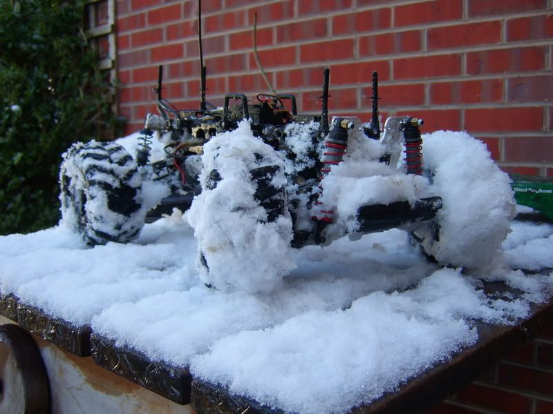

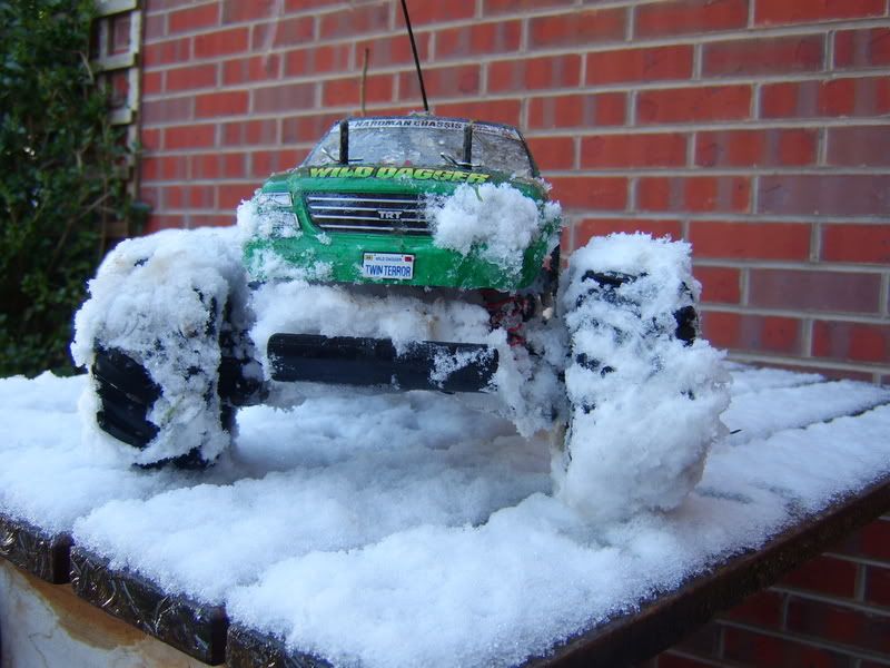

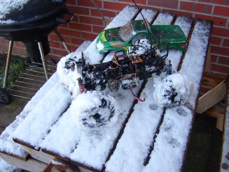

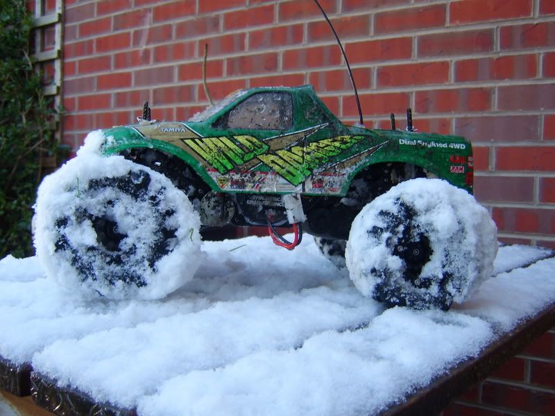

what gets me is both of yours are spot less, this is mine this morning, after thrashing around the woods yesterday (and ponds, it seams to be attreacted to water :-) ) and driving in the snow today :-)
last but not least drying above me boiler

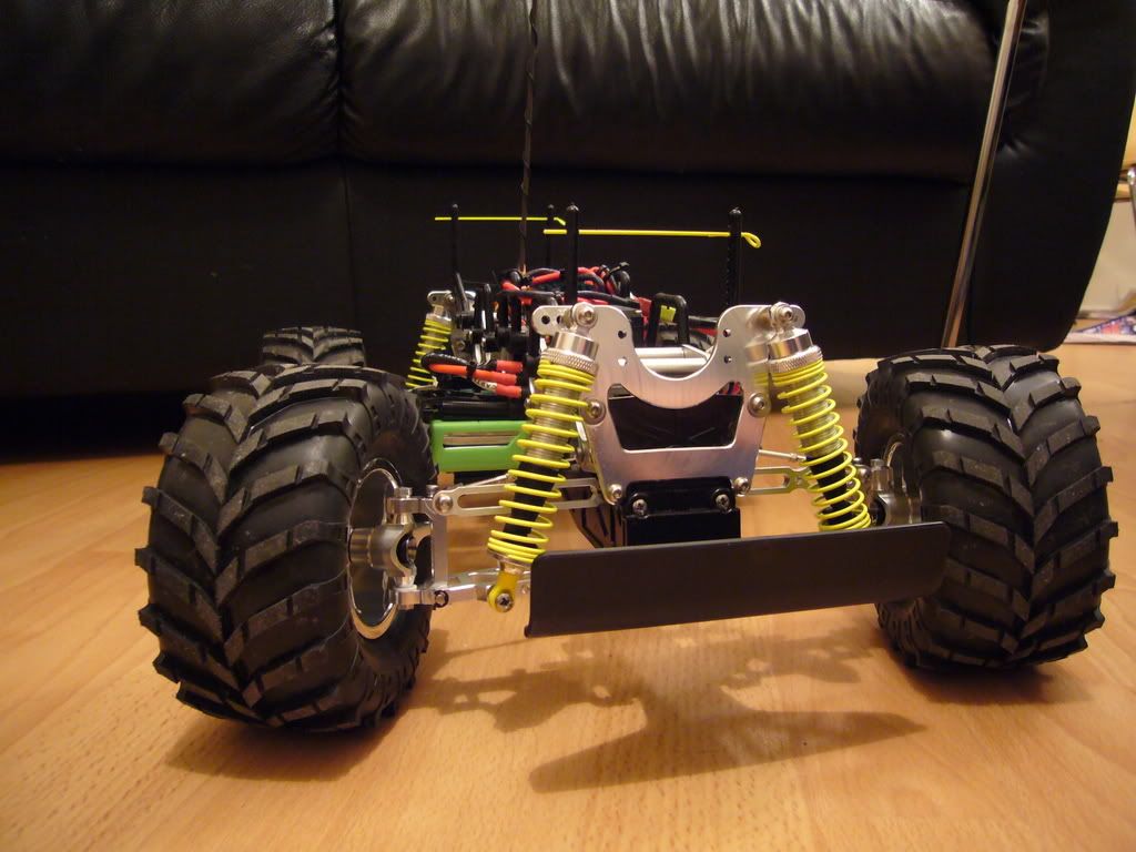

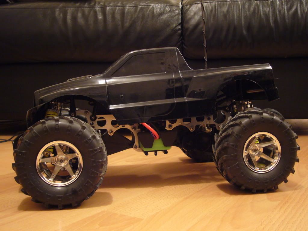

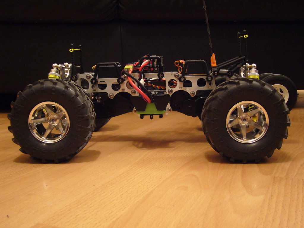

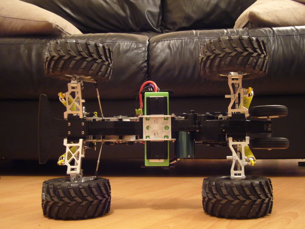

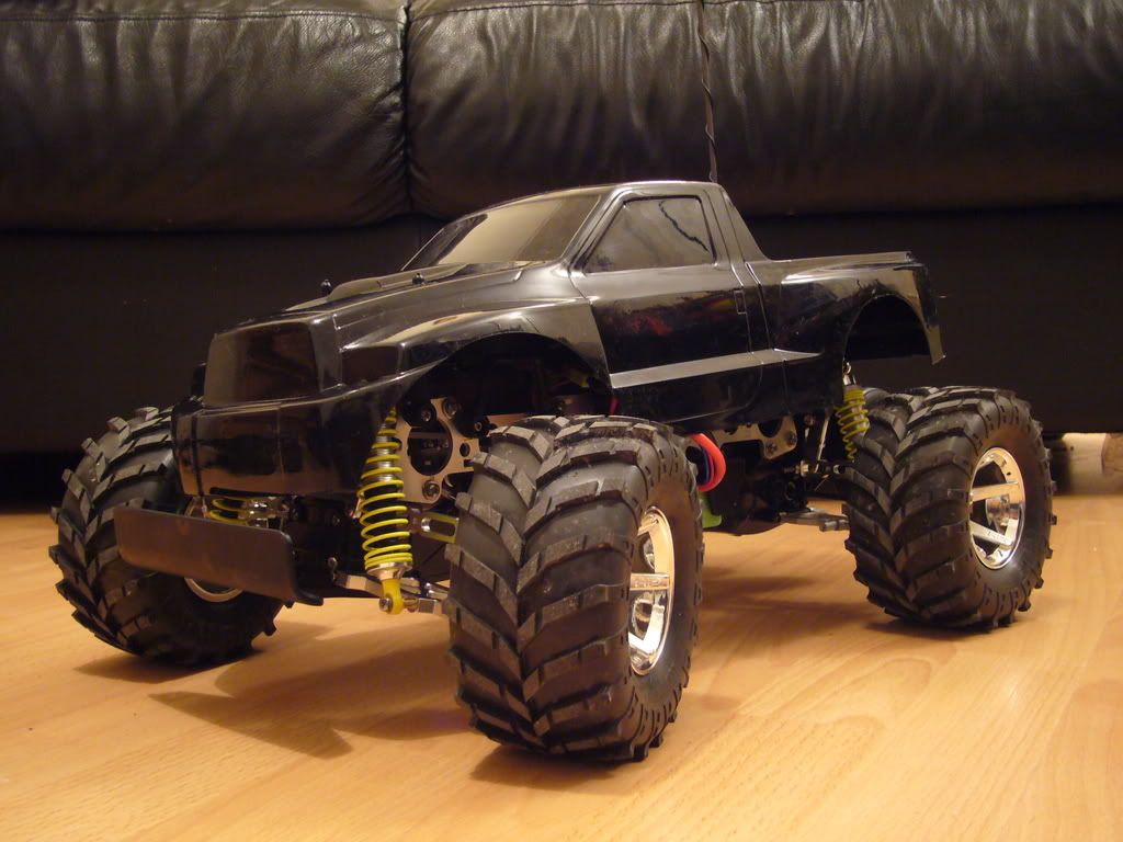

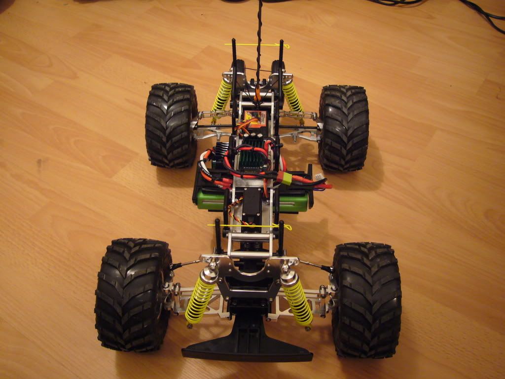

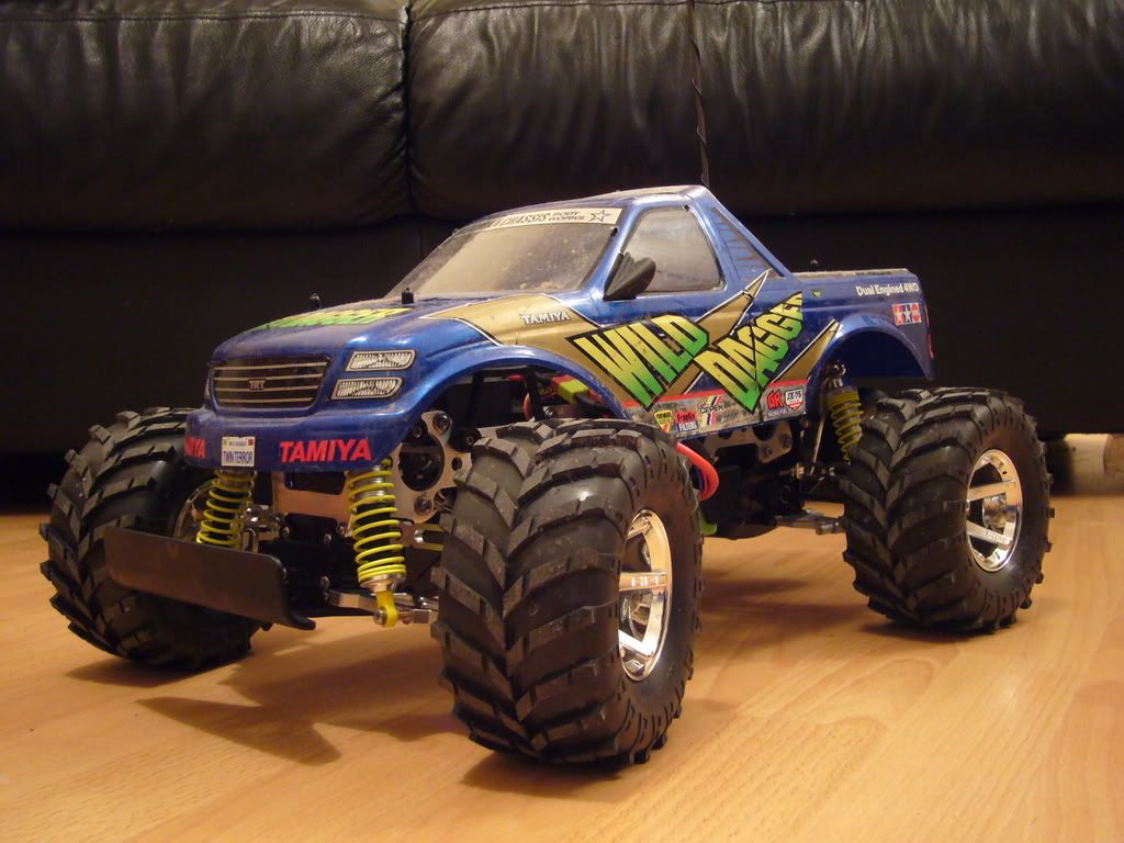

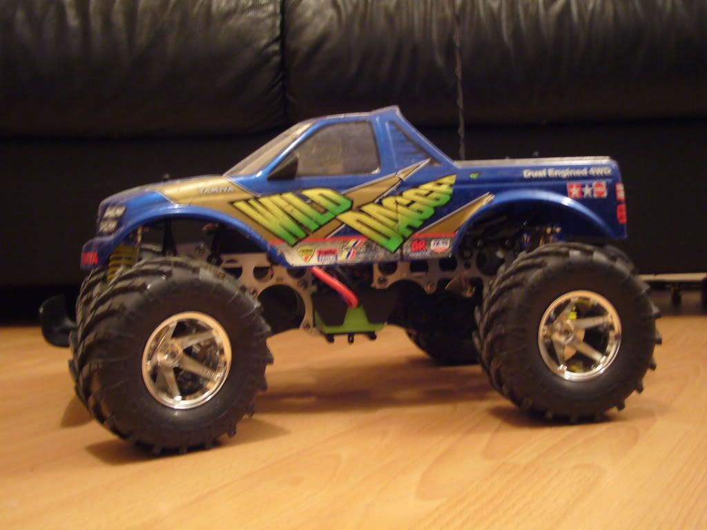

Finally got my allu chassis installed from bfst24. Still waiting on some reliable threadlock so haven't run it yet, might also change the body posts for two set of original rear posts (for strength - the allu chassis has no square lugs for support and the ones I have installed just fall about. Will also add a proper antenna tube as it currently suffers very bad from interference (I still need to solder the noise-reduction capacitors back onto the motor casing but my soldering iron is at my parents place).
Not sure what make the chassis is
Motors are HPI 550s
Speedo is a Hot Bodies GT 14.4v
Wheels are HPI Spikes in dark chrome
Tyres are Ho Bao Monsters - VERY soft and squidgy and look superb!
Body is a Parma El Camino painted very badly in the Minerva Dragons colours of Keeren Wells's pickup
Shock towers are from RCMart (not sure what brand)
Shocks are Yeah! Racing 4" jobs - springs are very too soft for all that extra weight!

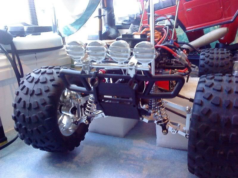

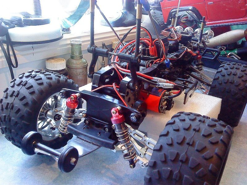

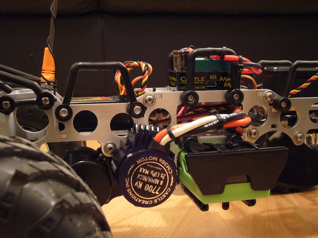

Finally finished my Brushless Blackfoot extreme, so though I'd add a few pics to this thread.
For those who are interested it's got the budget German alloy chassis, stainless steel and aluminium hardware throughout, one of Henry's fantastic custom super diffs (with 12,500 weight oil), Mamba Max 7700, Venom 5000mAh 7.4v LiPo, Hitec HS945MG servo, alloy front and rear arms, hubs, knuckles and hexes, alloy shock towers with 4" GPM emaxx shocks (with nice and soft 20wt oil),TG10 long axles, ofna dogbones, HPI wheels, Proline Masher 2k tyres, Wild Willy 2 wheelie bar with Frog/Hornet wheels, and some really cheap radio gear that I had over.
Still running it on 100% punch control at the moment whilst trying to get used to the power, and the rear braking only!

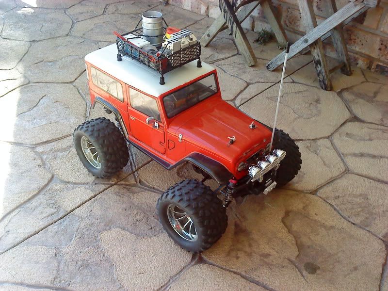

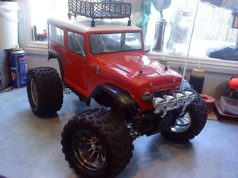

heres my dagger .. set up for crawling , landcruiser body, working lights , alloy bits and a few accessories ..
Love it!! Say, how easy is it to fit the Landcruiser body? Any special requirements?
I have a Detonator and would love to try it.
Paul
really long body posts ! or mount the body through the side like the frog . i used .22 magnum bullet cases to lengthen the posts then made braces for the rear posts
