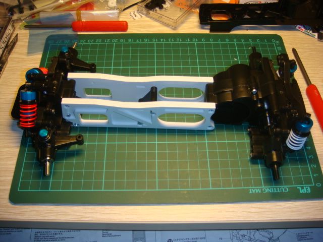

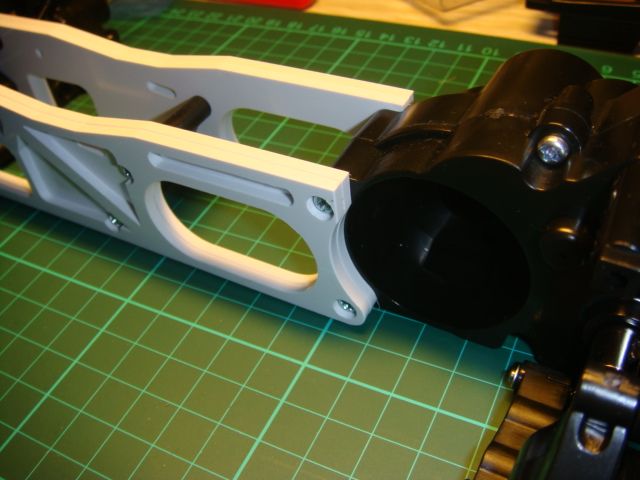

This is it finished, i'm not sure if i put this picture up before or not but this is where it belongs. :D I will resize some of the chassis pictures and put up a few of those. Short M04 with ABC Toyota Levin Corolla body. I ended up making new chassis rails from ABS.

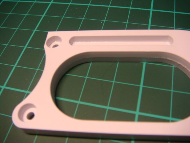

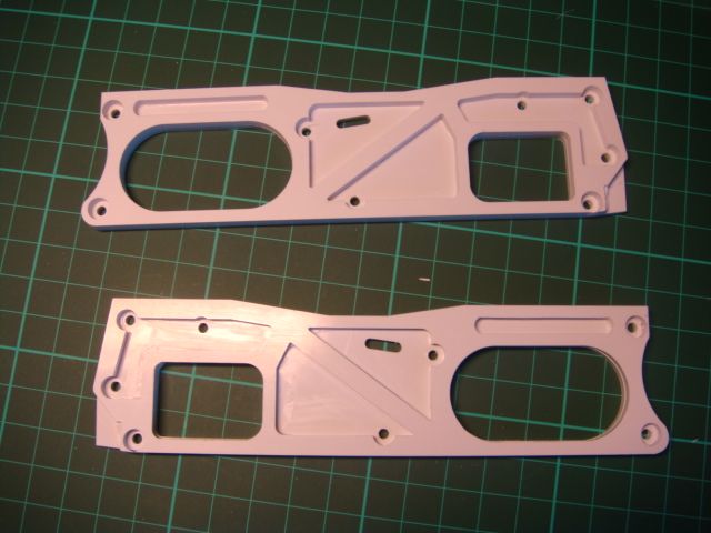

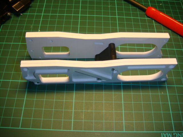

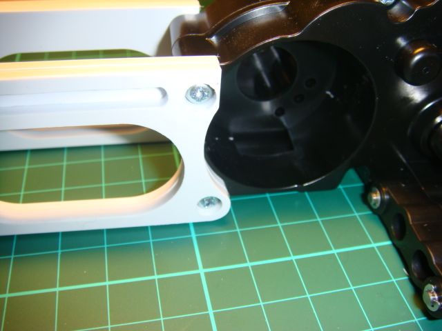

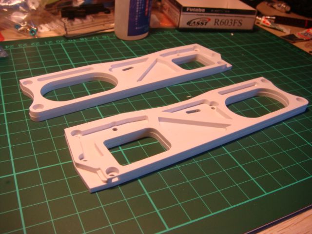

Here are components that will be used to put the chassis halves together. I went for ABS sheet, ( i need to double check but pretty sure it was 3mm high grade). When the 2 halves are glued/chemically bonded together they will be as strong one piece. We were cutting 3mm that day so it was just easier than doing it in 6mm.

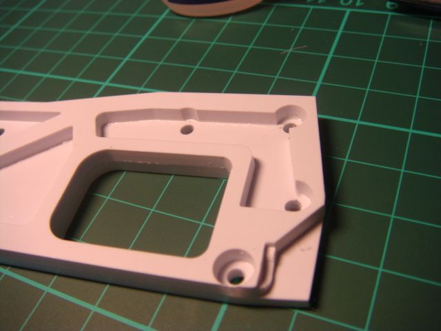

Can see it needs a little sanding off. The solvent/glue has bonded the ABS and in the battery holder and steering arm hole you can just see some of the melted plastic has come out between the 2 halves. This is a good sign and should be prove to be a decent bond.

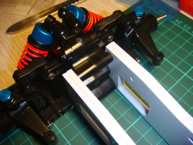

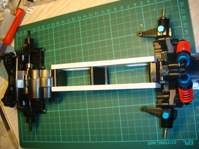

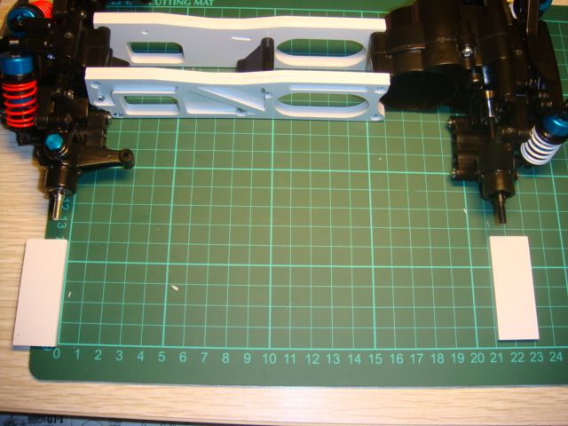

The white pieces of plastic were stuck to the board for me to double check the wheelbase centerline against them (plastic bits) with a set square before I took it any further. The axle centers really are directly over the egdes even though the picture tells a lie. Will post some of the body fitting another time. cheers
