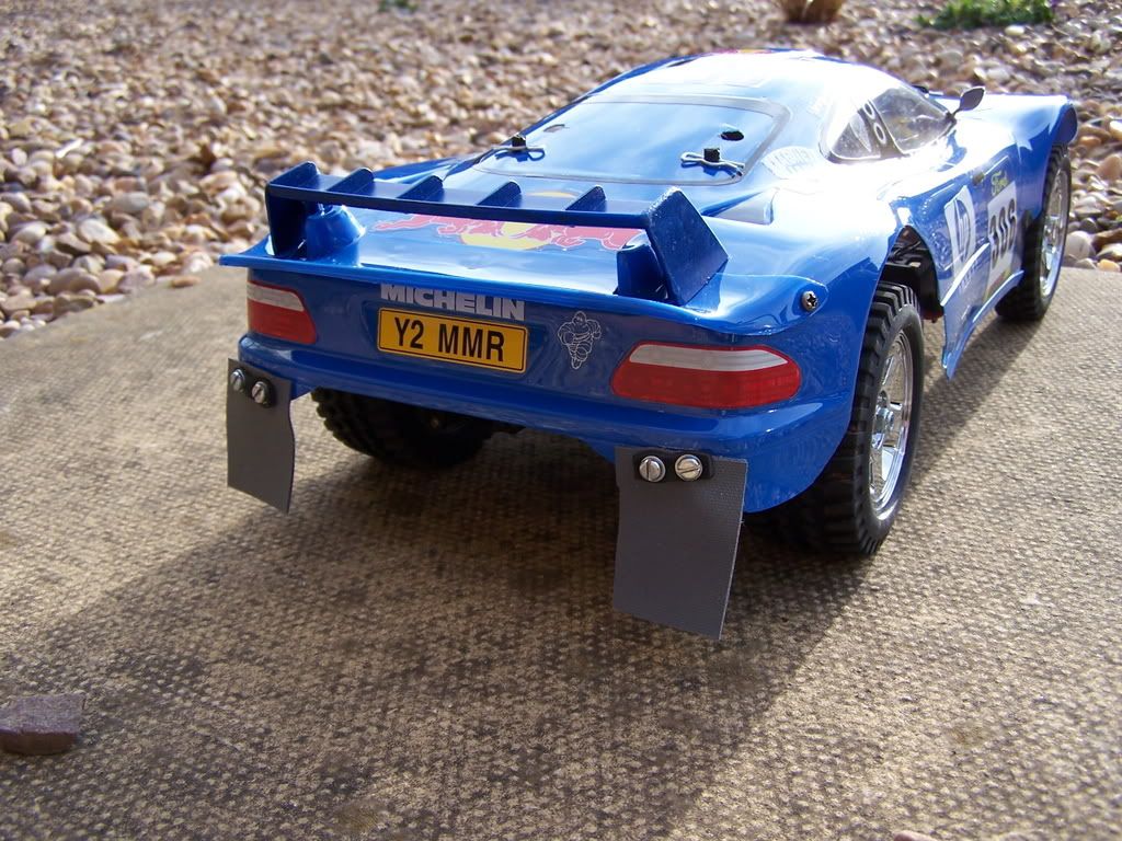

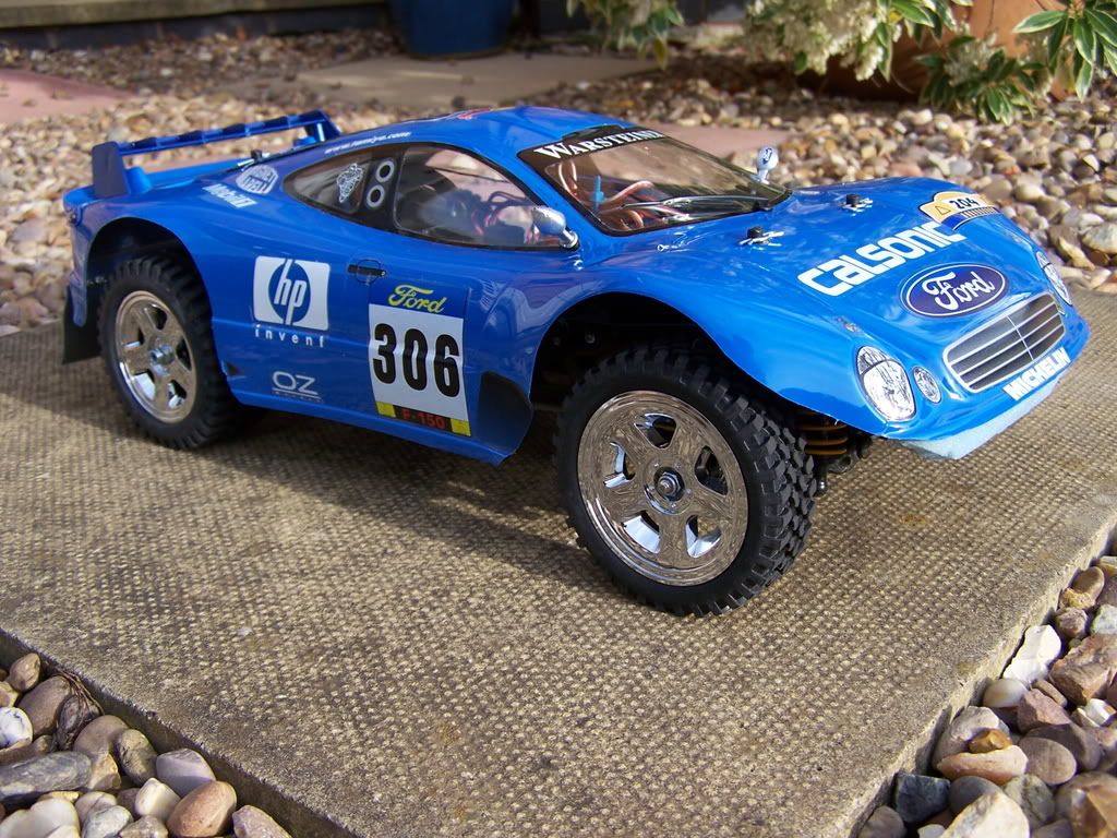

What about something like this?
Extended MO4 with a mix of TB01 and Tl01 suspension, very stable, fast and with good travel, also good stock bodymounts and even trottle heavy here can drive it well as with the large rear tyres from carson its well planted and very good at direction changes thanks to the simple and effective steering and lightweight.
A full build thread can be found here http://www.tamiyaclub.com/forum/index.php?...t=0&start=0
regards Ryck

Well not entirely as
I thought about doing the ever-popular Hopper/Hornet baja, but I'm too trigger happy with 2 wheel drive buggies. Maybe the fish-tailing of 2wheel drive cars is part of the fun! :P
This mighty well be true with cars such as the hornet, sand viper etc where by there is a massive rearward bias on the weight distribution with much of the gearbox sitting over or behind the rear wheels in aid of traction off the line. However this puts a larger strain on lateral grip whilst cornering, leading to the point whereby under hard acceleration from the corner you can spin out.
However with an MO4L and an additional spacer the bias is much more forward for instance the gearbox is before the rear wheels as is the battery in a mid mounted position pushed relatively forward by the extra spacer by some 20mm to the conventional MO4L. As such the rear wheels are far less loaded and the car is more neutral in handling. Couple that to some larger rear tyres with shorter sidewalls such as the carson ones and you get something very akin to the bridgestone F1 setup whereby your work the tyres surface not the tyre wall and so keep lateral loads limited with a more forward weight bias, as opposed to having a rearward bias and working the tyre wall as well in order to keep the contact patch in contact as much as possible as thus increasing the load before traction is broke break.
This Bridgestone setup works the tyres more evenly putting the emphasis on both front and rear tyres to take a more even load. Unlike the michelins of 05/06 whereby if you watched F1 the bias was very rearward and the rear tyres took a lot more of the workrate shown in the switch last year to the same tyres for everyone and renault and mclarens issues with rear tyre wear from there previously rearward bias.
In addition if you look at real life 2wd desert buggies these days they are less and less tail happy with only bodywork behind the rear wheel line and a lot of the heavy fuel tanks and other items located centrally and often in part at the front of the car in order to "light" up the front tyres by mass transfer.
I accept as we all know that the 4wd will be more planted than the 2wd but its just a point that something like what I have pictured above is not going to be tail happy in the sense of the other 2wd buggies that you would have owned.
