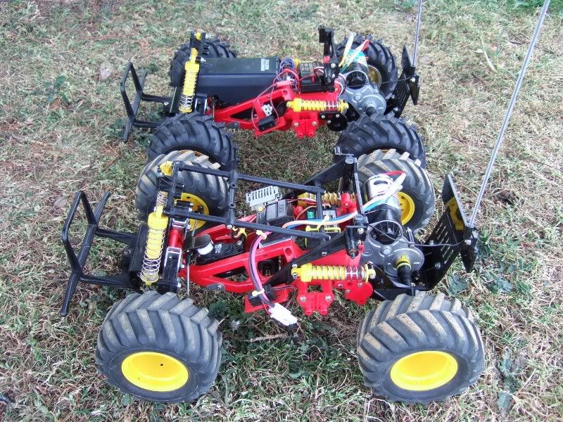

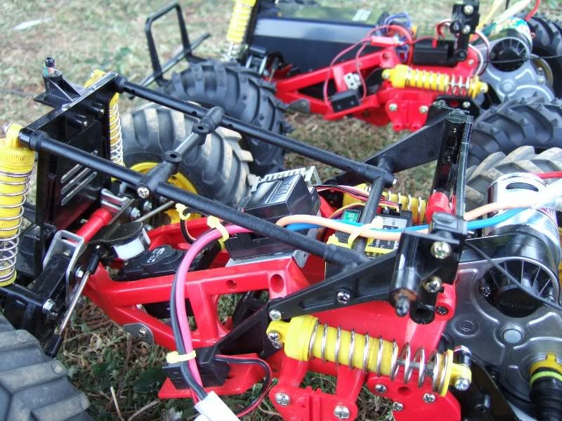

Here's my modded beetles chassis:
The CRP chassis bracing is a nice addition to the chassis, it makes it a fair bit tougher. The rear suspension bushings are also great, along with rear suspension mounts, front knuckles, differential bearing supports and more!

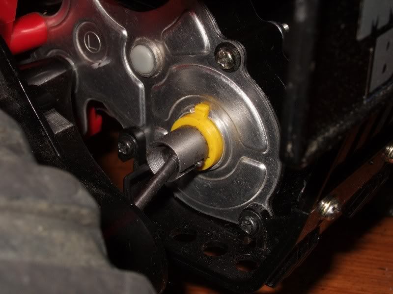

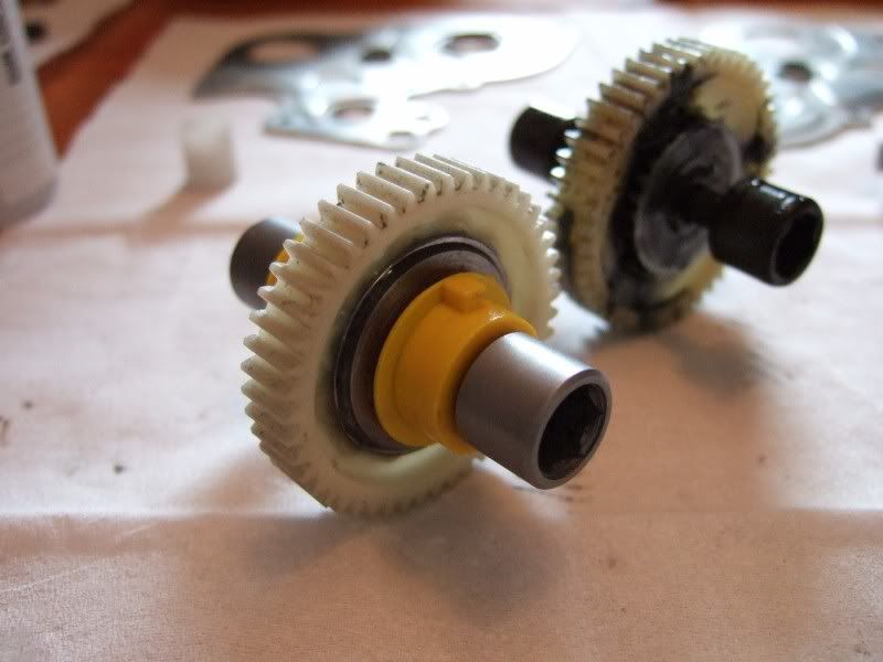

The ultimate in upgrades for the chassis is the Thorp Dirt Burner ball differential. They are rare, and not cheap. But well worth the effort in tracking down as they replace the weaker geared differential.
Dogbone drive shafts were also made by Thorp:
but you can get re release frog ones now, which are just as good but not as expensive.
