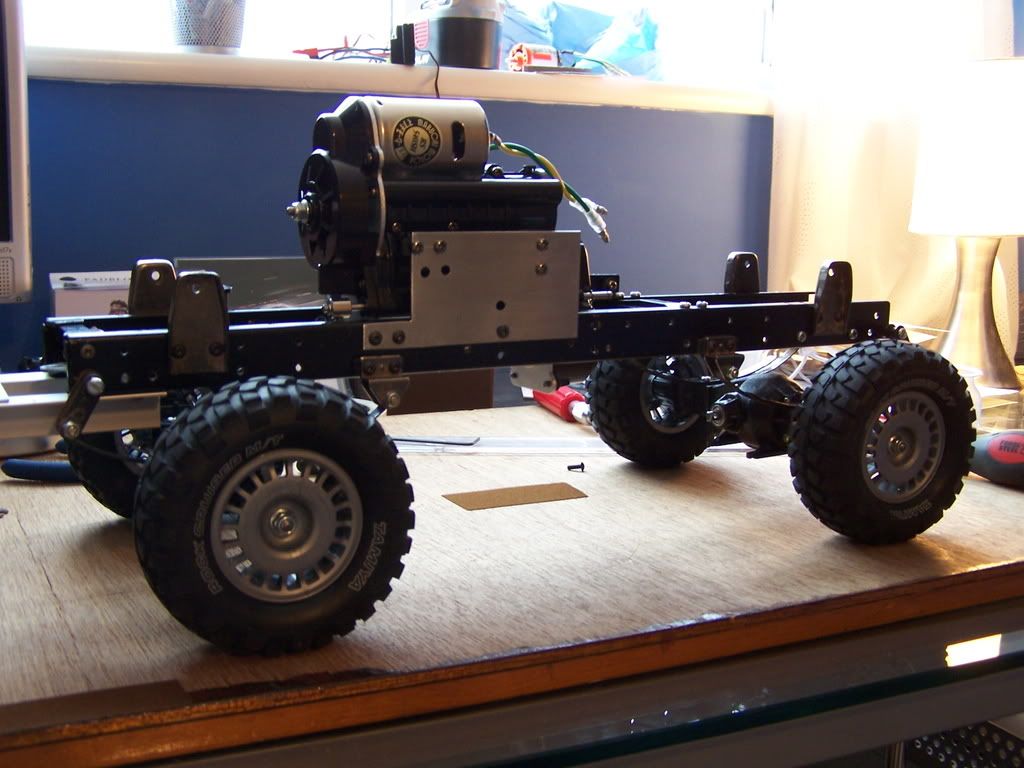

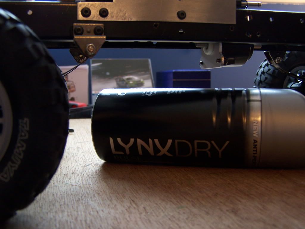

Most simple and lazy way to sort out the ground clearance issue is to just make some plates and raise the gearbox up a bit. I have some plans somewhere I think, Mine where modifided to move the box back as well to fit in my race truck but you will get the idea from the picture below.
Was
Now
Cheers Ryck
