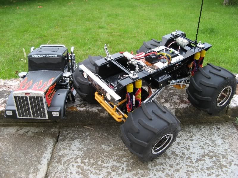

Freshly installed this afternoon, along with 2 new Sport Tuned motors. Plus some funky IMEX tractor pull tyres.
Oh boy that's given my Bullhead a lot more oomph.
Its pulling wheelies with a half charged 1800 NiCd battery...

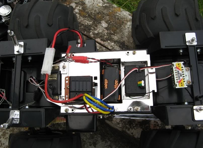

The wiring is a bit of a stretch, but some clever tucking it away got round the problem. The ESC is stuck on an old MSC base with velcro. I had to swap one motor's leads round, but becuase I used stick Sport Tuned they don't need to be zero timed.
BTW, that lovely chromed battery tray is a proper old CCP one, not the Ebay repro rubbish we've been recently slagging off here :angry: Bully is happy with the attention, and I'm very pleased with the result. B)

How come your chassis is black? Fantastic looking example of a Bullhead. I'd be ashamed to show you mine. Especially as I snapped off the front bumper mounts. Why do you have a servo mounted infront of the ESC? What purpose does that serve?

My guess is the servo was for the Mechanical Speed Controller & somebody was too excited to run the truck to remove it :(.

If that chassis is not sprayed it is from a Clod. I have a Clod with the red Bull chassis and a Bull with a black Clod chassis.
