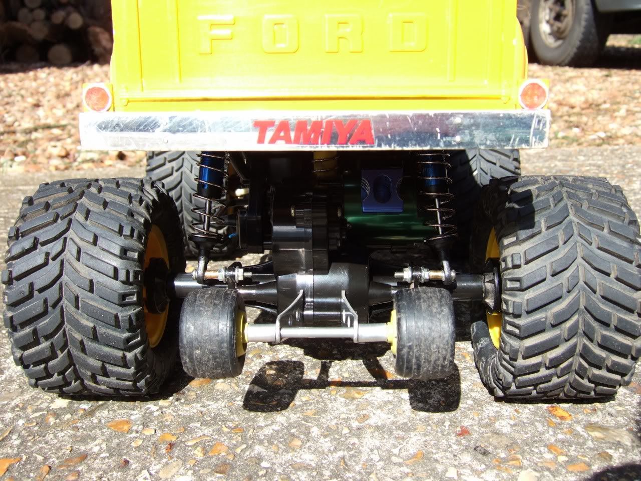

I came up with that mod not to fix the steering, but to stop the rear axle from wobbling about in its mountings. :)
But, it does help reduce body roll which means that cornering is improved just a little. You can see how I've attached them in this picture:
Basically just a few nuts and bolts!
