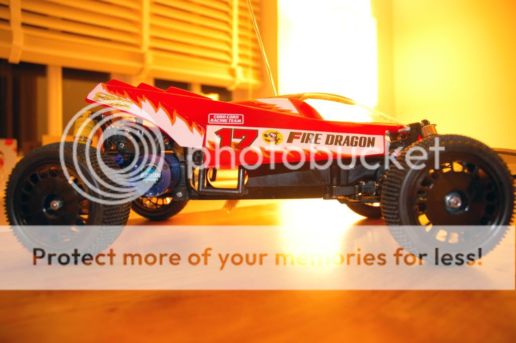

Well kind of. Took the FD out tonight on tarmac. After a while the power delivery started getting jumpy, I thought the batt was running down. Then the rear wheel came off. This has happened quite a lot, but I had just applied some thread lock the other day. When I looked at the wheel, the inside was totally mashed!
This could be down to me over-tightening the wheel nuts and/or EZRun's wrath...?! I can see cracks starting to appear in the other rear wheel too. So I guess it is just a matter of time before that goes too. I love the look of the standard wheels so I may just get another pair and watch my tightening....!

Ran the FD for 7 metres today before the Front wheel came off! :) Man I am having really bad luck with the FD. I have only manage to have 1 proper -run out the battery- run since I have had it!
All the wheels appear to be cracked, even the new ones I have only just put on. I was careful with over tightening too. So now I need some indestructible wheels! Will post when they are on.

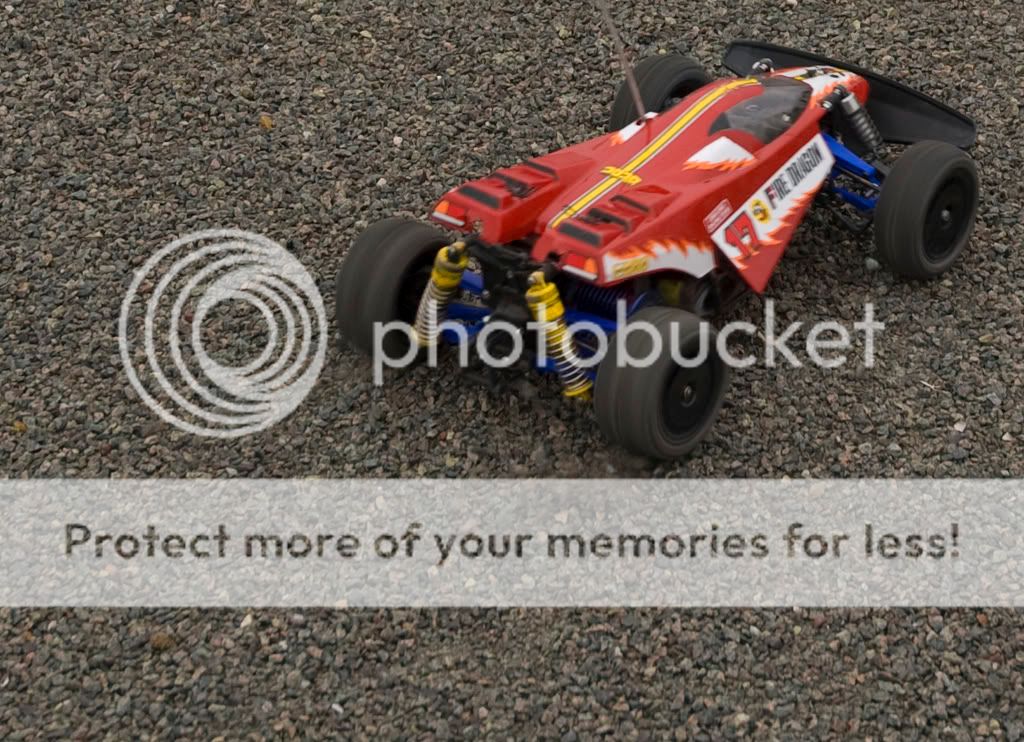

Tested the FD with its new wheels and tyres! What an improvement! 1st off, the DI wheels are black so look like the originals at a glance, also they are slightly larger in diameter so better ground clearance. The tyres have sponges so are a bit firmer, and the tread is flatter in profile but softer. So much more grip. On tarmac the FD squats at the back under acceleration and sticks, sometimes leaning a wheel in the air. On loose surfaces there is much more forward motion and less wheelspin; I have also noticed that they kick up less dirt compared with the originals.
Got through 4 battery packs before the ESC over heated. What fantastic fun! ;)
Oh, and nothing broke!
