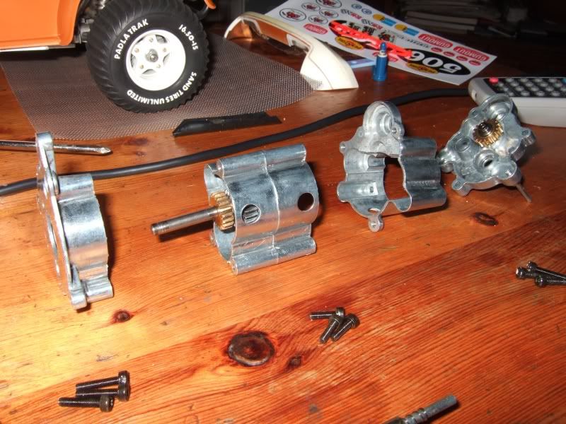

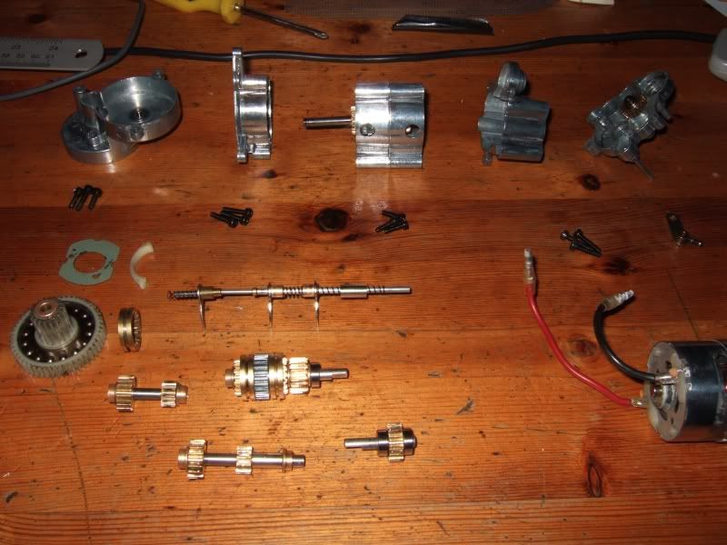

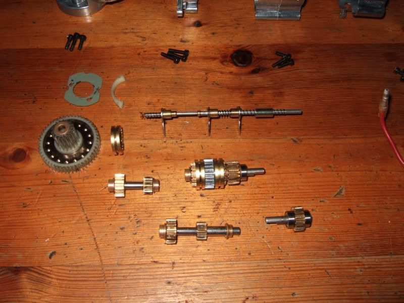

Here's some pictures I took while disassembling:

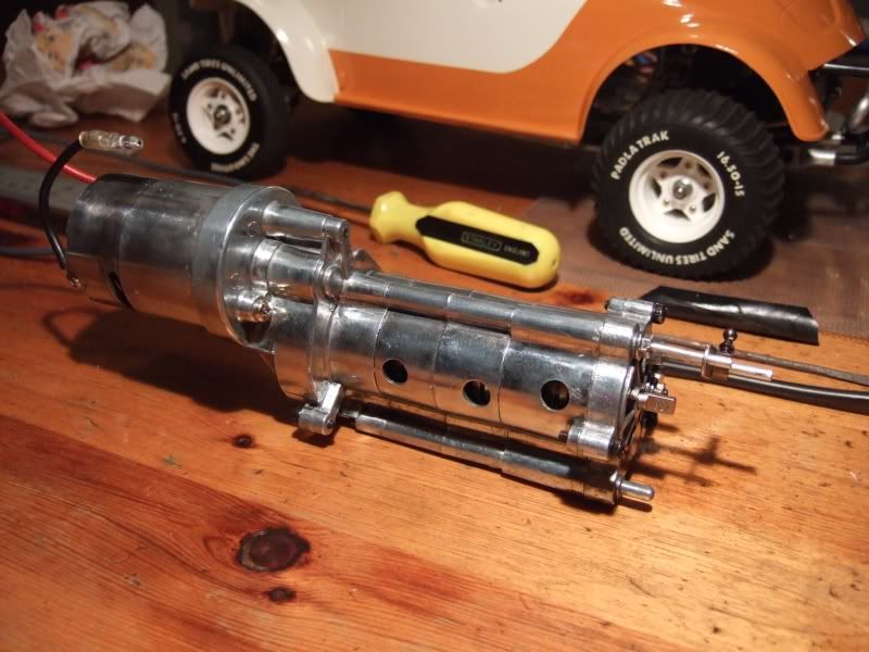

Rebuilt:
Probably worth adding some ball bearings in there too. I added ball bearings in places where I didn't need to use shims to replace the odd shaped bushings.
Wow, that's one shiny gearbox. Looks lovely :-)
It looks very similar to the Tractor Truck gearboxes. It's great to have some reference pictures, so I know what to expect.
