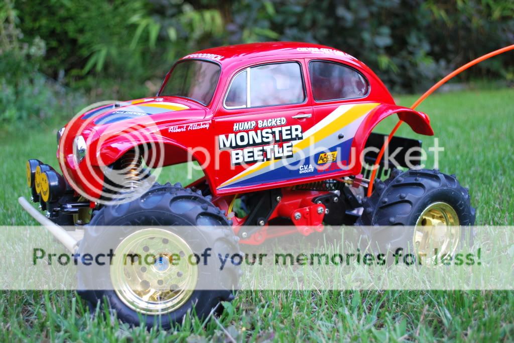

Sounds like the place to show MB resto pics so here's mine...
this is an endurance project that has lasted about 18 mths... body has been stripped twice because I was unhappy with the result, thanks Shodog for all the continuous advice if you read this (hope things are turning out ok for you now). I can now say I am satisfied with the mirror finish (LOTS of elbow grease for that one) and Albert is running happier than ever.
Features a bunch of non-stock parts
- Fiberglass front shock tower (CRP???)
- AE shocks + Losi springs
- Full thorp tranny (yay)
- CRP rear shock mounts
- Bearings - period ones :)
- Dynamite period tires
- CRP bumper
- Proper KP Servo saver (with a mighty JR 8411 servo <_< )
- Custom steering rods
and then ome personal adaptations, like the driver mount, some smartly placed bits of plastic here and there and so on so forth.
Still missing license plates and wipers - the latters I glued on yesterday, the former will happen very soon :mellow:
enjoy the pics,
Paul
and a group shot :unsure:
very nice.
18 months,wow.
**** now you got me thinking of making a hopped up one from the spares.
once you start with these mb's,it never ends.
are your front tyres on the wrong way round?
any more pics with the body off?
Lonestar that is looking sweet, what colour did you spray the shell, i've been looking for the original TS 8(Italian red) but it's all been recalled :lol:
That shiny shell is the nuts. Not sure I could ever have something like that though, I'd have it flipped and scratched to bits in no time.
Bit worried mine's gonna be a pale effort in comparison, good job it's gonna be a runner!
That's a beautiful job on the shell Paul :lol:
As for the CRP bumper, I have several of them & I found them to be weak & break easily B) , cutting the side spars out will only make it worse. If it will spend it's life on the shelf, or just gently trundling round that's fine, but don't expect it to offer any significant protection. The original Tamiya part is much better in that respect.

thanks for the kind words.
The wetlook finish is pretty cool once you get it right indeed... very rewarding. The 18mths took that long because I always have 20 different projects in parallel too :D ! That is TS-8 indeed, I know there are some issues in the UK about sourcing tamiya sprays, but around here it's isn't any more painful than usual (which it is, btw... you just have to order them quite a bit in advance).
The front tires are in the right direction;you get more front bite off-throttle that way, similarly you get more rear on-throttle bite with the rears like that... it's all theory of course, as in the end the MB handles pretty poorly no matter what!
BlacqueJacque - This bumper has been there for ages... and it draws questions, which is cool ;) I don't run that baby very often anyway, and when I do I try not to hit stuff. I ran it saturday btw, and rolled it twice, but then again, it's a runner, so it's meant to "live" !!! No guts, no glory, as an old motto used to say ;)
Paul
