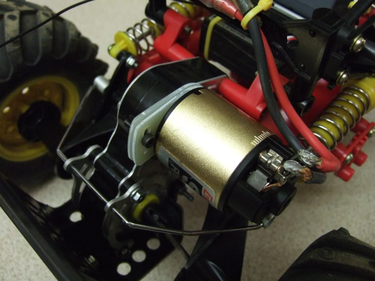

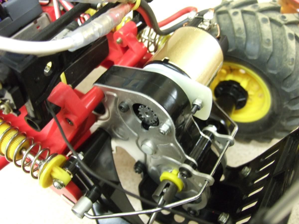

mymonsterbeetleisbroken 16 Posted December 29, 2008 Big thanks to ben for this addition to my MB: Great little piece of kit. CRP stuff was so well made, precision! The technigold has an odd, wide can, so I had to file a little area of the right suspension arm to avoid contact. I can imagine this was common practice back in the day! I've fitted a 13 tooth pinion. 3 teeth larger than stock, but hopefully the technigolds torque will over come that. A small pinion certainly wouldn't fit, as there would be too much interference between motor and suspension. Top speed will be higher now though, so I'm looking forward to the test run tomorrow! I'm going to cover the hole with tape just like CRP suggest. The CRP hardware isn't long enough to allow the stock pinion cover to fit - though if you did fit it you wouldn't be able to set the pinion mesh properly. My modded monster beetle will always be an ongoing restoration. It started life as a standard MB i bought locally off of ebay. I bought a few CRP parts whilst I was restoring it, with the intention of making a durable runner. I guess it was that "durable" idea that's lead to the bug as it is today! So far I've fitted the following: Ball Bearings CRP - Rear suspension mounts, rear suspension supports and bushing. Chassis, body mount bracing Differential supports Steering knuckles and servo saver CRA rear anti roll bars (modern version of vintage parts) Thorp Dirt burner ball diff, dog bone drive shafts and counter gear Graupner RX 540 VZ (technigold with a different sticker!) I've done a few other home done mods, swapping screws for nuts and bolts and cutting and shutting of the rear body mounts. More piccys in my showroom! Keep up the great work on the MB's guys! Share this post Link to post Share on other sites

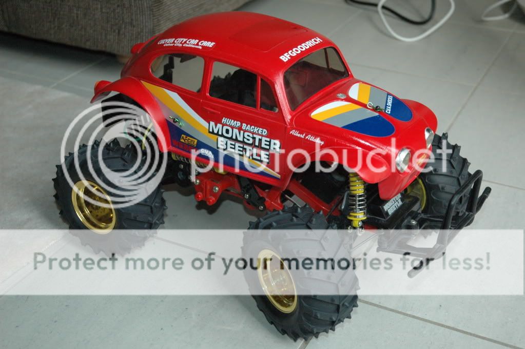

bfst24 2 Posted January 1, 2009 no probs mate,good dealing with you. heres my chrome chassis update. http://www.tamiyaclub.com/showroom_model.a...68&id=10679 also completed my gold chassis one,just need to finish the body now. http://www.tamiyaclub.com/showroom_model.a...0&sid=10679 Share this post Link to post Share on other sites
bfst24 2 Posted January 2, 2009 hi mateheres a link to a ebay auction with the blackfoot spots.i bought a set as i thought they were the same too,from looking at the manuals. http://cgi.ebay.co.uk/Tamiya-58110-Super-B...A1%7C240%3A1318 for anyone who wants to know,i have built up a spots bar using blackfoot spots.they are not exactly the same as mb ones,slight difference on the front detail,but are the same size and do fit. here a few pics in my showroom http://www.tamiyaclub.com/showroom_model.a...6&sid=10679 Share this post Link to post Share on other sites
bfst24 2 Posted January 7, 2009 for anyone who wants to know,i have built up a spots bar using blackfoot spots.they are not exactly the same as mb ones,slight difference on the front detail,but are the same size and do fit.here a few pics in my showroom http://www.tamiyaclub.com/showroom_model.a...6&sid=10679 now completed the body on my gold chassis mb. http://www.tamiyaclub.com/showroom_model.a...91&id=10679 got the decals from a guy on ebay http://cgi.ebay.co.uk/Tamiya-Sand-Scorcher...oQQcmdZViewItem these are real vinyl pre cut.not paper backed vinyl. they are not exactly the same as originals but i didnt pay originals price. im gonna buy a few more sets. Share this post Link to post Share on other sites

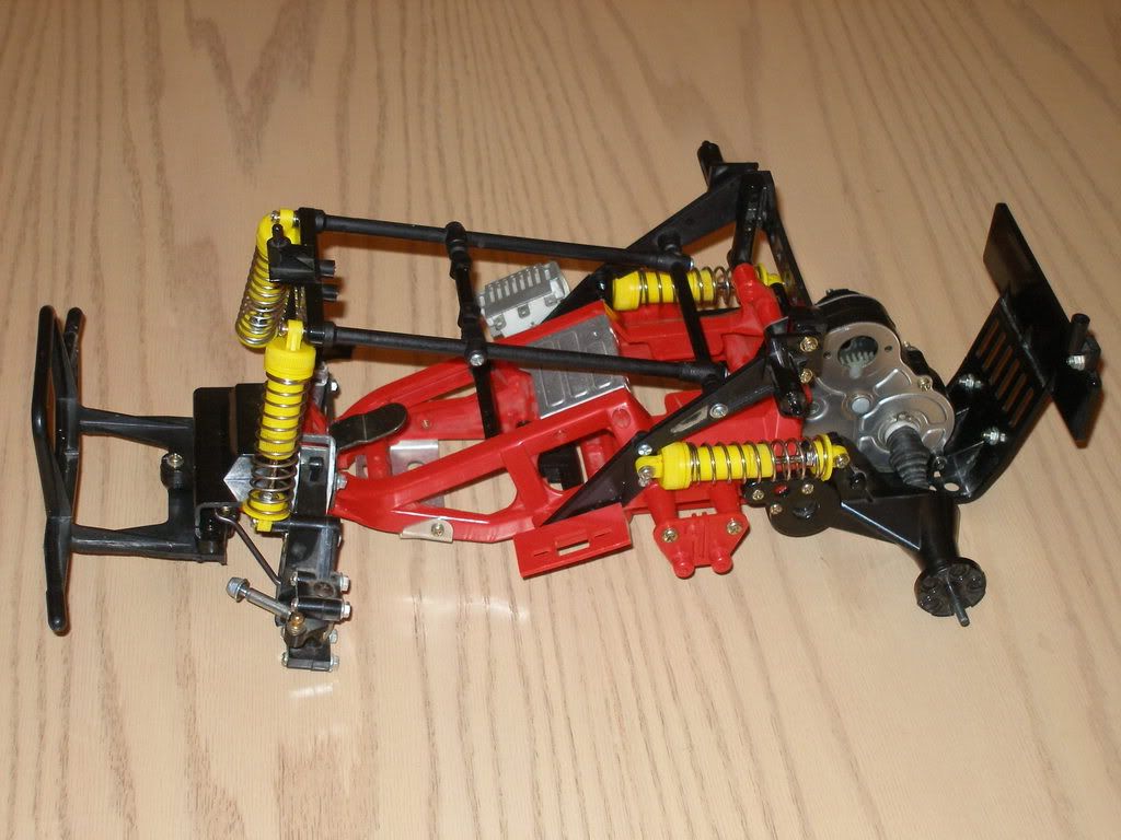

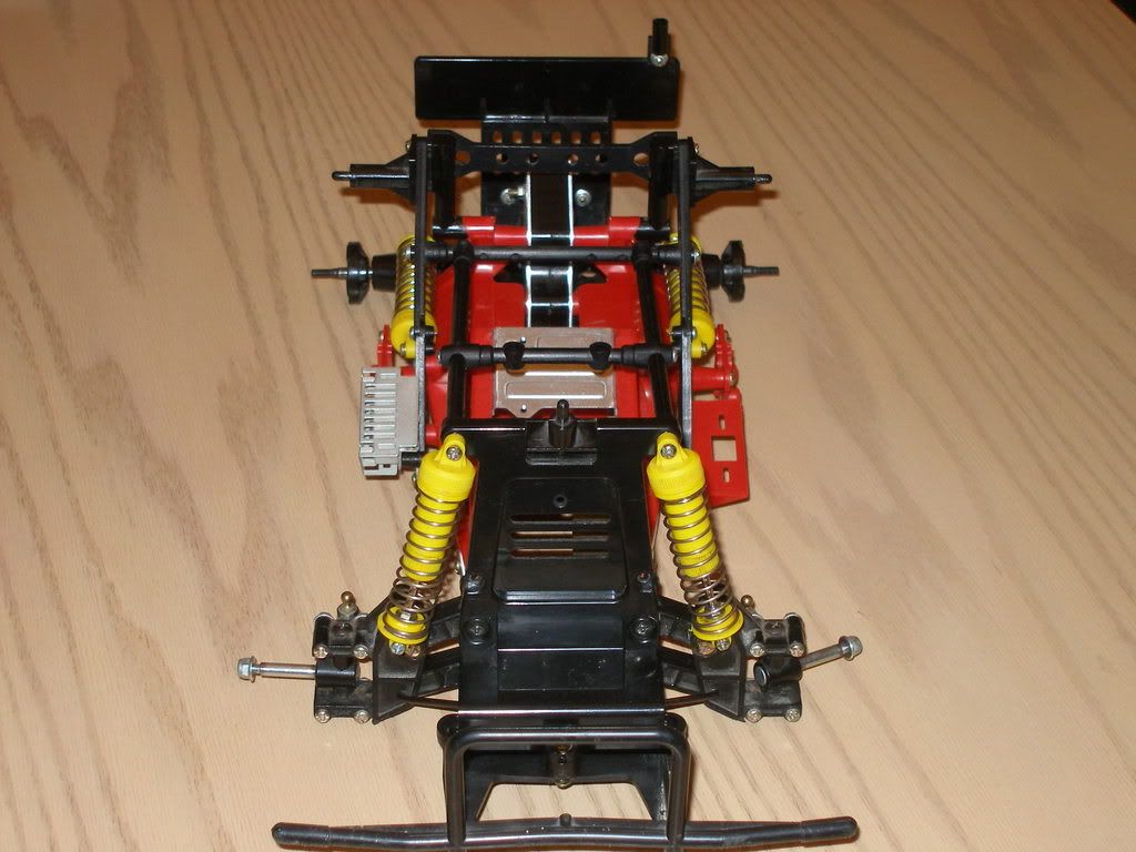

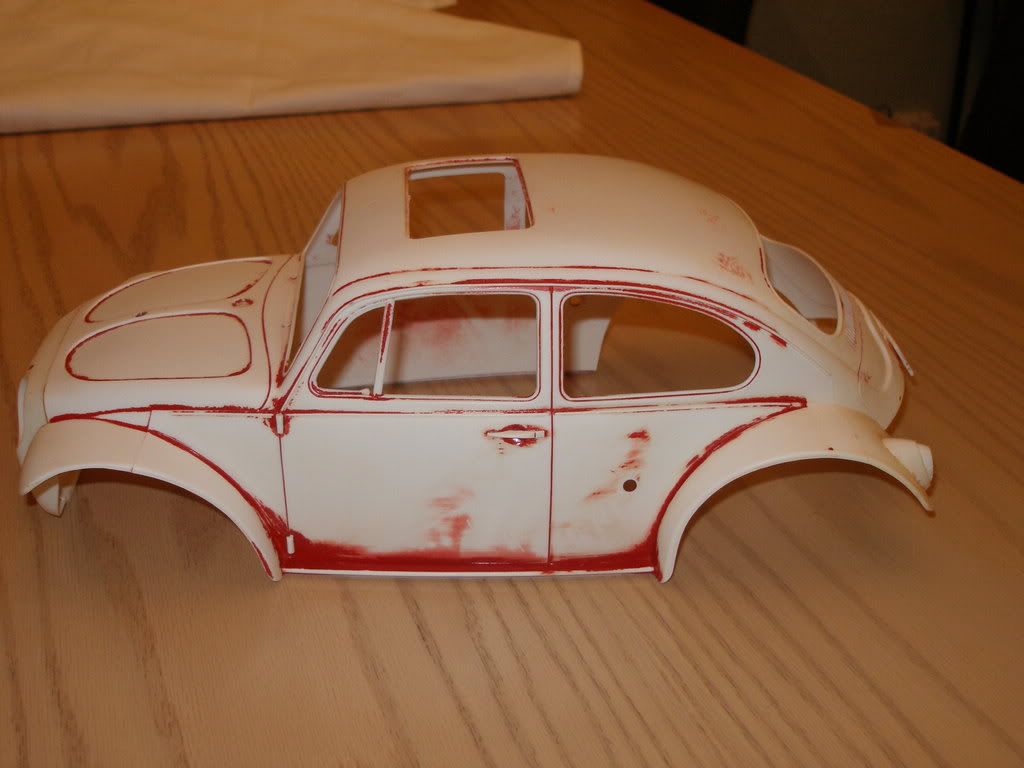

Leethal Driver 86 Posted February 5, 2009 Right, seeing as how this string's been quiet for a while thought I'd drop in some photos. Finally got round to stripping the last of the paint off with the dot4. Hasn't turned out too bad. Realised one of the uprights is slightly bent but not a big deal. Needs a good rub down with some glass paper next. Have built chassis back up with the CRP chassis brace Mrs Driver bought me for christmas (bless her, forgot to delete the feedback request from ebay so I knew it was coming ) and new rear arms but have Frog UJ's on order and have received the Frog bevel gears and new diff bag so I can rebuild the gearbox so it's all coming apart again! Chassis brace rocks by the way, good bit of kit and a worthy upgrade. Planning on a couple more mods as well but as ever funds need to be found first. Already got Mtronics 20T Viper esc and going to put a Super Stock BZ in it (I do like these motors). Will be spraying wheels as one of the fronts had a big crack round the rim so have replaced it with a vanilla blackfoot wheel. They're a bit scuffed anyway so a good rub down needed. Toying with paint scheme, fancy something different but note sure what. Share this post Link to post Share on other sites
