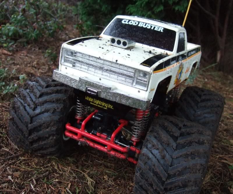

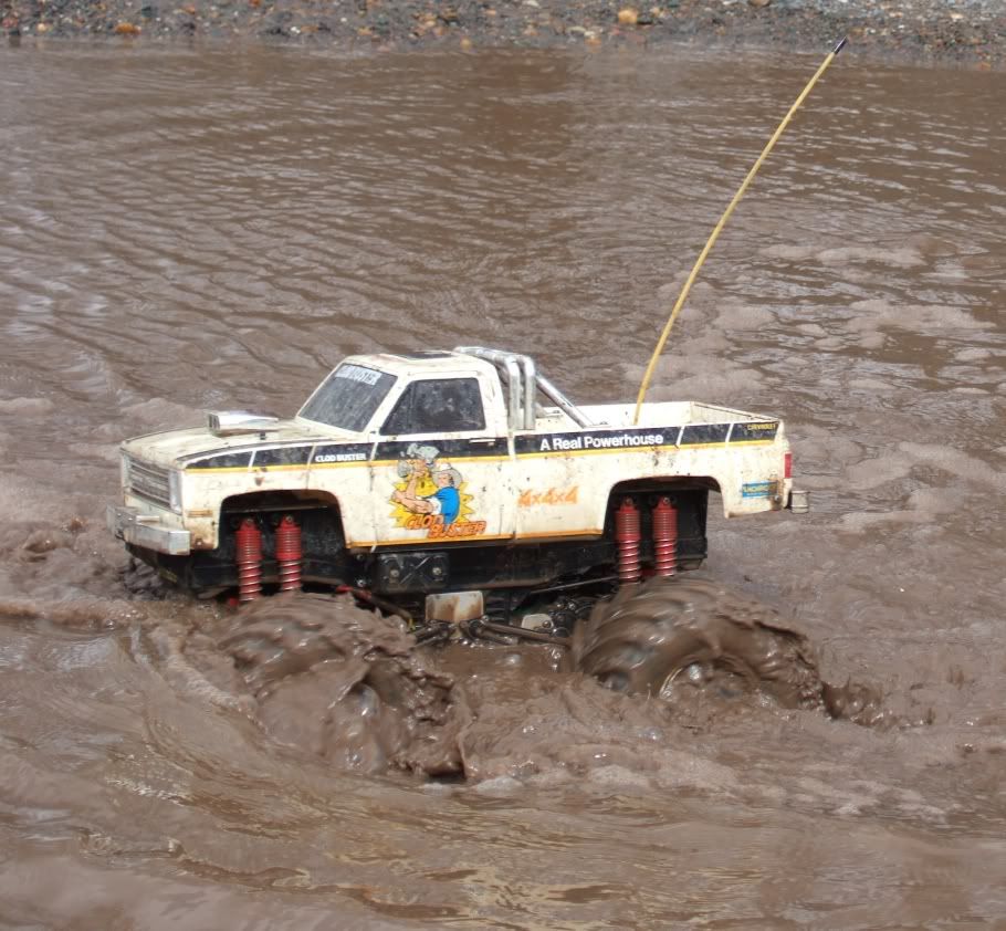

This is my clod
Originally built by my uncle in 1987 (i would have been 1 year old then!) and owned by my cousin. I've owned it for the past 10 years and would never part with it. I've got modern trucks that drive better, but like the others have said there is something special about the clod that gives it a presence that modern trucks don't have.
Whenever I take trucks to shows to demo to the public, the clod always attracts attention. Crushing cars and popping wheelies is what it's all about - and people are still impressed with the rear wheel steering - even today!

Nice video! The clod seem to be the best climber there. Is yours stock there?
Thanks!
There not bad climbers, but are surprisingly easy to get stuck unless you've got locked differentials.
The only mods on my old clod are ball bearings, ESC, aluminium chassis braces and anti rotation brackets (you can see them in water picture, made them myself!)
I'm going to add more powerful motors soon, as the stock 540's are a little slow, though the truck is nice and controllable with them.

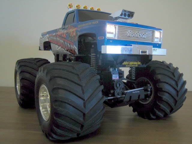

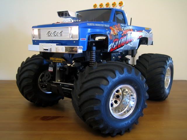

Here is mine, almost stock. Just modified the stock chassis for more better articulation. 4 - oil shocks. Front mounted steering and a junfac skidplate and rear lockout. Aside from the usual ball bearings, Novak SR ESC and mod motors. I also added Tamiya lights for the headlights.

hi do you know when the chrome edition is gonna be out or do you have any more info on it.
p.s nice clod.

Hi steve r.
The mods are fairly easy. I'll list the steps with pics here.
First, I would like to apologize to 28yokid for swamping his thread. I hope this will just give some tips to new owners on how to slightly modify their stock clods.
It is easier if you have a clod ready in front of you. Cause, you will see how much "material" from the stock chassis you must take out with the use of dremel (it is easy if you have some rotary tool). NOTE: The front steering servo holder and linkage, plus the rear steering lock out are aftermarket parts. I bought them from Junfac (ebay). Take out the whole stock steering set-up and shocks. Let the chassis "sit" on the axles and from here, you can make out which parts are touching the chassis. It is obvious that you have to take out the plastic material to free up anything that will hinder the axle movement. Surprisingly, without the stock servo saver, you don't need to take out anything at the rear...just the front. As you can see from the pics, this much is needed to make room for the front axles to move.
With the stock steering out of the way, you can now place everything inside the tub chassis, for a more lower CG.
I tried using 2 oil dampers per side. It is way too stiff, since most of the weight are just on the axles. Having one per side is enough.
I hope this helps.
