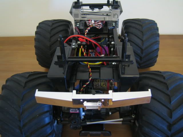

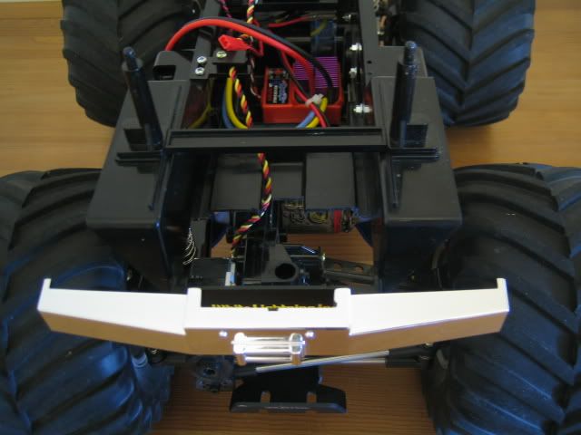

The mods are fairly easy. I'll list the steps with pics here.
First, I would like to apologize to 28yokid for swamping his thread. I hope this will just give some tips to new owners on how to slightly modify their stock clods.

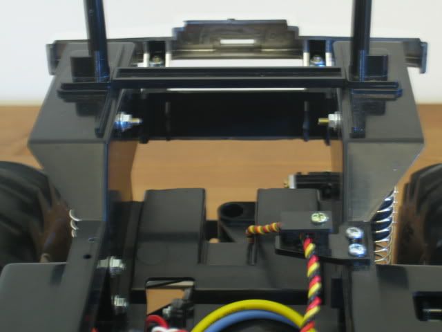

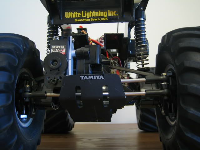

It is easier if you have a clod ready in front of you. Cause, you will see how much "material" from the stock chassis you must take out with the use of dremel (it is easy if you have some rotary tool). NOTE: The front steering servo holder and linkage, plus the rear steering lock out are aftermarket parts. I bought them from Junfac (ebay). Take out the whole stock steering set-up and shocks. Let the chassis "sit" on the axles and from here, you can make out which parts are touching the chassis. It is obvious that you have to take out the plastic material to free up anything that will hinder the axle movement. Surprisingly, without the stock servo saver, you don't need to take out anything at the rear...just the front. As you can see from the pics, this much is needed to make room for the front axles to move.
With the stock steering out of the way, you can now place everything inside the tub chassis, for a more lower CG.
I tried using 2 oil dampers per side. It is way too stiff, since most of the weight are just on the axles. Having one per side is enough.
I hope this helps.
