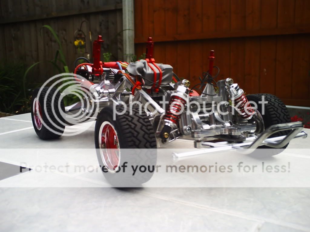

Yeah, it's very impressive, especially how he's fitted upgraded steering rack, belt drive 4WD and IFS and still managed to fit it all under the original bodyshell unmodified over the top. As well as all the nice little touches like the battery holders, and front 2WD wheel hub adapters for 4WD.
I look at the Frog body shell with the bulges on the bonnet, and it just looks like it was meant for IFS, with the shocks transverse under the bulges. Keeps the original look of the Frog, like an F1 car with no dampers in sight.

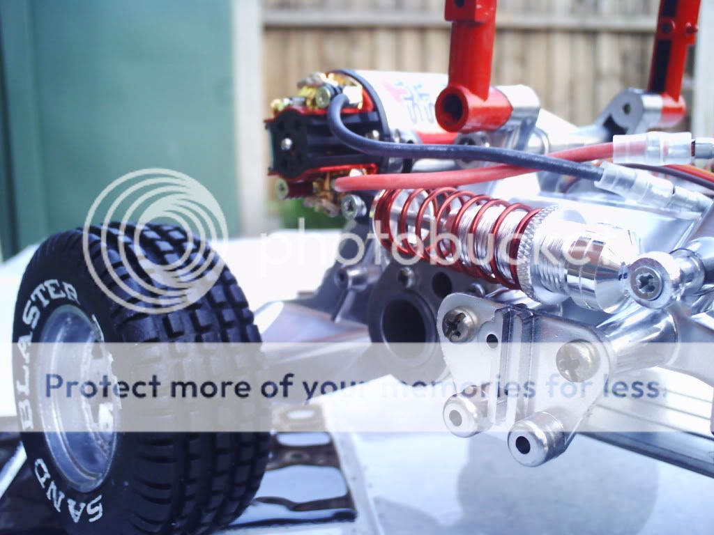

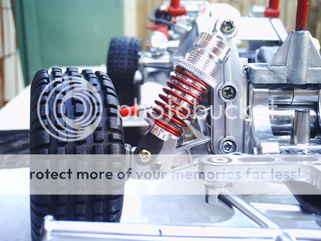

The little YOU-G front dampers work so well. I get full suspensiom throw. I made my own mounting points for these as i didn't get instructions;
Yes they leak but a little thread tape helped alot. Drilled one hole in the solid brass pistons and 30wt oil.
The rear shocks are easy to match. The secret is not too stiff springs. I used CAT 3000 front shocks with blue springs. I have a little droop at ride height and it has heaps of rear end grip.
