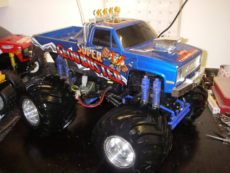

The Super Clod Buster i bought from ebay has arrived. :rolleyes: Seems pretty good and was painted/decaled well. Its got a few chips to paint but i'm not bothered too much as i plan to run it so i'm sure i'll put a few more on it.

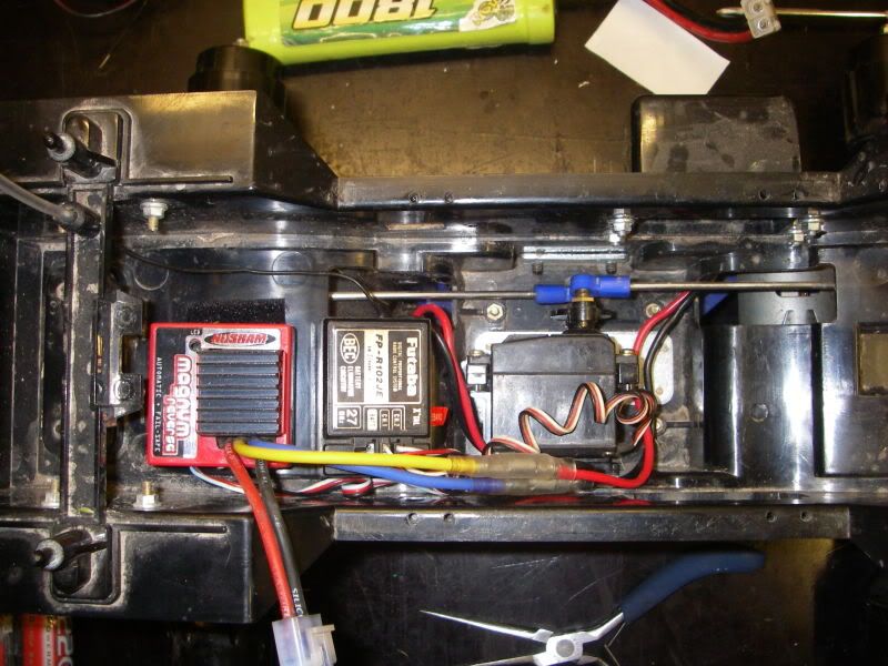

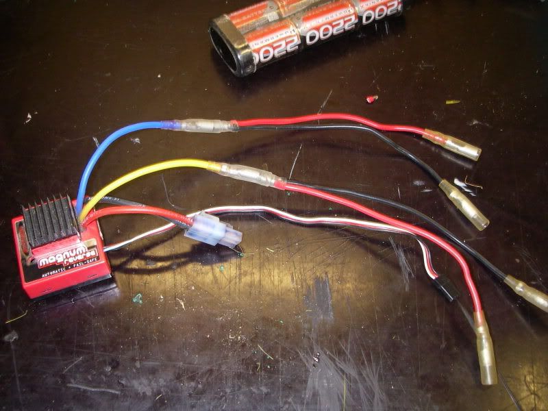

So far i have given it a few runs around the garden, firstly as it came with stock shocks and MSC. I've now swapped to CVA's to remove some of the bounce. I used the stock springs but i don't think these are stiff enough when there are only 4 so i'll try some King Cab rears that i have spare. I've also fitted an ESC. It's quicker that i expected but i'm still going to look at different motors for a little bit more speed. My ESC should handle a pair of 23 turn motors ok, any recommendations?
The steering seems to be more rear wheel steer than 4WS when driving and the wheels won't steer when the truck is stationary. Is this common and can it be adjusted out by playing with the steering arms/servo savers or will i need a stronger steering servo? A Futaba S3003 is currently fitted, any recommendations for a stronger one? Or would i be better going for axle mounted servos?

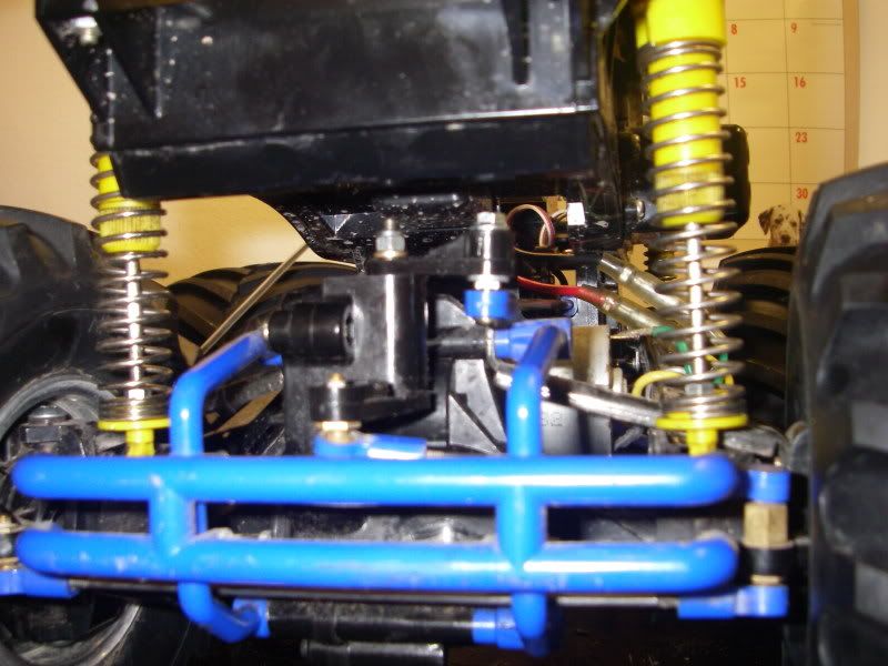

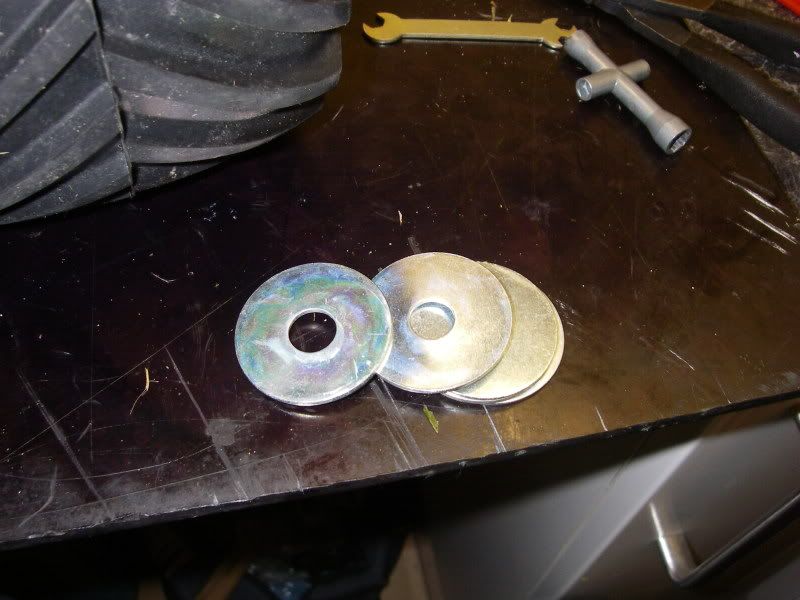

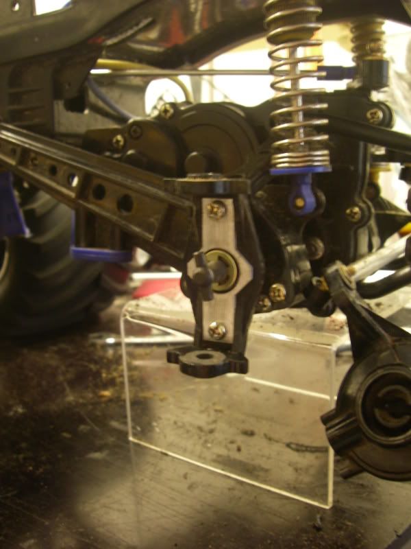

I read on the RCMT forum a cheap and neat way of locking out the rear steering using repair washers. I thought i'd try this way first to see if i liked the way the truck handles with just front steering before considering buying a propper kit.
You need 2 washers 1.5" diameter with a 0.5" diameter hole. Its important to check the thicknesses as they can vary. I found a pair that are 1.7mm and used those. You remove all the original rear steering arms and fit the washers between the upright and steering knuckle to lock it. There is no movement at all with these washers fitted.

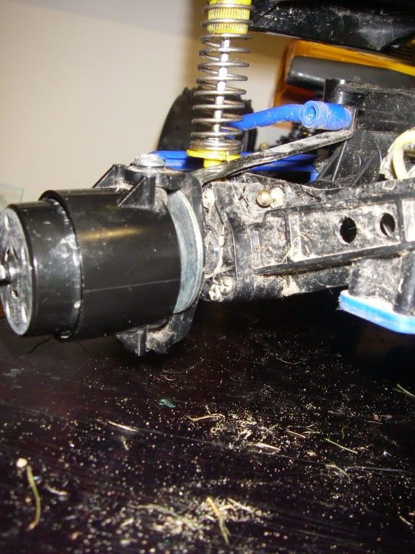

Next up was to look at the front to try to get some more travel out of the suspension to match the extra travel now at the rear. I noticed that the steering arm/servo saver hits the underside of the chassis well before the shocks are near their full travel. The arm from the servo normally mounts to the top of the servo saver and the top point on the servo horn. I re-located the ball connector to the underside of the servo saver arm and the steering arm to the lower point on the servo horn. This allows the front suspension much more travel before the servo saver touches the chassis.

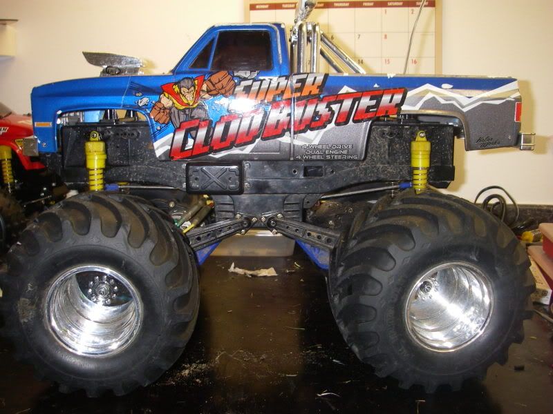

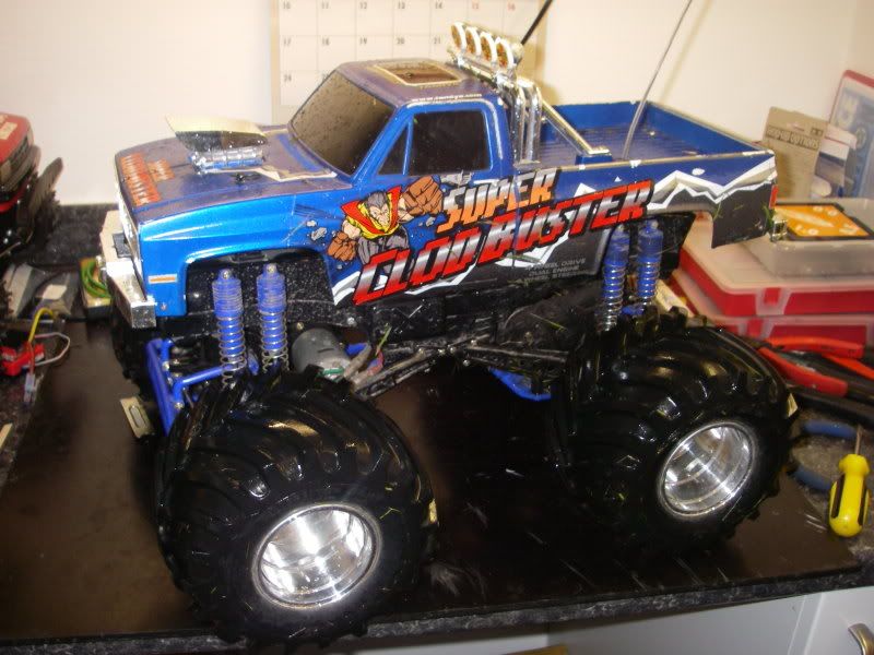

and after a lot more money it now looks like this

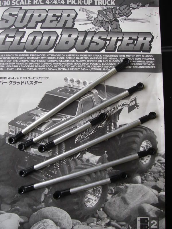

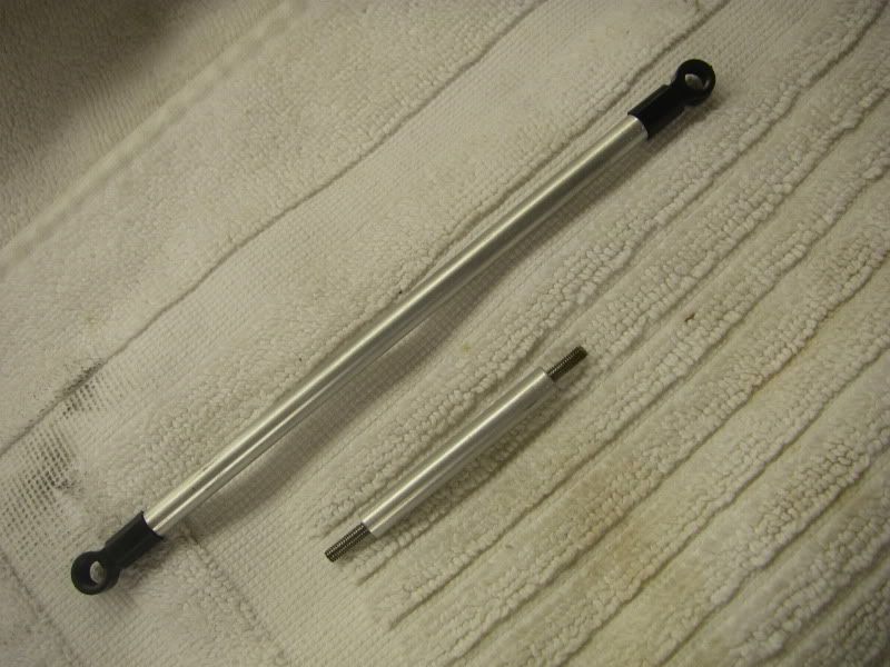

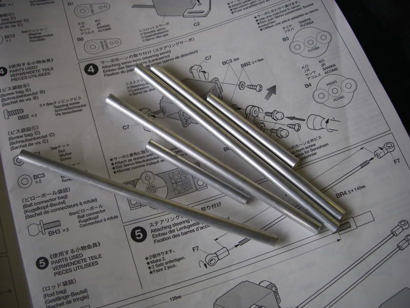

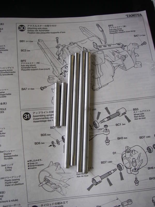

With the rear steering locked i couldn't get enough lock to use the truck in my rear garden so went back to the 4WS. The standard steering rods flex quite easily and i bent one. The Black F parts from the Chrome edition arrived eariler in the week giving me the ballends so i decided to make so aluminium steering rods:

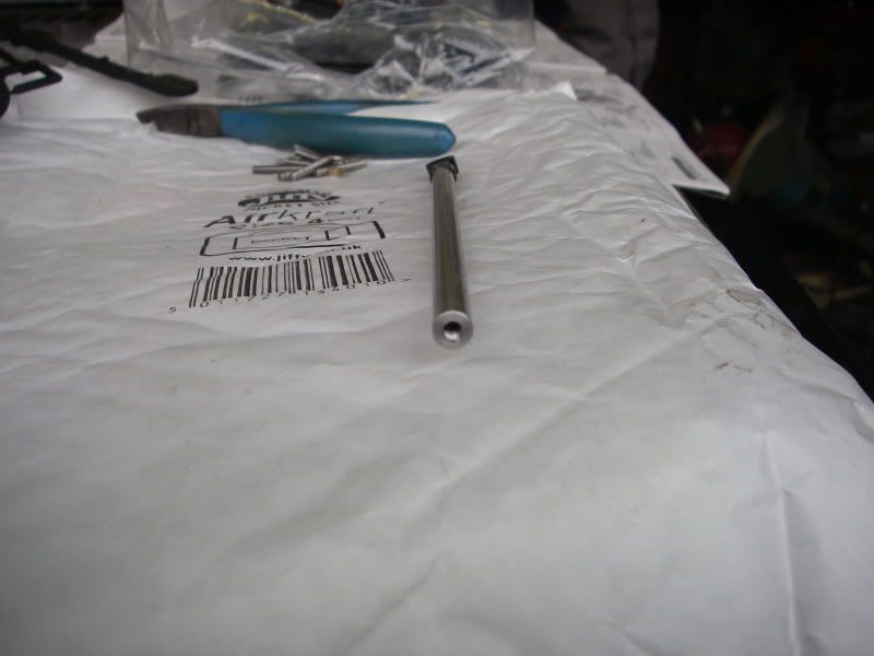

Aluminium rod roughly cut to size:

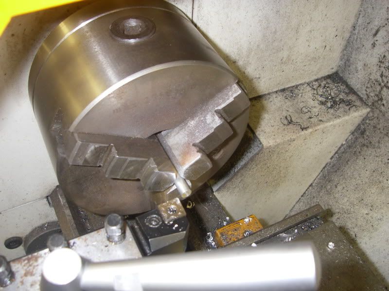

Turned in my lathe:
6 steering rods the length specified in the manual:
Drill and 3mm tap the ends:
Complete ready to fit:
I'm about half way through making some 4 Bar links, hopefully get those done soon to increase the suspension travel.

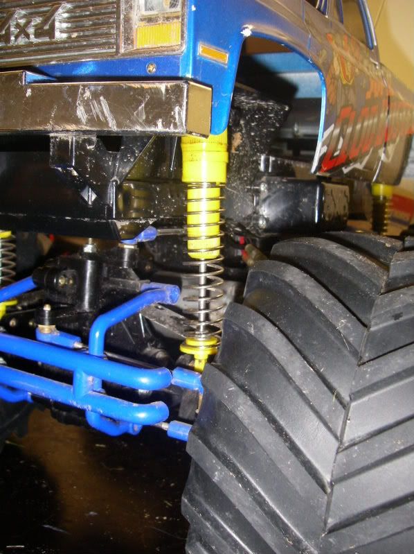

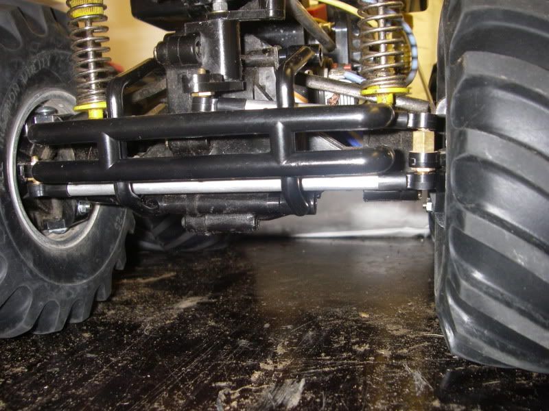

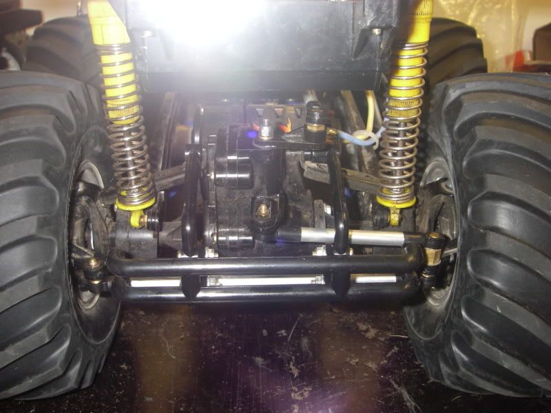

I fitted some Crawford axle stiffeners and my alu steering arms today along with the Chrome Edition black bumpers.
4 bar links still to finish
