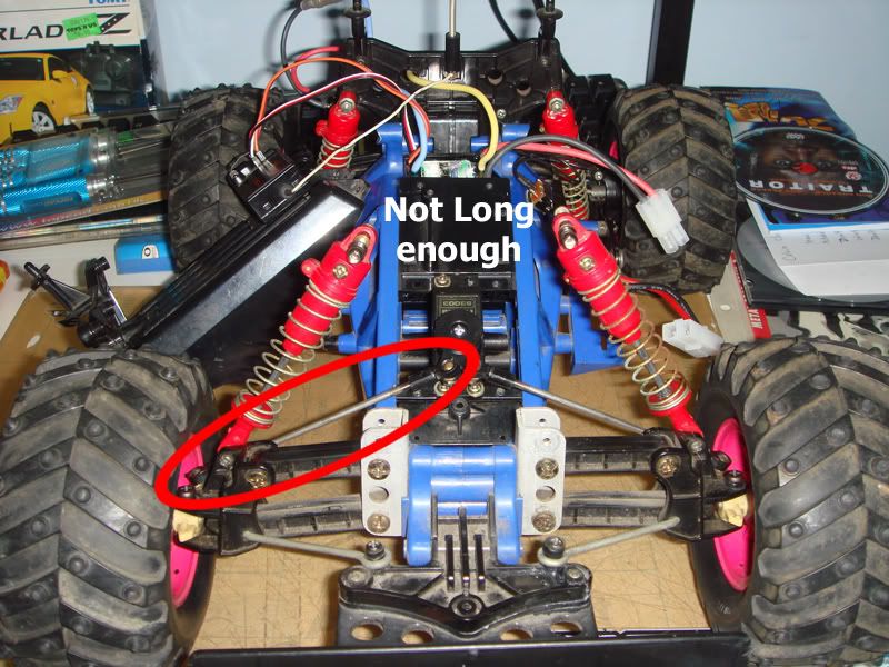

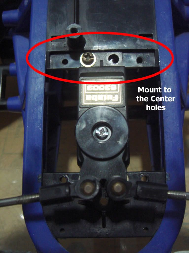

Hi there guys
I have modded my Bush Devil servo as you told me to by turning it around,now is much closer , but there is still one problem, the tierods shaft is not long enough. I can see that the sample that you gave is much lower (the servo mounting) mine is still abit higher because of the exisiting plate to hold the old servo saver. I could not shift it lower already. If you are not sure wat i meant i can take a photo and show, but what i want to know is do Tamiya sell longer tierods shaft?
I even try to shift my servo to the middle as im running one servo only, im using a non mechanical ESC. Still its not long enough, thus making the car having alot of toe-out :)

Here is my photos to show wat i meant!
This thing is in the way to lower the servo...
This is wat i meant where is not long enough.
This is the servo mounted in the middle as the shaft are not long enough.
So do Tamiya sell longer tierods?

Hello there
I have finally solve my problem. Thanks for the M3 threaded rod tip though. I bought a oversize kysoho servo saver and mount it as i did before in the center and voila, it did the trick. i need to shorten the
rods though now :( lol. Neway its a blast now.....
