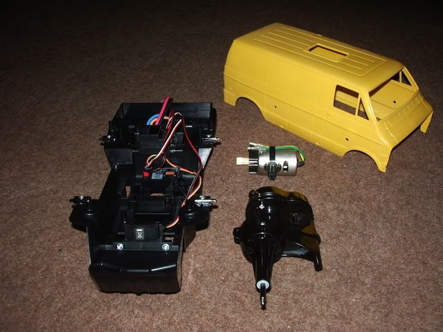

Another update and this time it's more positive! I took the advice from some of the previous posters and got the shell painted (well, sprayed but you know what I mean). It came out well with no running so I think taking my time paid off.
Assembly has continued with the ESC and receiver being attached to the chassis. The gearbox has been assembled too, although I did find the grease didn't go far! I also managed to get the pinion attached to the motor.

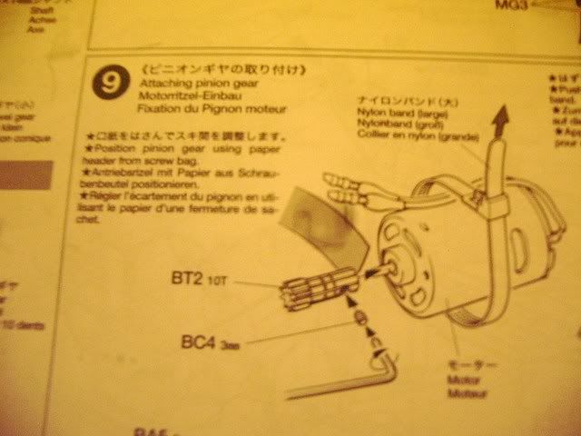

One thing that did seem weird was that I was supposed to position the pinion using the piece of paper. I'm not sure why, so I didn't bother. I managed to line up the 'headless screw' to the flat part when I attached it so I think it will be fine. If anyone can tell me if it was important/purpose of using the paper or card I'd be grateful. I've got a photo of what I'm on about below. That probably explains it better.
Also, I'm quite pleased that I seem to have speeded up a little now I've figured out that two of my parts bags had been mixed up with each other and had been labelled as such. Figuring out what's what seems to be the key to completing the project more easily. Starting to enjoy it!
Finally, pics:
Really? I've moved it a little closer just in case again then (about the thickness of a couple of bits of paper). There does seem to be slight movement though in the prong from the motor that the pinion is attached to which I guess could make the pinion just touch the motor or move further away. Ho hum, I'll just have to see how it pans out.
Yeah, it does. I'll keep it as is for now I think which is probably about the same width away as a single thickness of the card.
edit: I've checked and the card just fits. In fact the 'card' is just paper really so I'm confident that I've managed to do it correctly. Fingers crossed... :lol:

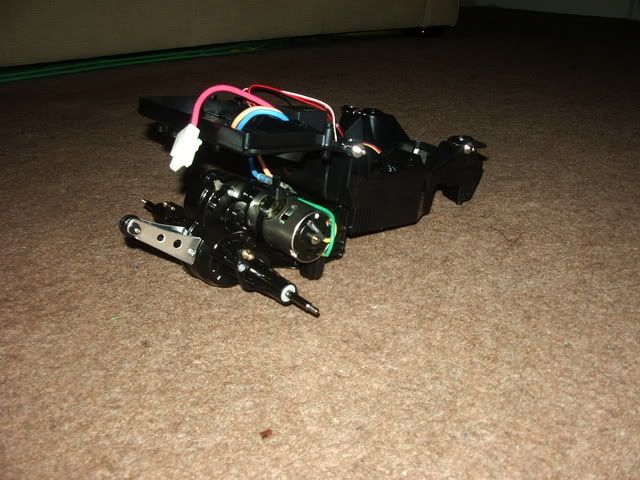

Next update. Haven't done too much tonight - only the one page. It's starting to take shape now. I've got the gearbox and motor pretty much mounted and hooked up. I really need to see if the motor works and is linked up to the gearbox correctly. Guess I'll have to try and sort out the ESC to do that; I originally turned it on (and the transmitter) without checking out how to do it properly so I guess I'll have a proper look at how to do it at a later date.
Also, it states that once the motor cables are attached to cable tie them securely. Any ideas where I should do this? At the moment only the green and yellow ones (from the motor) are cable tied to the motor. Photo's are below as per usual.
