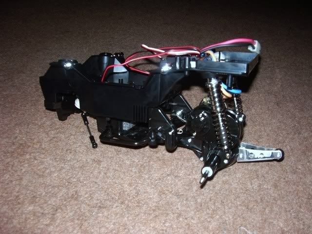

Anyway I managed to get the rear suspension attached, the battery tray and the front steering arms. Cheers for all the help and advice so far. I think it's coming along nicely.
Update pic for tonight:

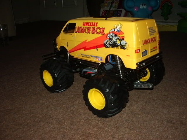

Well it's finished! Last night I got everything sorted (chassis, front suspension etc) and today I got the body detailed and attached. Took it out for a run today which was great fun. Couple of (very) minor issues. First up the car pulls slightly off to the side although I've adjusted the steering arms as well as I can. I've adjusted the transmitter set by moving the bias slightly to one side (only a couple of notches) and this seems to have solved it. In fact I think that it may have been the fact that there is a bit of slack on where the steering arm attaches on the ball joint nearest to the wheel. I'm guessing that this kind of thing is quite normal?
Finally, the ball joint and screw that attach to the steering servo seemed to be working slightly loose so I've added a little glue (this only keeps them together and doesn't restrict any 'moving' parts).
Really enjoyed using it! Can't wait to get it out again tomorrow. My 3 year old son thought it was the best thing since sliced bread.

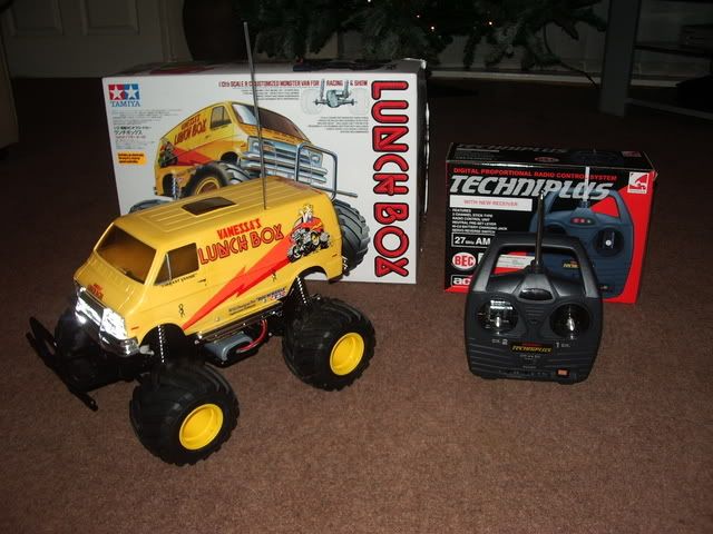

Final pic:
Overall I've really enjoyed building it and despite a couple of minor issues and worries it went pretty smoothly. I'd certainly feel more confident next time. Looking forward to getting my next buggy.

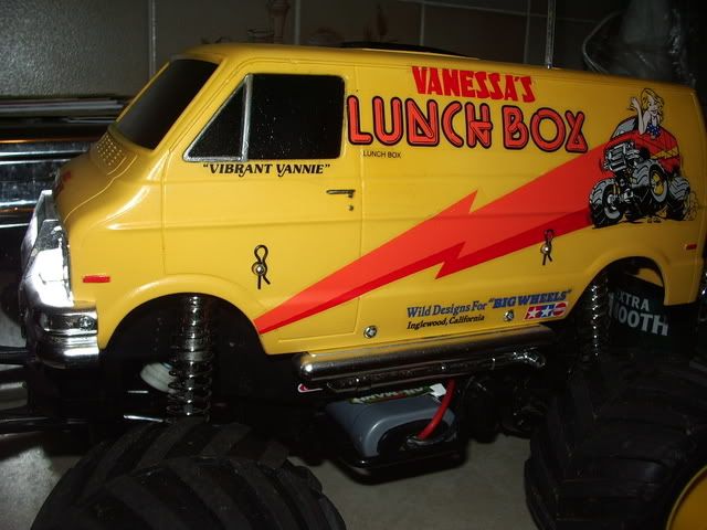

OK, quick update. I've used the Lunchbox everyday at least once and it's had i'ts fair share of crashes/scrapes due to me learning to drive it and the large amount of concrete terrain where I've driven it. Looks like this now:
Still looks fine unless you begin to get a bit closer.
First up the fiddly rear axle springs/stabilisers snapped, so until I do the 3rd shock mod I used some rubber tubing left from the original suspension. Already this has helped stabilise the handling! Pic below. The top arrow shows the tube and the bottom one shows the location of where the other one is (although not visible). Not totally clear I know.
One of the panels got scraped but has been touched up and with the little help of a small 'Lunchbox' sticker you can't tell. However, whilst doing that repair I got some paint on the already scraped clear window. I painted these black but they look slightly crazed although you can't really tell until you are really close. the window frame on both sides has been slightly knocked too.
Also, the rear bumber has been scraped and lost some chrome but nothing major.

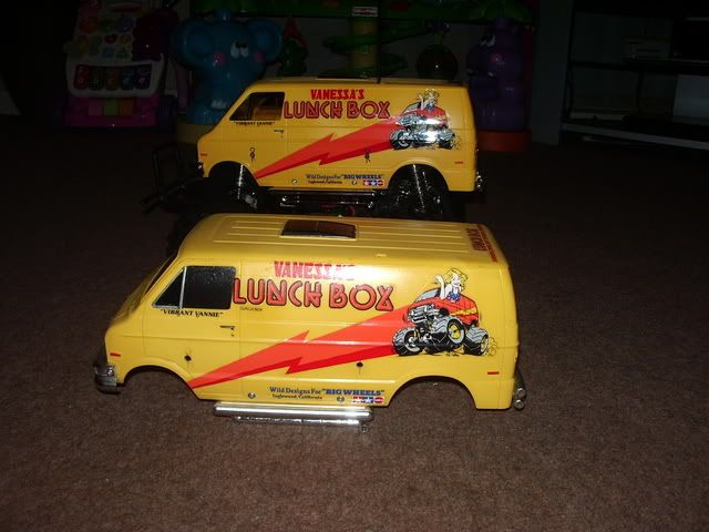

Another (minor) update. I was fed up with scratching and damaging my origignal shell and still wanted it 'new' looking, so I've decided to get a new shell solely for display purposes. Got it all painted and detailed today.
The original shell I will of course use for bashing. Unless it breaks completelyr I doubt the other one will get used (in which case I'll buy another spare).
Also, I still haven't got round to using a '3rd shock' as i'm quite happy with the rubber inserts I've used. Just need to decide which buggy to get next.
Pics
1. New shiny shell
2. New shiny shell (again)
3, New with old. (old one can also be seen in previous posts)
