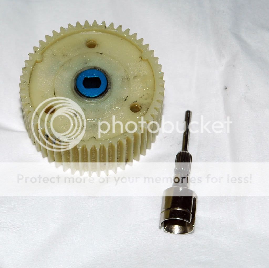

As part of my Wild dagger resto I have decided to lock the diffs to make it an off road monster! I bought two diff lock posi things off ebay which you put into the diff gear to replace the 3 small metal cogs and the 2 larger outer ones.
The part fits fine, but my problem is that the hole is a different shape to the cups which should slot in!
More oblong than round. Can anyone suggest some new drive cups that will fit????

The parts you want to make that work are Tamiya #53790 Cup Joint for Universal Shaft for TT-01/DF-02. The standard dog bones will slot right in.
Justin.

Thanks Justin!
OK, I fitted the new shaft drive things. So both diffs are locked! I ran it on carpet and one of the dog bones snapped! Must have been the combo of superglued tyres and 14.4v twin motors :lol:
Ordered some new reinforced ones off the bay, and am looking fwd to checking out it's new off road powers!
