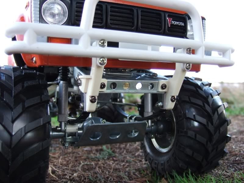

I bought a set of proline mashers for mine:
They are a perfect fit. The thing you have to be careful of is the thickness of bead in the inner edge of the tyre. Some tyres are too thick for bruiser wheels to close up over them.

those flat irons look like they don't have a higher profile than the stock tyres, yet the specs say the flat irons are 140mm, and I believe stock bruiser tires are 127mm? I have Austar 3021 fitted and the profile is way too high for my liking, would prefer these, but prolines website and your photo contradict each other in height, atleast in eyeballing anyway.
