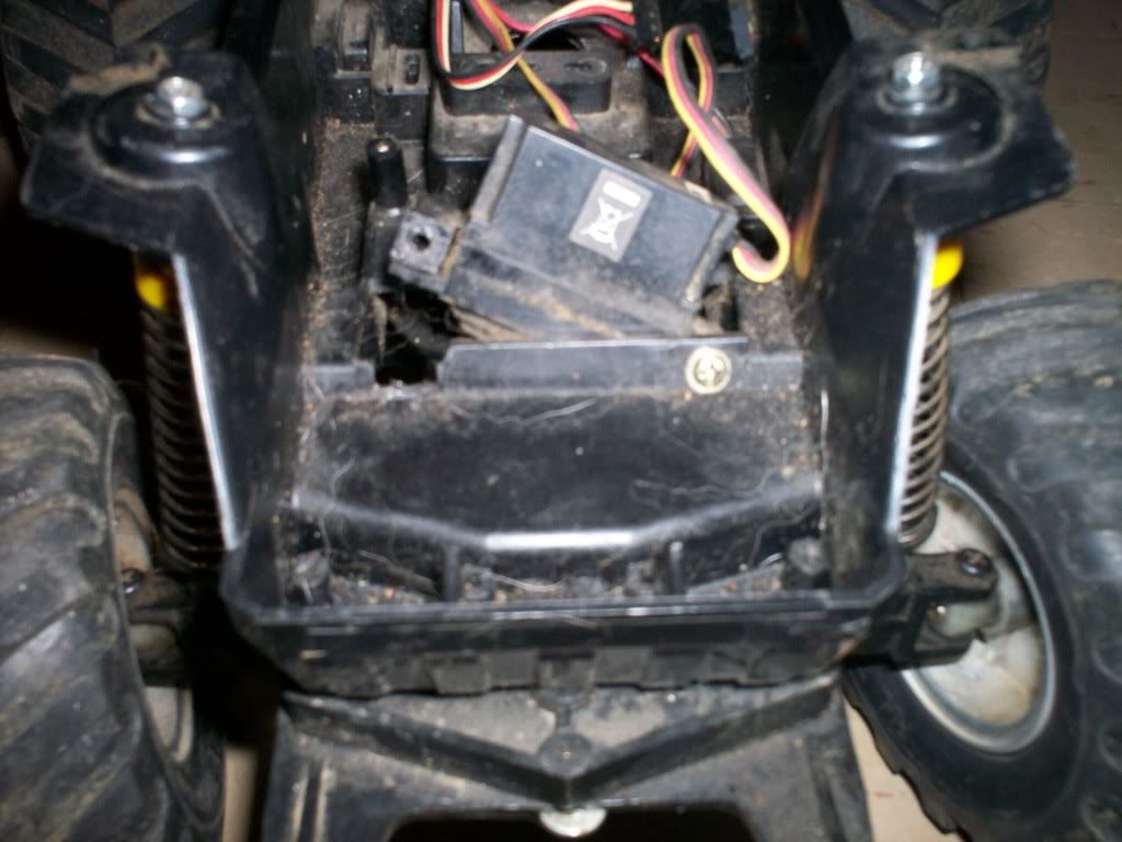

Of course I broke all the body mounts!, have been running it topless ever since!, recently I fitted an 18T ansmann clash motor, still with the standard tamiya speed control(ESC), during a run, I flipped it over and broke the chassis, where the steering servo mounts
I did try to fix it,
but it won't hold so I had to order a new chassis,

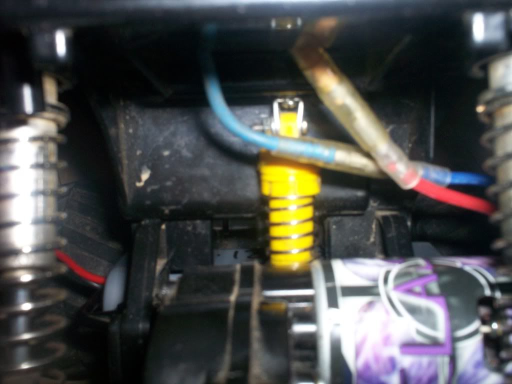

As you can see I have fitting the 3rd shock using a short shock from a falcon!
I had also broken my front bottom shock mount, so decided to fit the falcon shocks to the rear but they turned out to be too long, so I changed the damper rod for a shorter Blitzer beetle one(not ideal, but it did shorten it)

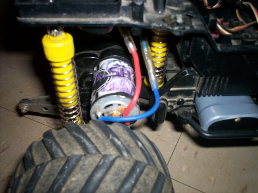

I was then left with the problem that when the 3rd shock is in full compression, the motor fouls the rear shock, I have fixed that problem by mounting the rear shocks further back,.
And the new clearance. with the rear shock and motor

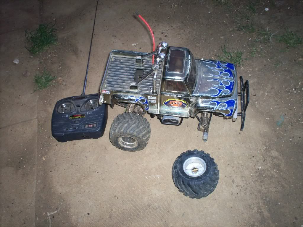

The chassis is fixed now(well new), I just took it out a minute ago and the wheel broke again and also a body mount, time for two new front wheels now!.
Maybe I need a bigger bumper, or a better driver ;) , the gardens not really big enough to run it but I do try.

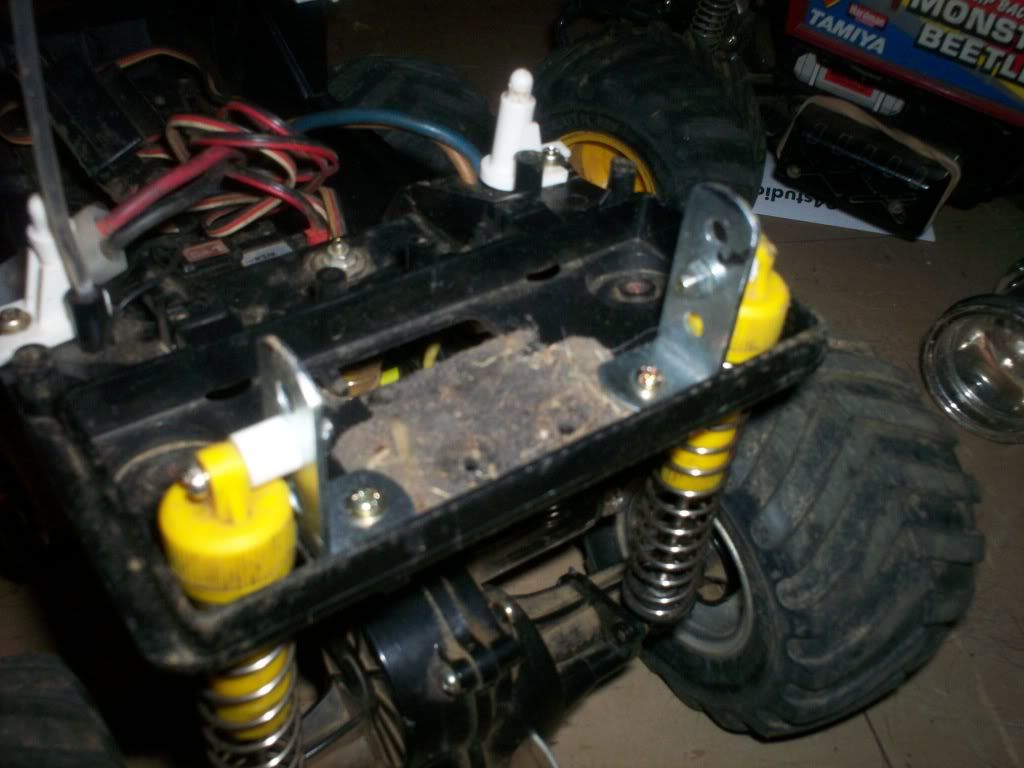

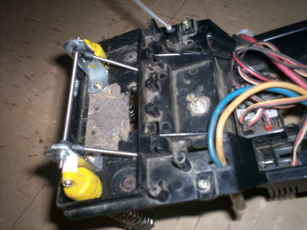

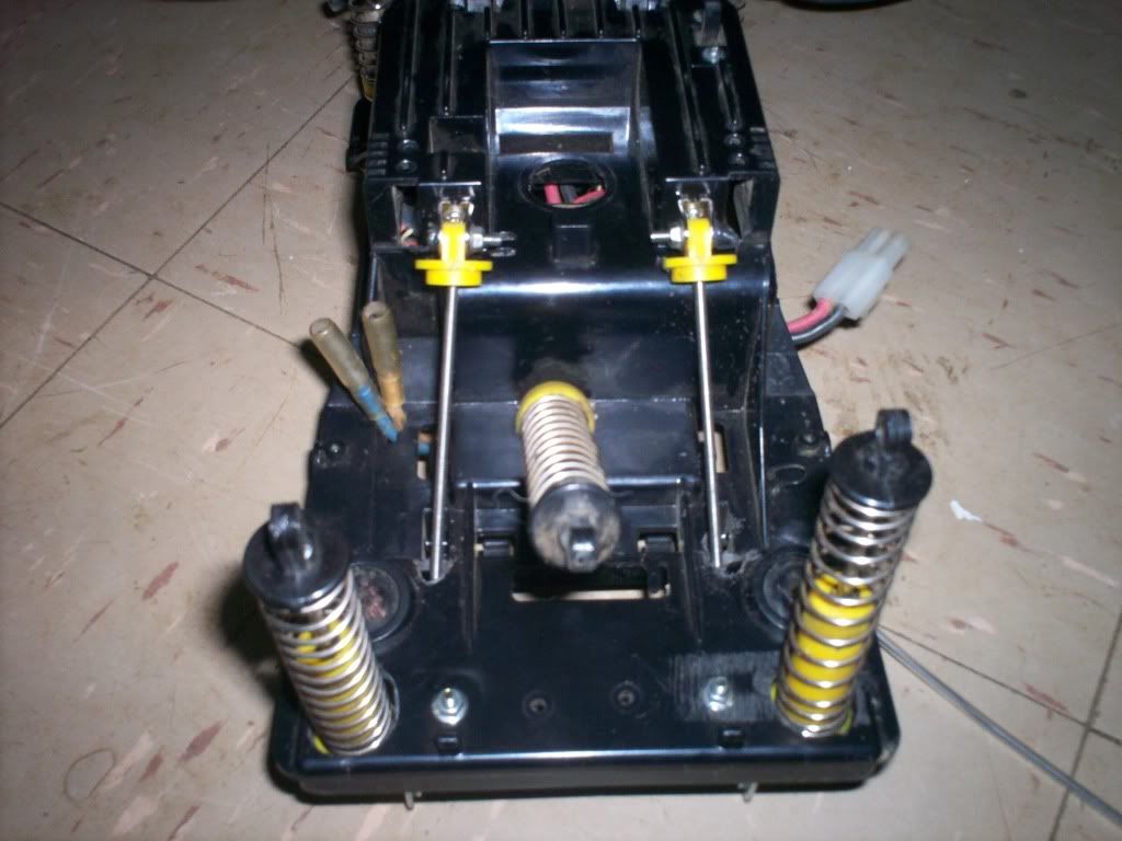

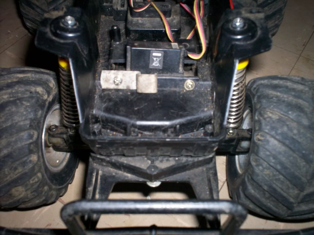

I have had these shocks sitting on my desk for a while now after deciding they were too long for the pumpkin,
Then I came up with this, inspired by all the great mods I have seen here.
Hope you can make out what I have done from the pics, if not please ask. :lol:
I will tidy up the holes in the shell, looking at the last pic I think I have to.
That's it folks, untill I break it again or do the front.

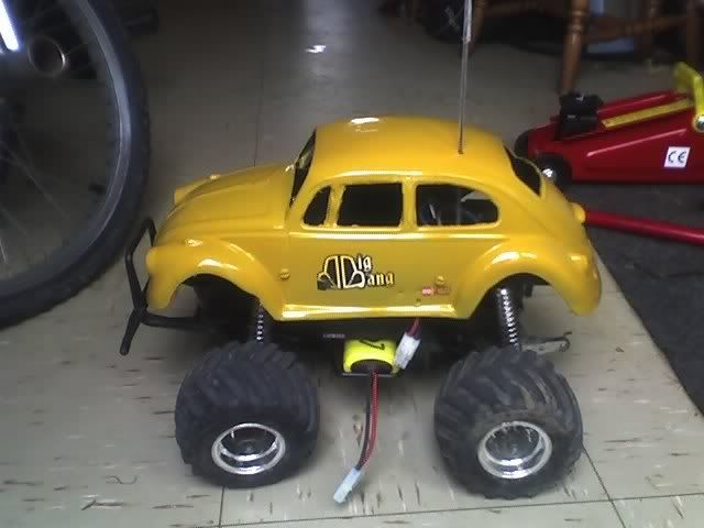

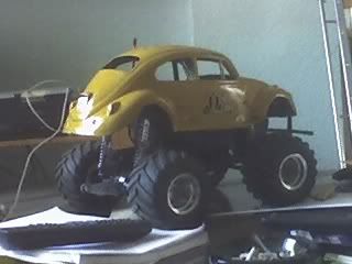

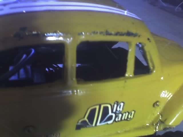

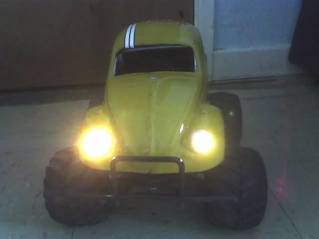

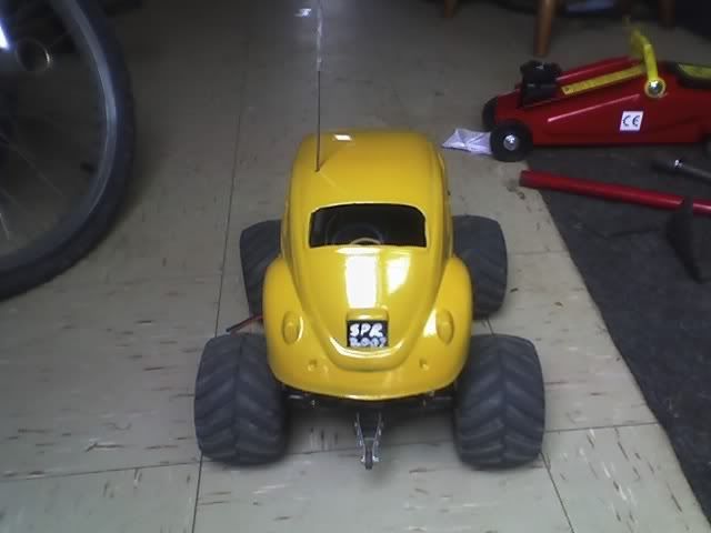

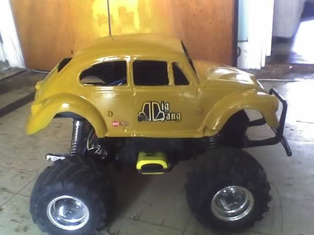

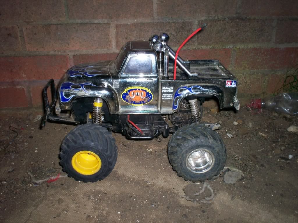

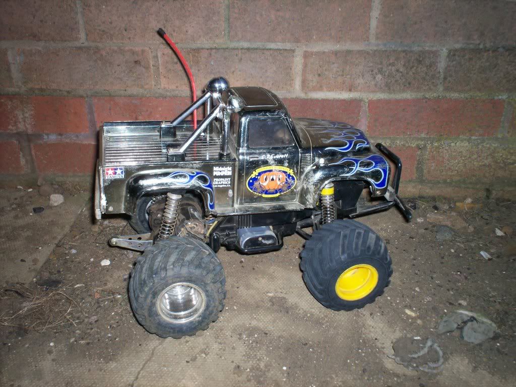

I managed to get some photos off my old phone of the pumpkin in a previous guise.
Sorry bout the quality.
The spr 2007 on the number plate stands for Santa Pod Raceway. :lol:
