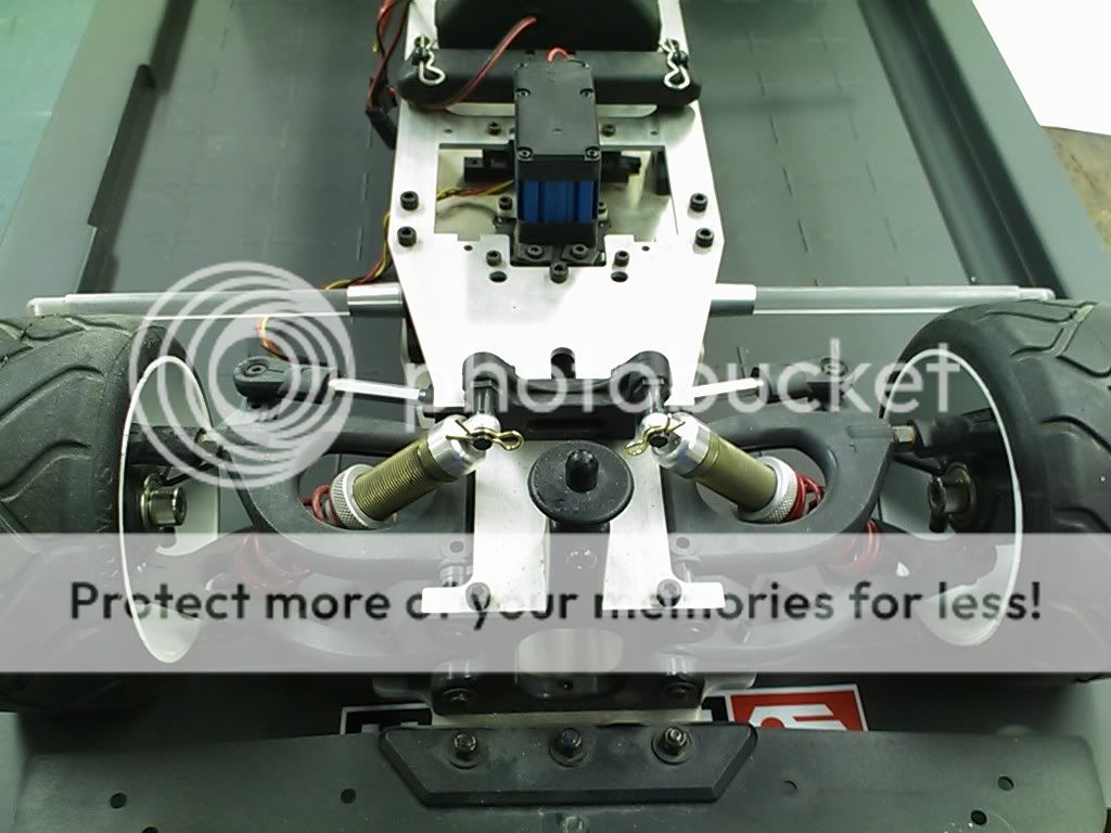

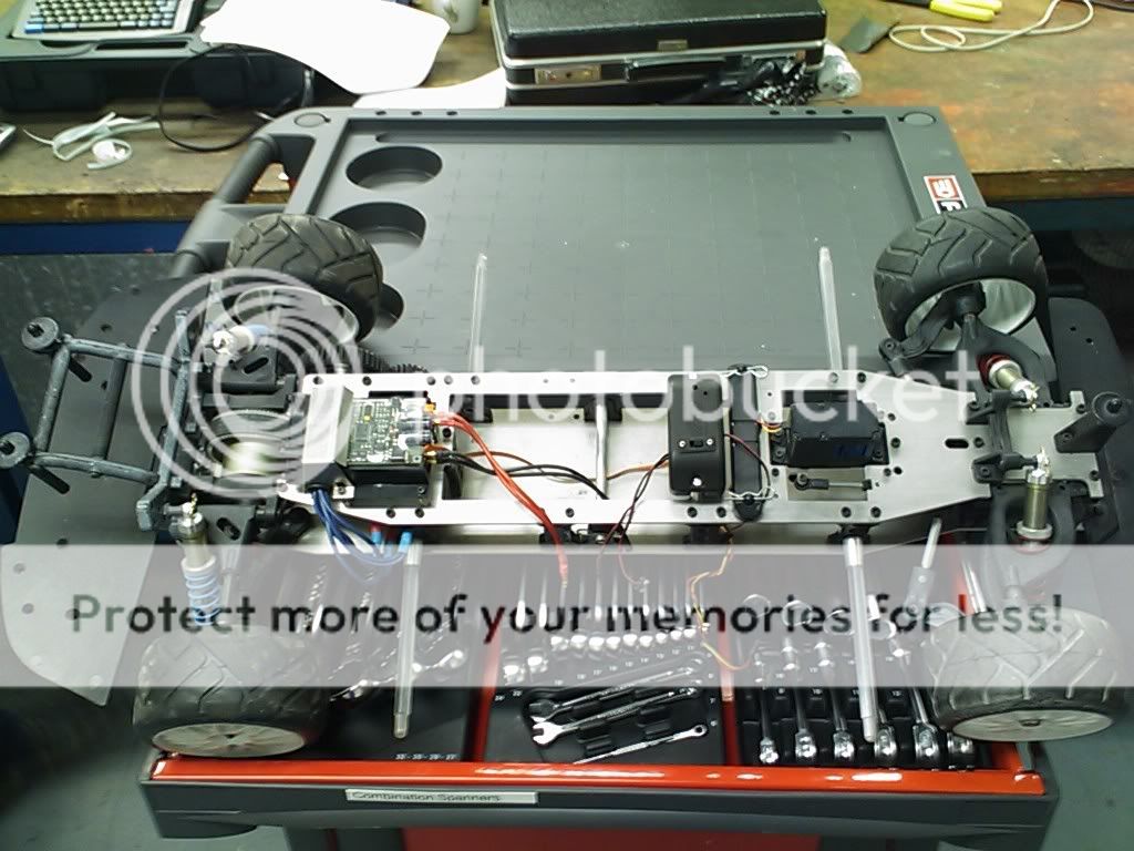

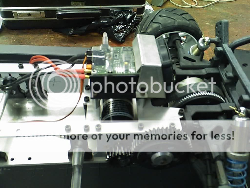

It looks like a narrow chassis FG touring car with the petrol engine removed and a Lehner brushless motor bolted on.
Its got a HiTec HS5735MG steering servo, the Lehner brushless motor and an esc on three PCBs linked together.
I had to do a bit of diy with some M8 bolts and shims for the front axles but its looking good.
Had a quick squiz at the Lehner website. It recommends 18 to 22 turn motor for 1/5 car (I think). The one fitted is 12 turn so I'll have to try it and see.
Also got to get some batteries to run the thing. A bit more research needed before I get this big boy running B)

Finally put some batteries in the car - 2 x 9.6v 3700mAh vapextech and a reciever battery.
The car has an els-200 esc. When I plug in the batteries for the esc the motor runs, with or without the reciever & Tx switched on.
Has anyone got any instuctions how to set up the esc?
Do I need the sepparate battery for the reciever - I've seen a spec that says the esc has bec?
I adjusted the radio trim so that I could test the car, loads of wheel spin if you gun it, but i'm worried that when it loses Tx signal it's not going to stop until it hits something. Can't risk that happening so it's a big paperweight at the mo.
