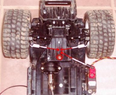

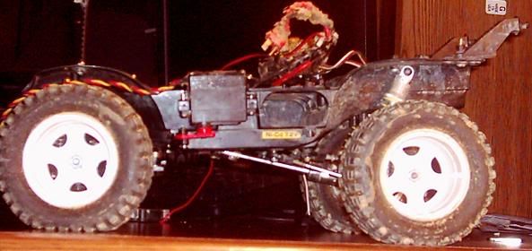

that's a pic of my side mounted servo setup. It pivots a bellcrank that has ball cups on it. I had to chop a skid plate screw pillar to get it out of the way. The tires on it are fully pneumatic, they are silicone sealed and locked, no foam, good for wet dirt or sand.

Wow, that's creative and a relative inexpensive mod.!!!
Also the the buttom-up real mount... surely will set the shell in high-heel style!

Here is a photo of the bottom.
It's basically a big screw passed through the skid plate that the upper part of the stock servo saver pivots on. By looking at the photo, you can see how it mounts up. I'm sure if I wanted to I could make a bearing setup. But now there is a huge hole there, I'll have to order a new skid. It's got some slop, but at least it can lock the wheels unlike the stock setup.
