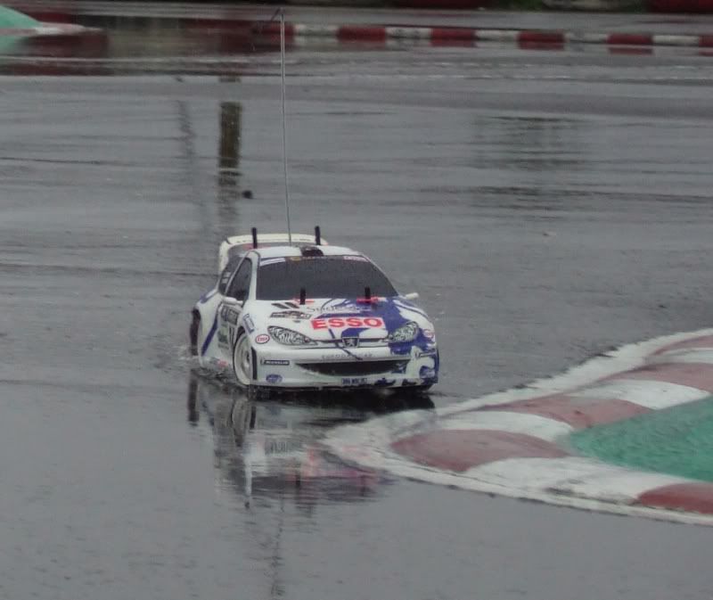

I like to use Mtroniks ESC's as they are great value and fully waterproof so you can play in the rain. I got my ta03 absolutely soaked on sunday, around 2 hours of playing and it never had a problem. The ESC was in a puddle at the bottom of the chassis tub!
In contrast, my brothers car lasted 5 minutes on the same wet track, thanks to its tamiya TEU 101 BK esc B)
