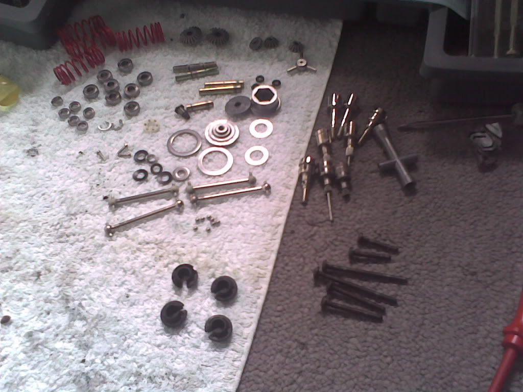

dont be scared of pulling it apart to do it, just lay everything out on a big white sheet, and pull apart one bit at a time. its not hard to build one of these, your average 12-15 year old built them when they were new!

I think I will go for it and try and do all the bearings.

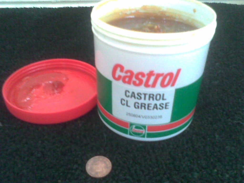

Do you always use Tamiya grease and never anything else, I have this grease (see pic) it says on the label. "Castrol CL Grease: A soft adhesive lime based grease with excellent water resistance. Suitable for exposed chassis points, and other 'wet' applications such as outboard motor controls etc."
Used to use it on my skate bearings. Is it any good for the RC car? Do you think its safer to go with the Tamiya stuff?

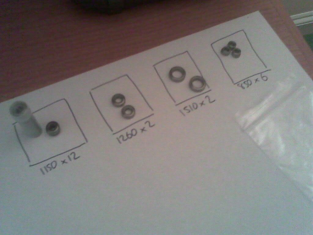

I'm no grease expert so wont try to advise you on that - bearings though - like I said - type "Tamiya TA02 Bearing Set" into an eBay search and you wont go wrong - Goldstarstockists offer a great service.
Ordered some bearings. :) It threw me a bit on the ebay page because it said "This listing is for a complete bearing set for the Tamiya M04 (M04M, M04L etc) series cars." then I actually looked at the type of bearings (1260, 1150, 850 and 1510) and counted them and it all adds up so they are on their way hope it will all turn out ok in the end.
After all theres no point restoring it if im just going to stick the shell together, need to do it properly and get stuck in eh! Now while im going to have the thing apart I may aswell get some other bits done at the same time. Oh I see what you did, you knew I would do that didn't you :)

Im going to need some tamiya ball diff grease (53042) I think but is this only for my rear ball diff? The instructions are labelled the other parts as "grease". I think there was a ball diff grease and a grease in the kit. I might be able to get away with a ball diff grease and that castrol stuff for the other parts?
is it ceramic grease I need for the other grease points?
Todays post brought me my bearings and shoe goo. Now just waiting for the new ball diff grease to arrive, probably tomorrow.
All bearings accounted for, I really cant wait for these to be in there now, I want the scarey bit to be over!

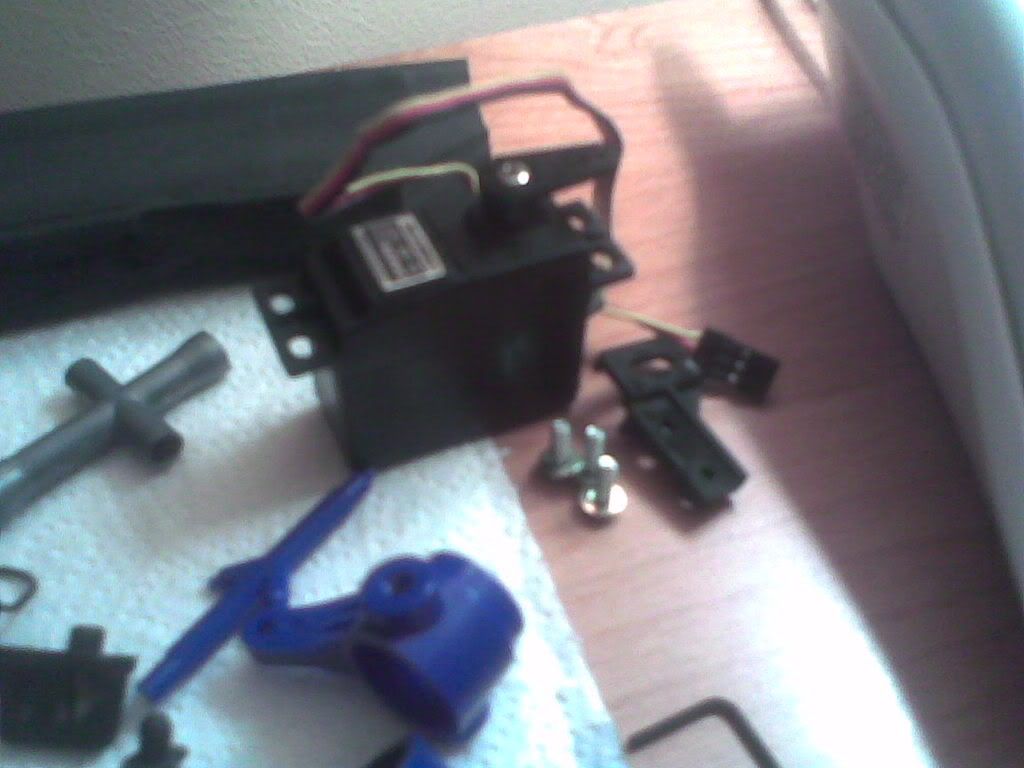

Off with the servo.
Off with the MSC. :lol:

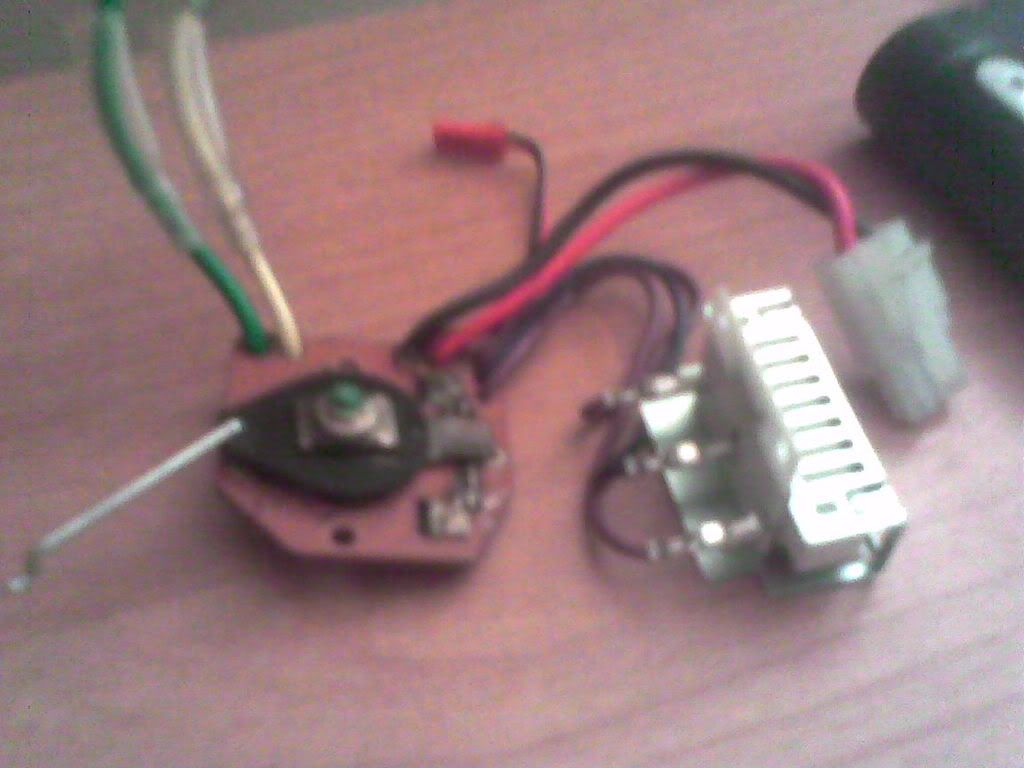

My brother got a tamiya 2001 scooby on a TL-01 chassis and I mentioned about the ESC and how it would be much better than the MSC, he was hooked line and sinker. We went down to the local model shop to poke around and see whats what, we both decided we wanted an ESC there and then. We got ourselves an LRP AI runner (83060), which the lady in the shop recommended. We might have got cheaper from ebay but we kind of took a chance with what the lady said and put faith in our local model shop.
Fitting that was fun, we found out that there was no switch with it to turn the car on or off. ;) So now my brother is trying to find out how we can bodge our switches, or fabricate a new switch for the car so it cuts battery power. Anyway, we fitted them all the same and then took them out for a spin and had a good bash around outside his house. It was cool racing another car, much more fun than out on your own! Mine seemed to go a bit quicker but we put this down to the new bearings but possibly just the differences in chassis and diffs etc.

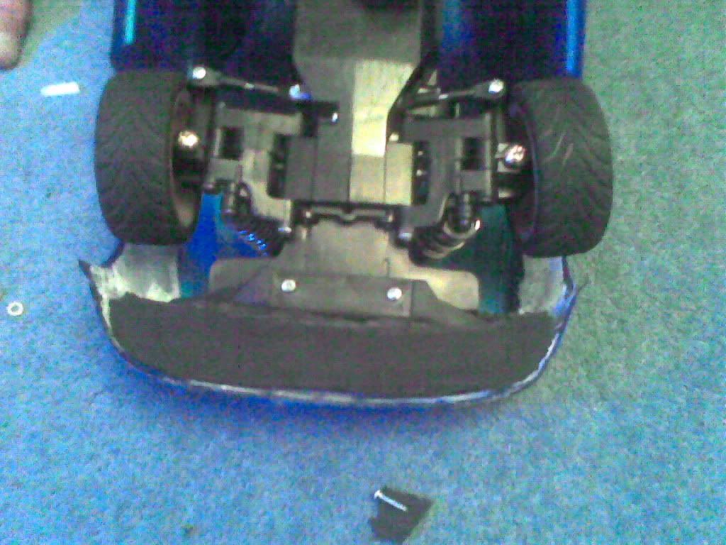

We had a bit of a collision which broke the front shell off of my brother subaru I think my bumper worked for me but not for him hehe. Then I noticed something loose in the car and a strange noise and a little wobble on my rear wheels, a minute later the rim of of the two peice was completely loose. I sheared off my wide rear wheels at the screws! I was gutted. Its been super glued but havent tested it out but I fear it just wont last. Im not sure if I did it hitting a curb or just from the strain of throwing the car sideways at top speed. Maybe it got fragile in the cupboard over the years.
We patched up the shells using that shoe goo and some bandages from a first aid kit for reinforcing, both of the shells are now pretty much repaired and mine is looking a lot sweeter and stronger than before, thanks for the help with that guys. Got some stickers on it and things so its had some TLC there, and a new illuminous aerial cover (bit of an impulse buy in the shop :( ).

Its awkward unplugging the battery to turn it on or off, it was easier with the switch. To unplug the battery you need to take the shell off and that can get old really fast everytime you want it on or off :( .
Weve had the reverse thing too. It happens when you turn it on and it uses the first input in setup, if you use reverse as the first movement it thinks thats forwards, if you give it a burst of forwards when it goes on itll save it the right way. A quirk well just have to learn to live with hehe.

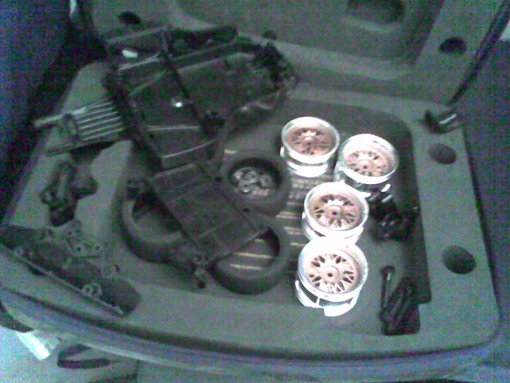

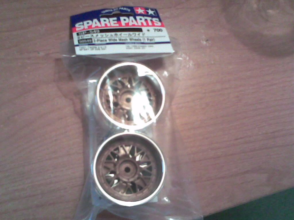

Today I got some new rear wheels for my taisan in the post.
I still havent tested if the glue held on the broken rim but im pretty certain it wont have. So the new ones should keep her running for a bit longer.
At the same time ive been looking at some other wheels for the chassis. After a bit of a search on this forum ive found that kawada wheels can do a fronts and rears that will suit this, so I might get some of those to bash with and keep these older fragile wheels for storage, once I've paid off my credit card this month, anyway. :D I should have probably just purchased new wheels instead of the old ones but id rather have a set of original rims to go with it if I do decide to leave it out on my shelf. Just hope I dont break these brittle things before I can afford some stronger ones.

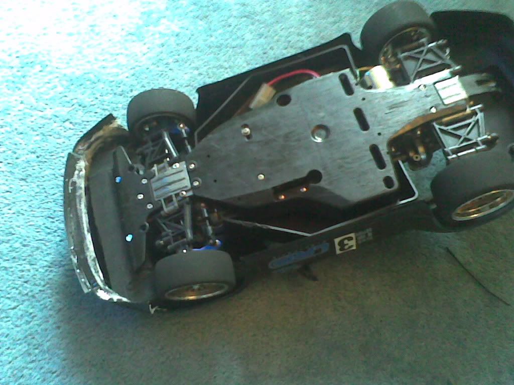

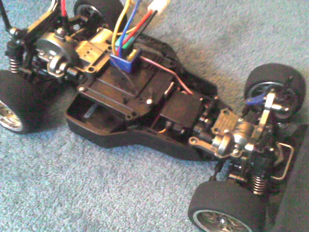

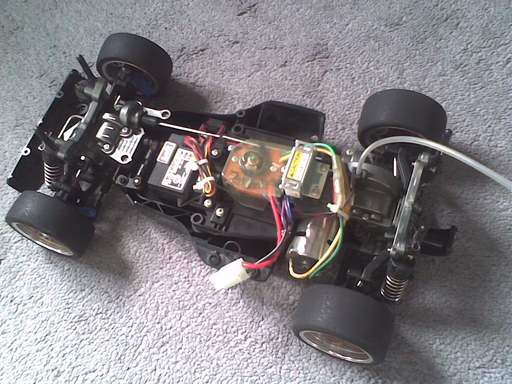

This is how my car looked when I got it out the cupboard with old msc. I seem to have strayed from my keep it original thoughts and just made it my current bash car. Still saving up for a new chassis and shell thats second hand and cheaper to bash with before I break too much of this. (Oh and I need a new camera still)
how it was when I got it out of the cupboard with old msc
MSC and its chassis mounts removed, new ESC, receiver moved off of steering servo back into old MSC servo space and an improvised quick release thingy, wires tucked away neatly. New pink rigid aerial pulled tighter and longer into a new sheath with a handy tip for poking thru my shell :)
switch removed and sealed with rubber

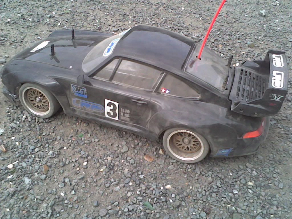

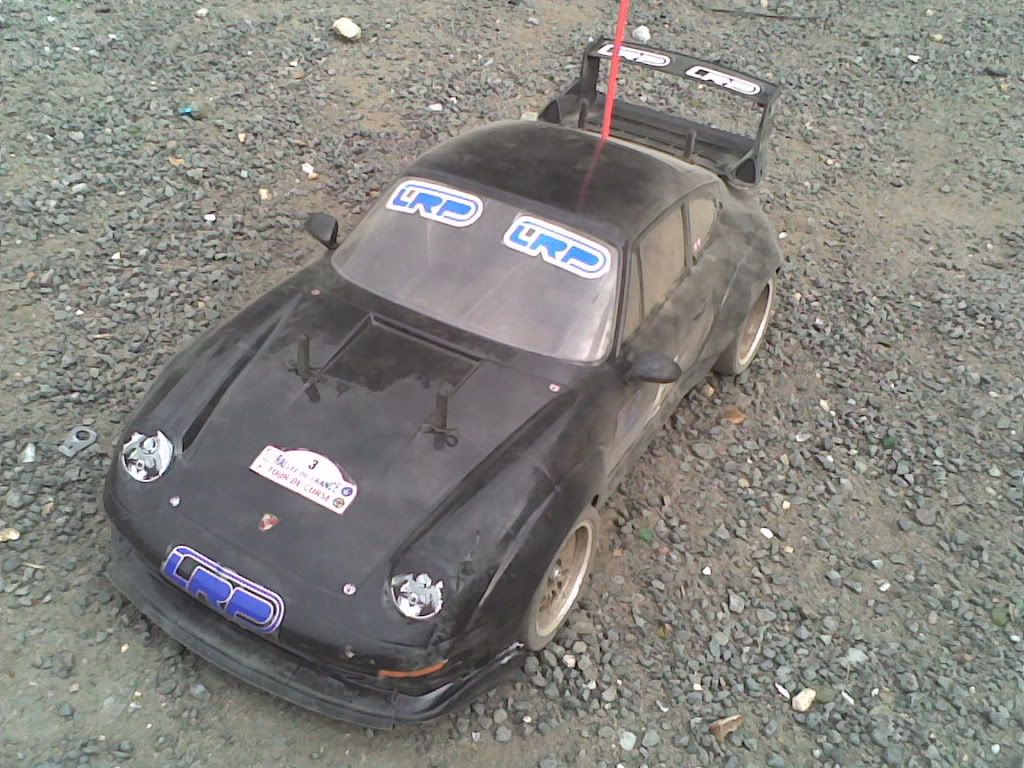

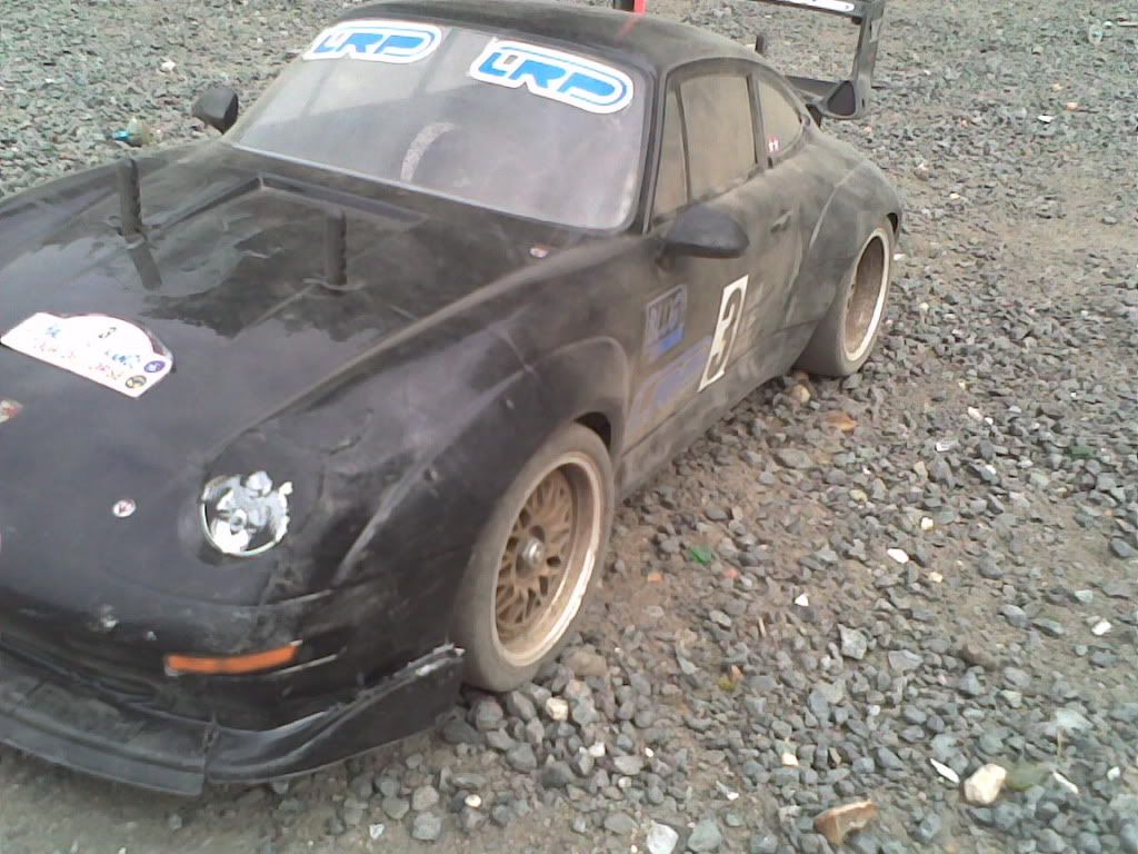

really loved this little day out rallying but now I have to clean it all up

hey man rather than the kawada wheels, get some HPI drift type rims, and some HPI 4435 tyres, the rims u need are 3mm offset fronts, and 9mm offets rears, the 4435's are way stickier than the tamiya tyres, and these cars handle so much better with even size tread front and rear..
WOW sideways!!! Are you rally racing that thing? That are looks very dirty and rough judging by the looks of your car in the pics. Thats probably why your wheels break .That area is way to rough for that car, its made for the street.
The old wheels broke while out in the street on tarmac, took it out on dusty gravel with the new wheels and they lasted so far hehe. Dont think ill be getting it so dusty any time soon though, it was driving sweet, with some nice 4 wheel drifts and counter steer. :P
The offsets ive got written down for the taisan are 2mm at the front and 10mm at the back. I read a post somewhere from someone who tried the TU37WP kawadas (4mm) on the front of the taisan which were too big for the front wheel arch and they mentioned that the normal TU37P (2mm) are the ones that fit properly, although I cant find anywhere to buy them from. With the wide TU38P (10mm) on the rears.
Have you tried the HPI 3mm and 9mm wheels on the taisan do they fit ok under the arches, I see that it would even out the front and rear treads by a few mm but just wondering how it looks once done.
My brother has a tl01 subaru 2001 #58276 we repaired his shell after my bumper destroyed it, we decided to make him a bumper too to reinforce his repairs, his sits nice and flush now, I might redo mine it needs some careful shaping to fit inside the 911 nose. He also fashioned himself some adjustable steering arms from some old broken bycmo chassis. This is a picture of it.

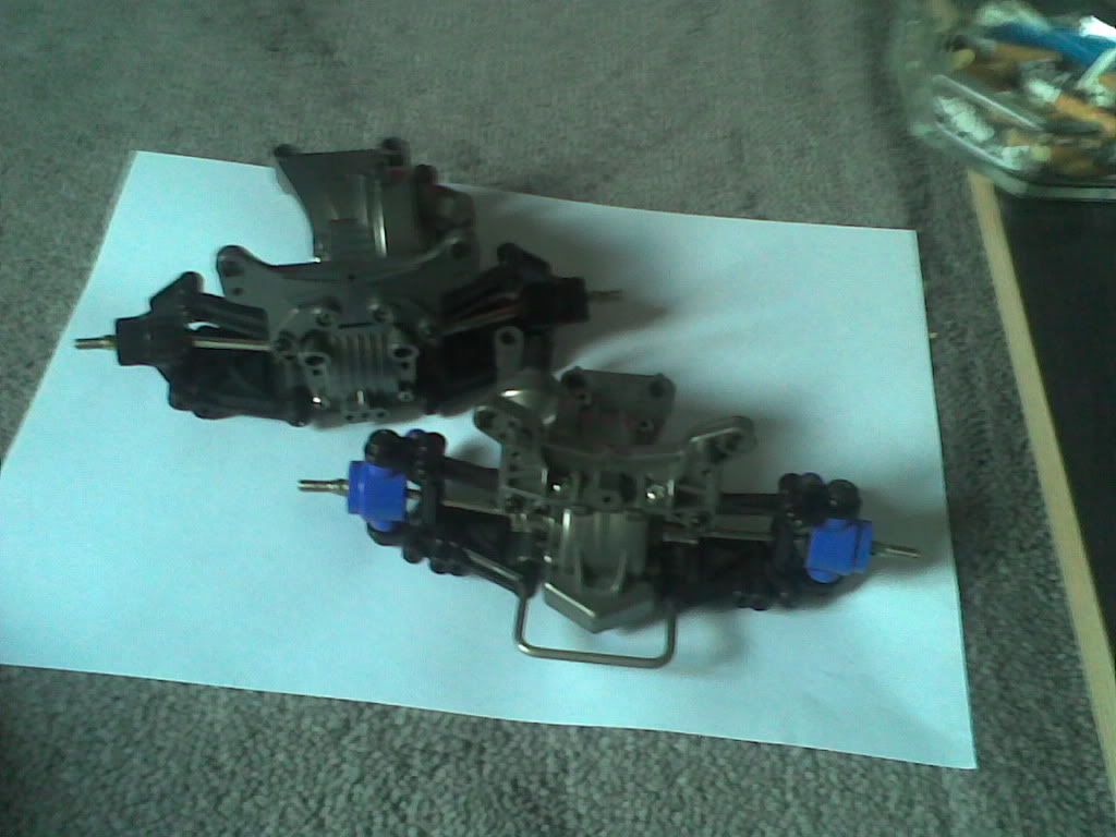

As I said I would do, I have cleaned the thing up now, I know this car inside out now as if I original made the kit. Its pretty clean after I stripped every part down and scrubbed with a toothbrush. Cleaner than it was pre rally bash. I re greased everything, even the ball diff. Its all so clean even inside. All teeth checked out, only the pinion seems to be a bit bent. Noticed a few cracks appearing on some screw holes. May replace some more parts in the future as funds allow, but for now she will be retired and only do calm drive arounds and light driving from now on.

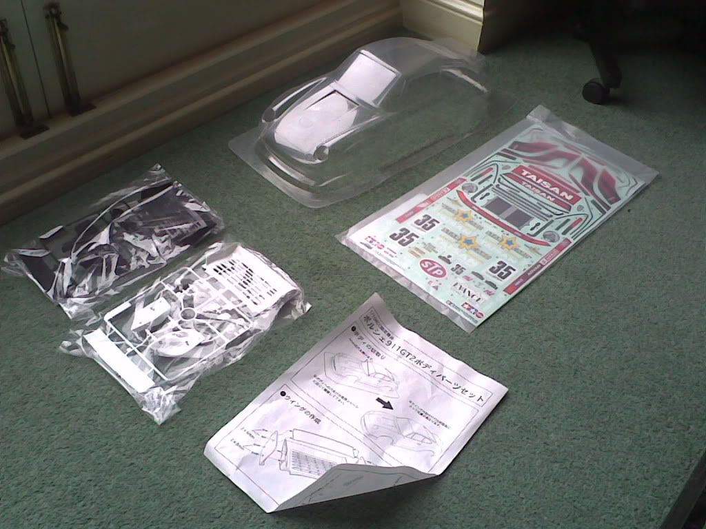

Also I got myself a NIB taisan shell and body parts including decals. Turned up today in the post. Woohoo! The shell will be a minter to go on the shelf. New set of wheels are in the post. Just need new tyres to go on them. Hehe. I gave my porsche a real treat huh?
Cant wait to get it done. Although I will practice on another shell first (even though the taisan is black and one colour lol). I have a new kit on its way of a DF03ra so my time will probably be devoted to that before long, I just want to see this car finished and shelved now I couldnt keep bashing with it, eventually id break something I couldnt find on ebay.

I do have some standard taisan wheels in the post that i wont run, but I would still like to see that pic, is it the 3mm ones on the front and does it rub at all when the suspension is compressed?

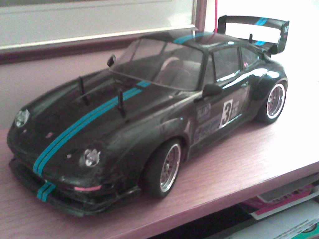

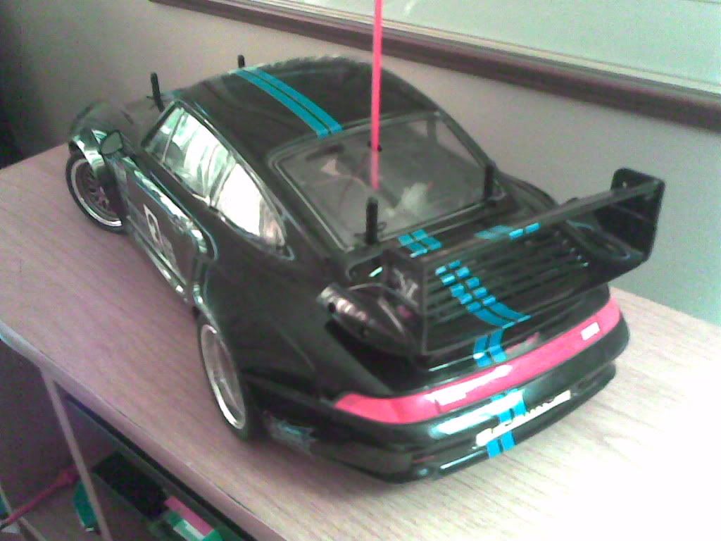

a couple of pics of my new stripes. Rushed it (bits are coming off already and the stripe isnt "offset" enough for me) but its the old basher shell anyway so doesnt matter. ;)
I was looking to put some tamiya radials on it maybe but i am open to other tyres that are good for the shelf, with sidewall writing and nice tread patterns, but also that fit the taisans wide rear and fronts. its hard because a lot of shops dont show all the measurements like width, radius, offset, tyre height or what material they are made of. im worried ill order something that wont fit. thats the thing about odd chassis models, buying for it is a gamble. im looking forward to getting my df03ra which will have standard wheels (i think? hmm need to check this out).
also it seems like the tamiya radials tread doesnt quite match up, or is that just me? is it because of the width difference or is that how it should be?
do you think some slicks or semi slicks will look better on this car since its based off of a track racer? the semi slicks are nice looking if not being run I guess as they X pattern will not wear out. anyone know if they have writing on the sidewalls? I want the sidewall writing (either tamiya or real world) as i think that looks nice. :lol:
I can find part numbers for the tamiya wide radials and semi slicks but not for the fronts to match up. they appear to be 26mm wide at the front and 34mm wide at the back can anyone confirm this too?
