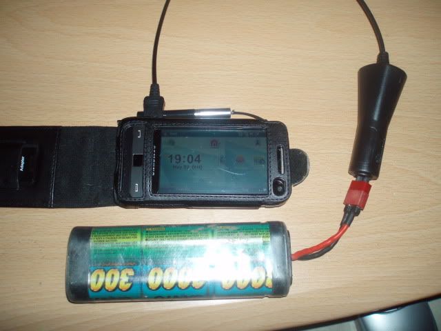

And heres my latest non rc use for an rc part lol
Im off to Glastonbury festival in just over a month and as always phone charging is expected to be a bit of a mission - as im working there a phone is quite essential.
Last year I tried a 12v solar panel charging a 'car starter' portable power supply - but it couldnt quite hack it for a week.
Ive been experimenting over the last couple of weeks using a car cigerette lighter type charger and 7.2 volt racing packs, and I can get about a weeks charging from one 3000mah pack - my phone is a quite power hungry Samsung Omnia - normally lasts just over a day lol
So after establishing that it works I set about making it prettier and a bit more robust. It really was as simple as removing the springy bits for the car connection and soldering the new wires directly onto the pcb where the old wires were :-)
A Charger from my local market (cost 1.49), a deans connector from my bits box and a bit of knife and soldering action later we have this:
