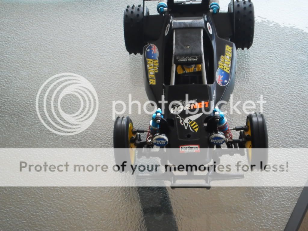

Please, someone can tell me if this conversion is larger than original set up or equal? Is it like the Hornet/Grasshopper 1 or like Super Hornet/Grasshopper 2?
And in millimeters what's the front width?
Many thanks
Max
Max .
My front end is 21cm in track. I don't have my standard Hornet here as it's my hobby house, I don't think it's any shorter in track.
Front shocks i used are Yeah Racing 70mm. Team CRP Futaba FX10 ( Same as the Tamiya Striker ) twin arm conversion. I used different front hub carriers to get a better roll center.
Hope this helps.
Mark
This is a good starting point. The original GH2 front width is 20 cm axle to axle without thread. With the tread is 21 cm. At the end larger than GH1 and Hornet.

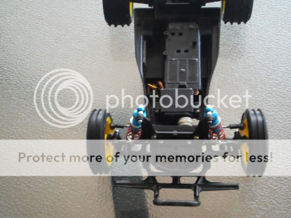

:huh: I just hate the weird camber the CRP kit gives you with the drastic difference in upper and lower link length.
Yeah I agree.
I used the Team CRP FX10 conversion for my Super Hornet which is available still for little money.
I used DT02 front hub carries & axle blocks which gives a lot better front roll centre placement then the stock CRP items. Custom camber links were then made up along with DT02 steering links & servo saver were used in replace of the cheese straw links.
I used modern front shocks which required further modifications to the new CRP lower A arms. No bump steer and better damning which gives a lot better steering .
Yeah I agree.
That mod really looks awesome! Where do you find the black part you're using on that Super Hornet?
  • 2 months later...
The only performance shocks I know for the hornet period correct are parma or panda, or the crp hornet conversion kit or other 3rd party performance products back year's ago, which i own, best bet go the crp version.
It seems handmade...
Max
I recently saw this one and I'm curios about it.
Is this some aftermarket piece or it's a custom aluminum part?
