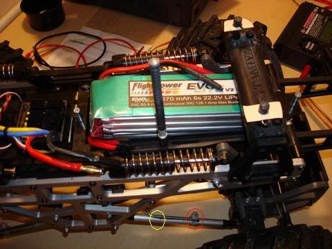

The cable tie on your sway bar is in the wrong place:
It should be where the yellow circle is.
Unless you've done that to improve articulation for rock climbing ;)
You're good!! I actually want to change all the cable ties (the others are in the correct place) to see if I can get a slightly more secure attachment (granted they need to be able to twist some).
