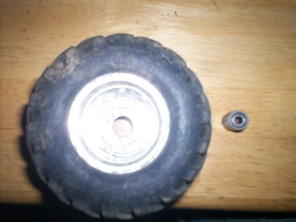

I noticed my pumpkin has a wobbly wheel, turns out the centre of the wheel has come loose and can be removed from the wheel, but this pumpkin does take some abuse!.
This is why my wheel was a wobbling,
Just checked the other front wheel and that's come loose as well, just hope I can glue them back on straight!.
