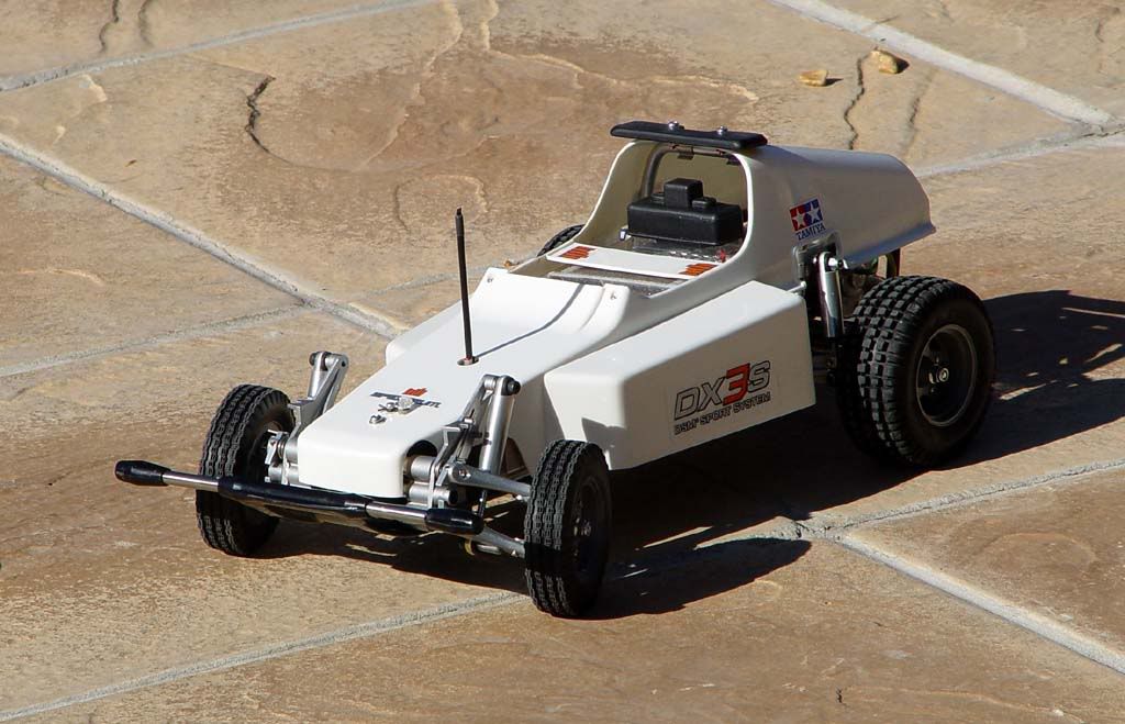

Hi everyone, respects and greetings to all.
Hope you don’t mind a rank newbie posting some comments and a few snaps of his own variation of this great nostalgia trip.
Like many I also had a Sand Scorcher when it first came out, and had much fun trying to improve it with things like a rear anti-roll bar, a self-adjusting rear wing (that varied according to steering position), better motor and a Demon esc, but when that blew up I later gave the car away to the son of a friend (!). Thirty years later and we have just moved to a place with a large garden, and was thinking it might be fun to get a tough radio controlled car to play in it with when by chance I discovered the re-issue. Bravo Tamiya problem sorted!
So having pre-ordered a Buggy Champ I needed to get some electrics for it. As I probably wouldn’t be doing this again for a while I thought I would look for an interesting radio and eventually settled on the Spektrum DX3S system. Being interested in radio technology I liked the apparent intelligence of this system together with the ‘duplex’ telemetry and large lcd on the handset. So, I also use a Spektrum radio with the BC, though being old and used to sticks am not sure about the look or feel of the TX - perhaps with my Darth Vader costume on I will feel more at home with it.
Anyway, the BC kit itself looked as far as I can remember virtually identical to my original srb rolling chassis apart from the few minor changes already noted by others, and I had some serious deja-vu putting the machine together, hardly needing the instructions.
I also found that the front wheel bearings were a bit narrow for the stub axles, and my own fix was to place a ring of 20guage solder in the corner of the bearing well to space the inner bearing away from the hub centre. The loose (always were I think) rear shock absorber top mounts were fixed by a bit of duck tape wrapped around the roll bar before clamping the castings on.

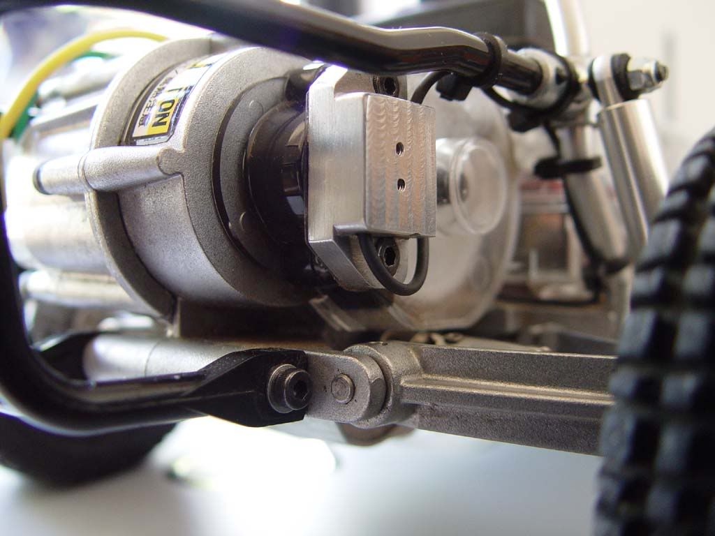

I liked the idea of knowing battery volts and esc temperature as well as having a rev-counter on the handset, but found that the optical sensor position was fairly critical and a special light proof mounting seemed to be needed. In the end I milled a small alloy box out of the solid and chopped away the area around the motor pinion on the clear plastic cover. Painting that area black I replaced the sensor’s ribbon cable with some thin but tough headphone wire. This was threaded through the existing rubber esc wire grommet into the electronics box. (You don’t have to cut this grommet to fit it if you remove the soft plastic bullet connector covers from the esc wires first.)
Frustratingly the ‘needle’ on the lcd remains fairly erratic (perhaps some revised firmware is needed here), though the MPH option seems to be more stable. But I wonder how you are supposed to drive the car while looking at the Speedo, as my car usually ends up in the scenery! However, with the taller gear option fitted an indicated 25 MPH is displayed on the handset at full throttle.

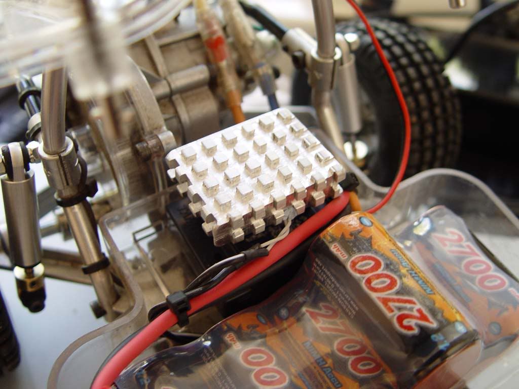

I fixed the temperature sensor on the esc heat sink as I was interested to see how hot this would get. The Tamiya unit was probably designed to be mounted in the open but now of course it’s in a virtually sealed box. The rest of the electrics consist of a Prolux 5009F metal geared servo and a Carson 7.2 Volt pack.
The first run seemed fine apart from the esc reaching 85 deg C after about 15 mins of fairly hard running over grass and gravell. Would this become a problem? The esc had not cut out and MOSFETS can take more than this of course, but the temperature was not heading in the right direction.. So I hacked a chunk of aluminium about to give some more mass and surface area, and bonded this to the esc heat sink with silver thermal epoxy. This seems to lower the temp by about 10 degrees C.

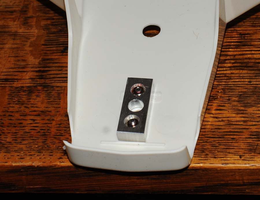

The last couple of small mods. are to the body. As I don’t want to worry about damaging paintwork or those spot lights when bashing about I have left the body un-finished and in the white but with a few relevant stickers. But as the body helps with chassis rigidity I did though re-enforce plastic at the fixing clip hole at the front, and I also made a sacrificial ‘hat’ over the roof to give some protection when rolling over.
@Thermionic , Wow, an involved and fascinating post, way cool, I enjoyed the read. Interesting on the sensor stuff. Good luck with the conversion from sticks to a wheel - when I got a wheel TX second hand with one buggy it was like it was from an alien planet, I couldn't hardly control the car to move around slowly indoors on carpet I was so confused. LOL.
