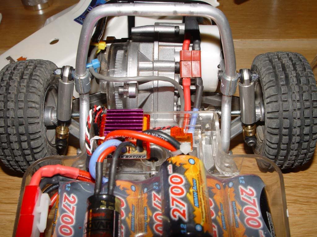

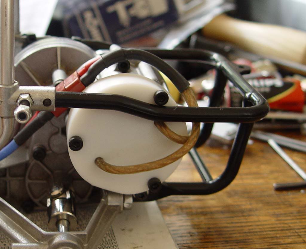

Well, and with respects and apologies to the purists, I am afraid that I have been playing with my Buggy again and hope this long post might be of some slight interest.
With one of my passions once being for fast (ish) cars, I tend to think in terms of driving rather than modelling, and one of the fairly obvious aspects of the Buggy Champ to me was an almost total lack of brakes. (I drive mine mostly on grass or gravel so the locked diff is probably more of an advantage than a problem.) With my original Sand Scorcher of many years ago I eventually fitted a Demon 2 esc which naturally made the car more drivable but also provided a good amount of braking. So I thought I might try and do something about this new machine, and perhaps at the same time boost the performance a little.
Trouble is these days to this newbie like me there is mind boggling choice in how one can power an electric rc car. I suppose the obvious thing to do is to get some sort of brushless set up and be done with it. But as we know, the motor mounting arrangement in the BC is specifically made for the standard 540 form factor motor, and nothing apart from that or its tuned variants will fit.
Through my avid reading of various forums I also got the impression that a brushless system might not necessarily provide the best brakes. More confusion set in, and there was not much help from the various manufacturers web sites, as they seemed to have little hard information about their products, especially for someone attempting something different.. It was though becoming obvious to me that most if not all brushless motors have the winding exiting via a pcb at the rear end, and therefore would need some hacking about of the BC’s motor moulding or gearbox casting to fit. So this inclined me towards a good brushed system, perhaps using a performance 540 variant motor.
So what esc to buy that would have good braking? Well I kind of made a mistake and ordered a Novak GTX. in error! I had narrowed things down to a LRP Quantum Pro 2 (I think) as it seemed to offer racing type performance, good breaking with reverse. But I also came across the Novak beast, with its advanced brakes and programming features at what seemed a good price. So ordered one, not realising that as a true racing esc it would not come with reverse.

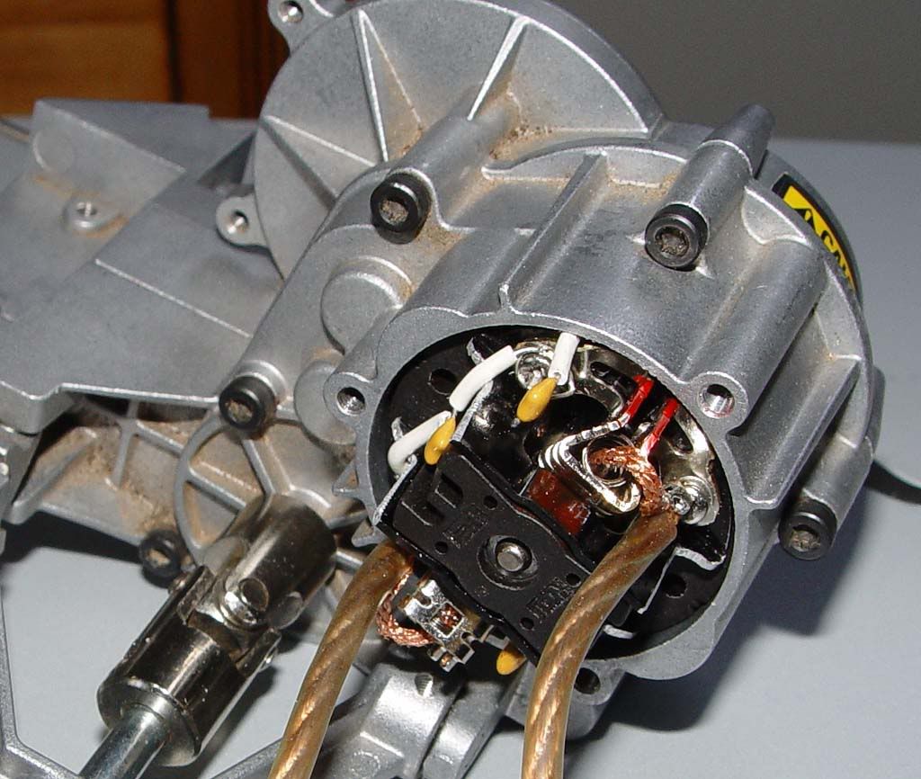

As the tuned Tamiya 540 motors seem difficult to get at the moment I plumped for a 19x2 turn Orion Method, because I was advised that this should fit the BC and give a good improvement in power. It was £20, so not a complete disaster if it didn’t work or fit, not like the GTX…
Well you can fit an Orion Method in a Buggy Champ (images below), but you do have to do quite a bit of work first. The motor can fits in the gear case, but you have to remove the label. You then have to grind about a millimetre off the spindle at the pinion end. The brush holders need to be removed, have both their tabs taken off and about half a millimetre ground off their outside edges (so they can’t short out on the casting). The aluminium wings under the brush holders need grinding to fit the extra caps required for the GTX. And two caps need to be soldered to the can, but there is no room so you have to use the space where the can tabs fold into the end plastic moulding. You then have to discard the Tamiya clear plastic motor moulding and make or find a suitable waterproof cover. And lastly, properly retain the motor in the casting with a three millimetre screw from the pinion end (probably two of these would be best). Oh and lastly again, directly wire the esc wires to the brush solder tabs.

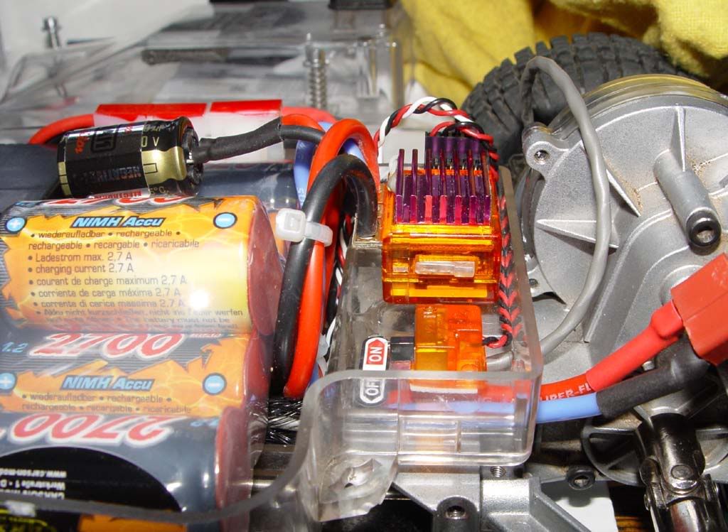

I decided to keep the non-reversing GTX mostly to see what it would be like with the Orion, and hopefully being able to stop would remove most of the need for reverse anyway.
The GTX installation was a lot more straight forward than the motor. The unit is tiny and just needed to be positioned with regard to the thick wires and being able to get at the programming button. I kept the supplied Novak switch, not bothering to graft on the Tamyia slider. The bec is a well regulated 6.3 volts, so the Spektrum battery volt meter is pretty redundant. The alarm though can be set so that once the volts dip below regulation the alarm goes off. Another effect of the new esc was that the Spektrum rev-counter went even more manic than usual and was giving some even dafter readings. But I had used non-screened wire to connect the optical unit to the receiver (Spektrum use an un-screened ribbon cable - might be something they should look at) and it seemed obvious that all sorts of pulses from the esc had been getting into the counter’s front end. So I replaced the sensor wire with some miniature 3 way screened (black wire to the screen) and suddenly I had a perfect rev counter and speedometer. No meter needle jumping about any more, just a steady and apparently accurate indication of speed and revs.
I have only had one session with the new setup so far but the differences are obvious. Acceleration and top speed are of course noticeably improved, with the problem now being getting the power down and keeping the car in the wanted direction. No wheelies yet, but what braking! Just like in a real car; lift off the accelerator and the car instantly slows, slam the brakes on and the machine comes to a pretty quick halt. No locking of wheels, but I have yet to get to grips with the subtleties of the GTX’s programmes. Very promising stuff and the new set up seems to give longer run times as well, in that I was getting about 29 minutes running with the previous system and for the first run of the new one I got over 35.
Nothing is perfect though as the GTX heat sink at the end of the run (35 minutes in the closed box) was at 85 Deg C, so I might have to do something about that. Lack of reverse remains a slight inconvenience, so I might investigate using the aux channel of the Spektrum to actuate some sort of reversing of the esc output. Not real problems but interesting things to ponder about

@Thermionic, I hope you didn't pay much for the GTX [ whoops, in later post I noticed mine is a GT7 doah! ], mine was 2nd hand (like Jim's) at around 20 GBP from USA. Very good brakes with my Top Force and 12 double Reedy Ti modified. I went to Deans connectors for that car like you did, and used the heat resistant connectors instead of the normal ones, soldering can be done on 14AWG cable in 6 seconds, without any damage to the connector. I used Deans Racing Solder, it's unbelievably good stuff with a VERY active and tennacious flux and excellent flow, and an Antex 50W iron with interchangeable heads (3 chisel tips, 1mm, 2mm, and 6mm), I use the largest head for these kind of jobs.
I had to use a Schottky diode from Reedy as I couldn't get hold of a Novak one, plus 3 Reedy suppression capacitors. I made sure to keep the power capacitor on the ESC.
The Tamiya Super Stock RZ has the suppression capacitors on a PCB so you don't need to solder any cap's to the motor can.
A very interesting post. I don't think I'd have used that IMHO ugly motor cover though ;) Also why do you need a heat sink on the GTX [ whoops, in later post I noticed mine is a GT7 doah! ] ? I didn't even know you could add one since the unit case is all plastic which won't conduct the heat away readily anyway? Why have you put the switch on the inside of the radio box?! LOL.
Cheers,
ARG

If you are running a Schottky diode on the motor (which you MUST to keep the ESC brake circuit from overloading and the brakes going soft as a result) then you CANNOT run the motor in reverse or you will DESTROY any connected Electronic speed controller!
