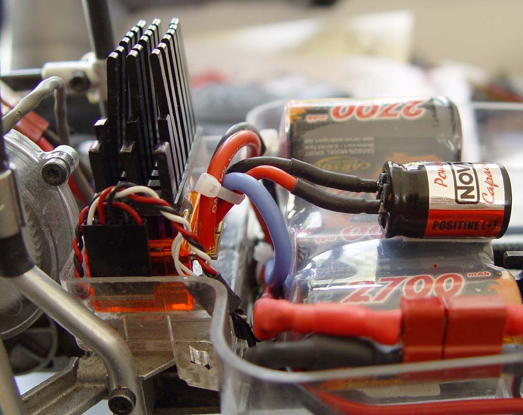

Right, further to the overheating problems with my Novak GTX running on part throttle settings in the BC (for just cruising about - see previous posts etc), I have at last hopefully sorted this out.
Unfortunately Novak don’t seem to provide an add on fan for this lately discontinued racing esc, and what is available would seem to be too large and not easily fitted. A fan anyway would to some extent reduce the running time, and so I thought about fitting some extra heat sinking similar to that fitted to my now defunct Tamiya TEU-101BK.
After rummaging about in my box of junk PC boards I found an old chip cooler with some nice long figures on it. This I cut down to fit the limited space available in the BC electrics box. I knew there was a reason that I had not put back the on/off switch in the box lid as the heat sink could now extend into this area.
My modified new heat sink was simply glued with heat conducting epoxy to the top of the existing GTX heat sink, not pretty but functional.
The end result being that I can now cruse around on resistive surfaces such as grass for periods of 20 minutes or more without the esc temperature rising much above 60Deg C. Before addition of the new heat sink it was reaching 85Deg after 10 minutes. :)
T
