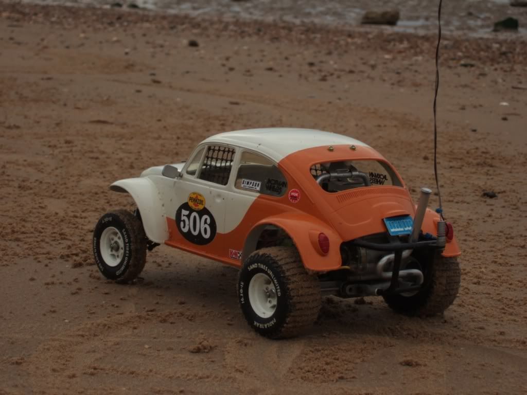

I got my alloy exhaust from ebay, I think mine came from seller Mike00top, who's still making different designs.
Here's a picture that shows it
More pics of my sand scorcher in this shameless plug for my showroom, tamiya101 it someone please!!! lol
