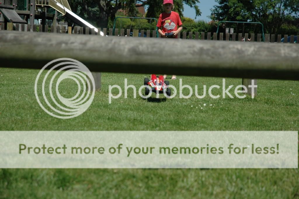

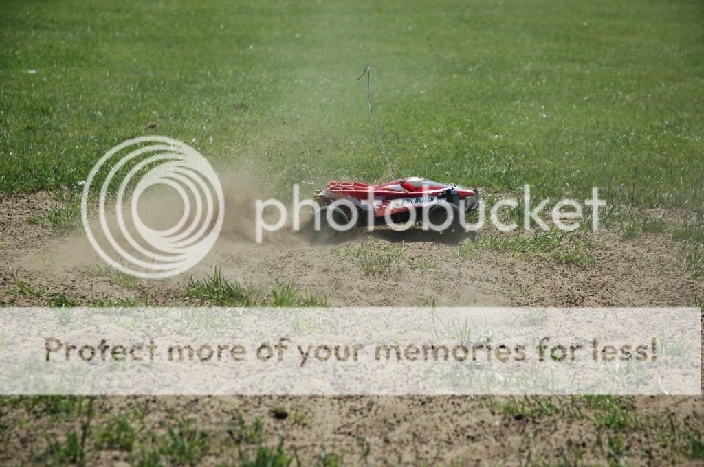

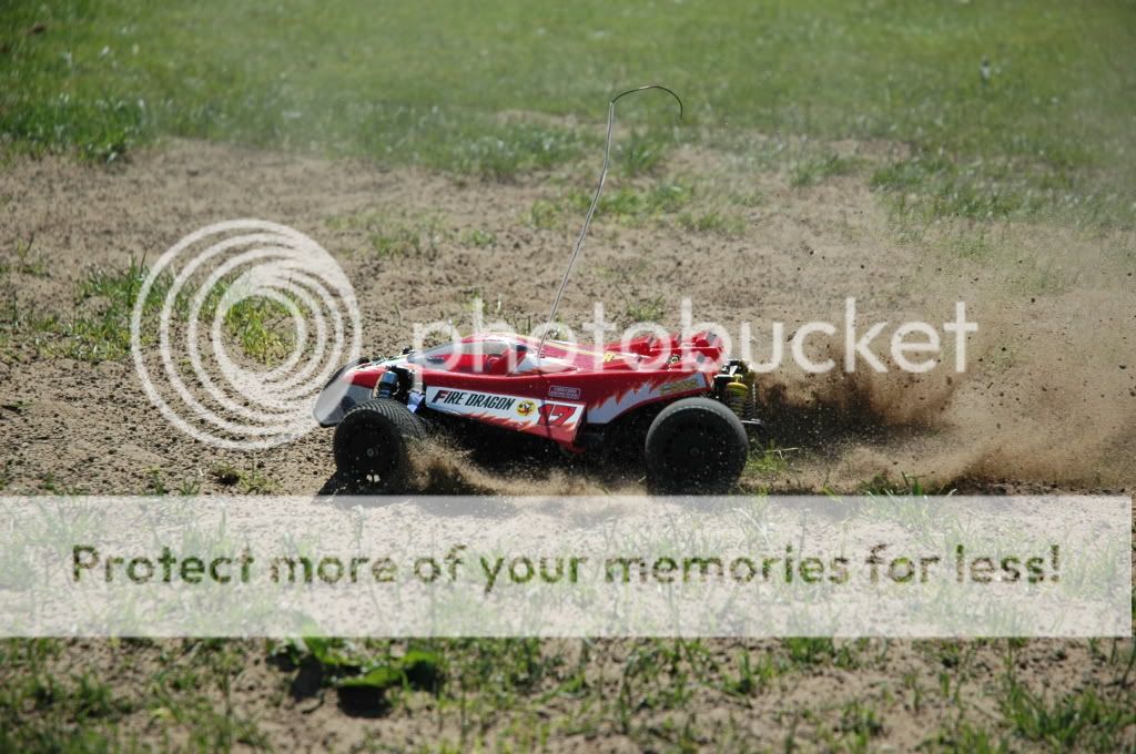

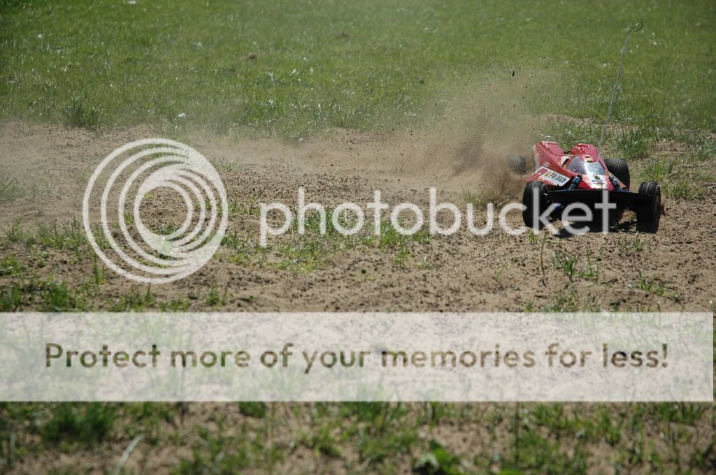

Hi all, had a blast with my FD today and got some shots in the park, even with the standard 540 we had great fun esp when we noticed part of the green was being reseeded! Thought I'd share the day:
Some Air!
A well deserved rest
All the best, 28

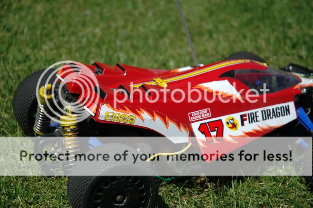

Looks like fun! Can you give me info on the wheels you're running?
Hi there. Yep the wheels and tyres are from a Dark Impact. I was running brushless for a while and the old wheels kept cracking under the power. These ones are tougher, have foam inserts in the tyres and have a grippier compound. I did need to get some hex-type adaptors to get the wheels to fit though as the original FD adaptors are not compatible.

Does the car need re-gearing for those wheels/tires? They look taller than stock and probably help the car go faster, no? Any overheating problems? Love the look of those; I've been looking for a nice alternative to the std spikes and those fit the bill nicely if there's no gearing problems.
I guess the DF-03-wheels do roughly have the same diameter as the original wheels. You won't need to change gearing because of that.
Dark Impact wheels are about a half inch taller than stock Thundershot/Dragon wheels.
Dragon wheels are 1.9" I believe. The same diameter as Falcon/Striker wheels and Madcap/Astute/Bear Hawk fronts.
The DF03 buggies possess an all new wheel which is 2.2" diameter.
The rims are 1.9 and 2.2, the wheel assemblies with tires are a half inch in difference diameter.
