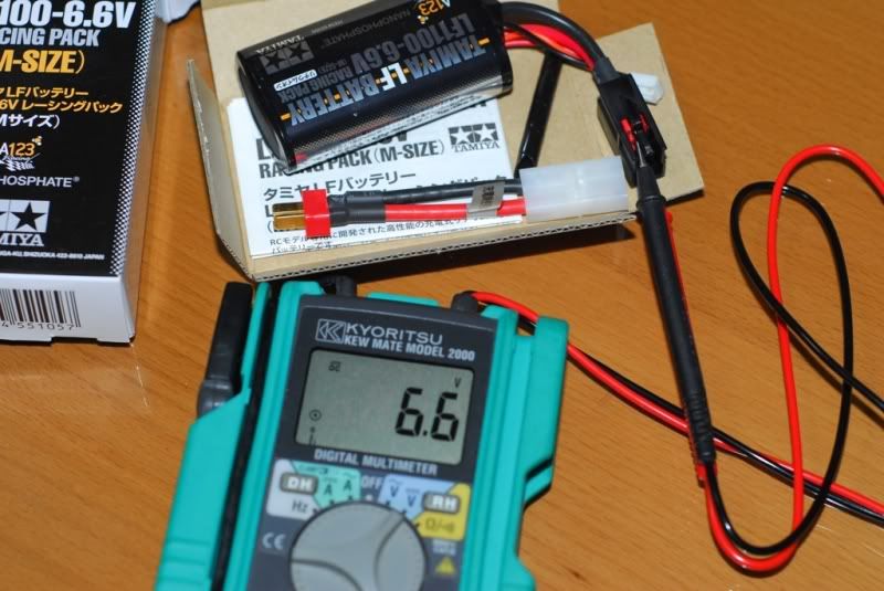

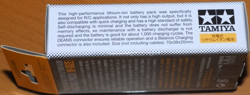

the battery is amazingly small. :o

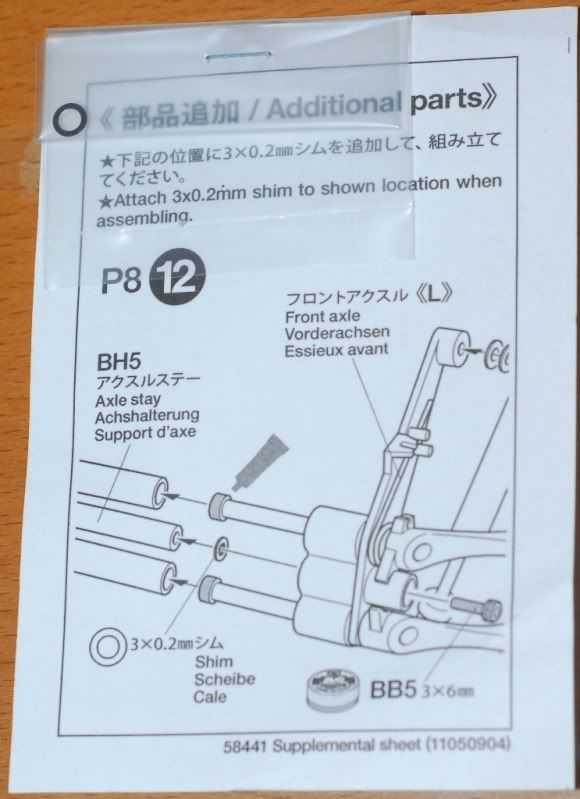

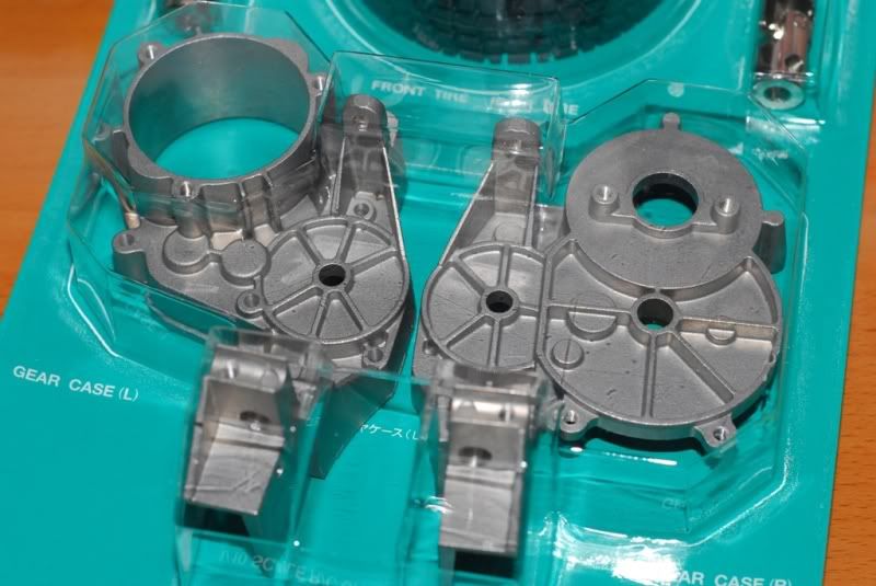

I am assuming this additional part is not to be mistaken as an optional part during the assembly. :o
Yeah im sure some else said its a manual whoops mistake lol! so you need to add spacer!

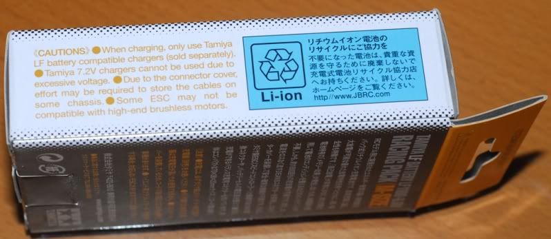

Thanks Lee. yes, the battery is really cool. The weight reduction is enormous. The buggy will fly with brushless motor. :(
I do not have a A123 charger yet. I am thinking of using the Hobbico Accu-Cycle ,....not sure if it's ok. :)
Hobbico Charger
Lithium-pack compatible! Capable of charging and discharging 1-3 cell Lithium-Ion or Lithium-Polymer packs — or peaking, discharging and cycling 1-10 cell NiCd or NiMH packs.
Product description above says Lithium Ion,...I guess it's ok to use this charger......right? :)
Product description above says Lithium Ion,...I guess it's ok to use this charger......right? :unsure:
Ideally no, but it is sort of possible because the Li-Fe cells can take a bit more abuse than Li-pos can and handle a bit of overcharging without catching fire.
In a Lithium-Ion pack the electrolyte is held in a liquid and has a high internal resistance. Nominal voltage is 3.6v per cell.
In a Li-Po (Lithium Polymer) pack, the electrolyte is held in a solid polymer and can handle higher currents. Nominal voltage is 3.7v per cell.
In a Li-Fe (Lithium Iron Phosphate) pack, the design is similar to lipo but uses iron phosphate cathodes which can handle even higher charge and discharge currents. Nominal voltage is 3.3v per cell. Notice the lower voltage.
Overcharging a Li-Fe pack with a lipo or li-ion charger will damage the pack.
If the charger is compatible in li-ion mode you should be able to set the voltage at 3.3v per cell. If not I wouldn't risk it myself as it can make the Li-Fe an expensive paperweight if it goes wrong.
A compatible charger will specify that it is Li-Fe or A123 compatible.
Great info, thanks for the advice. I will be writing in to Hobbico to get some feedback from them. If its good to use, I can save $200. :angry:
Hobbico technical support confirms that this charger cannot be use with the A123. ;)
time to go shopping..... ;)

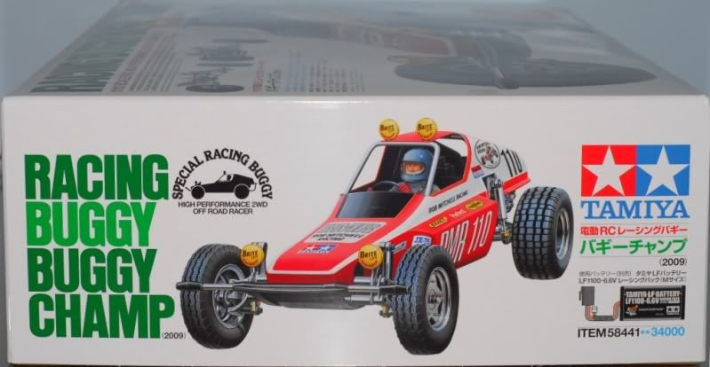

I saw that too. I think this is a very good price, at least there is an ESC and Li-Fe battery in it. (T-Shirt not included)
Goosh, I didn't know it included the Li-Fe Batt. ;)
I saw the box outside describing the batt as a required option with a sticker on the front stating that an ESC is included.
I opened up the box to take a glance.
Didn't see the batt inside :)
But I did see the beautiful packaging of the components :)
Maybe it is inside the individual box which was taped.
