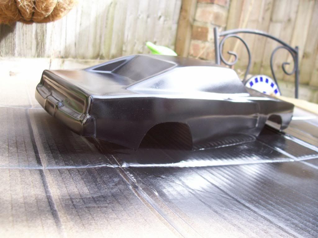

this arrived at the weekend so do i do a proper dukes of hazzard finish or do i go for the deathproof charger finish

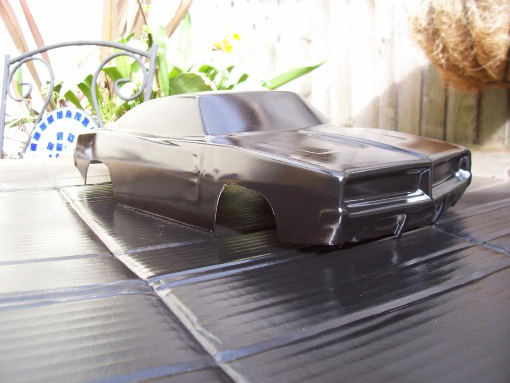

this is it cut out and placed on the lunchbox chassis

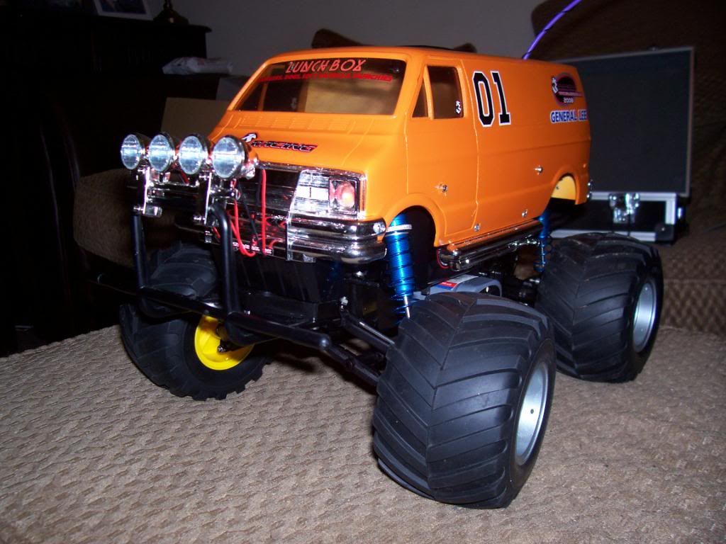

genaral lee finished lunchbox body with lights and a 3 racing crawler style front light bar

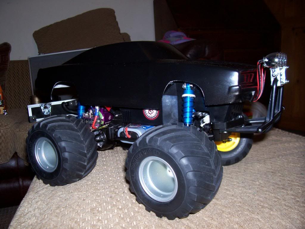

had a bit of an off with my dukes style body and that gave me an idea to really go to town on making the body look old beat up and rusty with odd pannels from other vans to add to the effect. whole body in grey primer and a couple of pannels painted ready to have a couple of light coats of white paint then its onto the finner details like rusty edges and old sighnwriting. pictures of progress to follow.
