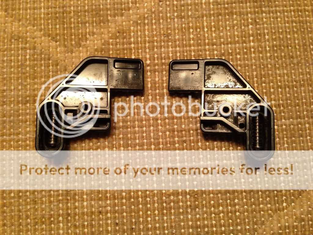

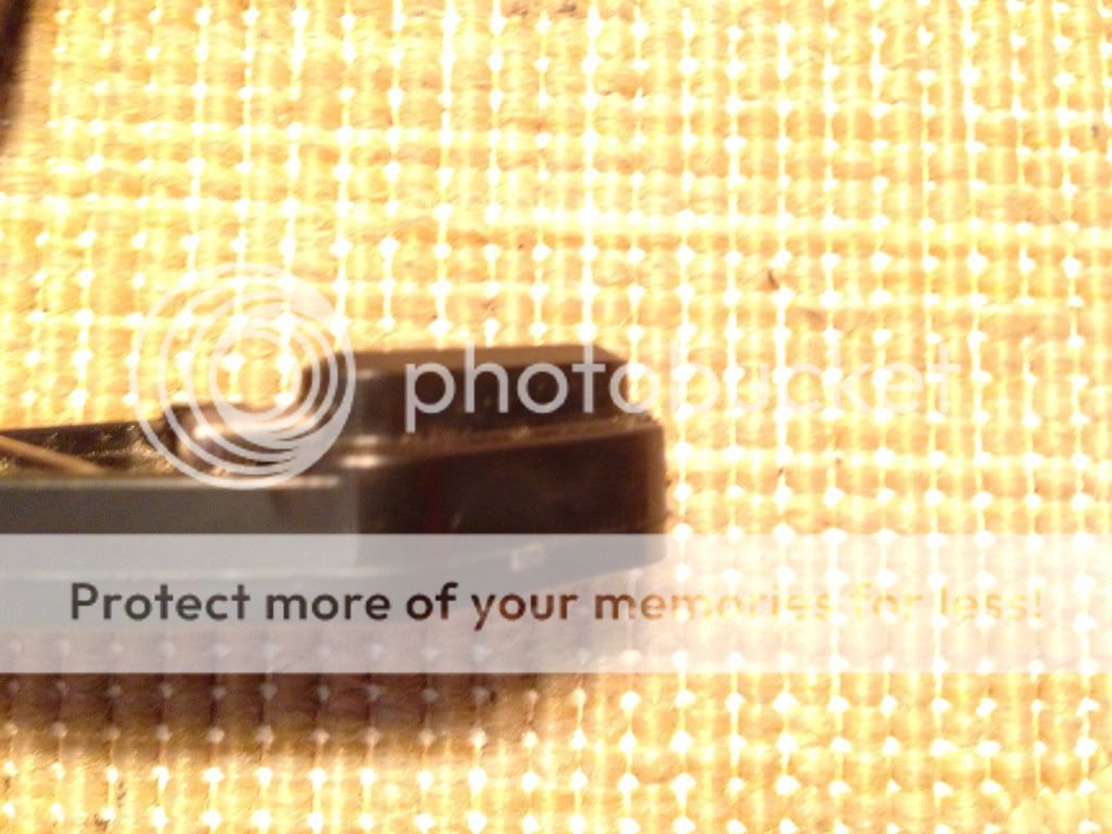

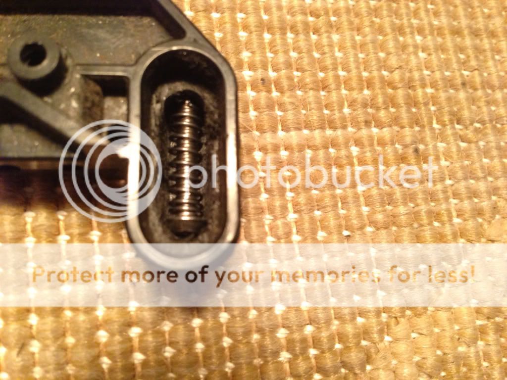

Finally managed to do the pen spring mod to the rear gearbox mount, took a bit of fine tuning with a Dremel but the result is a nice alternative to the 5th shock mod while retaining the stock look underneath. Some pics:

I assume you mean how effective is it? Well, I'd say its somewhere between doing a 5th shock mod and leaving it standard. I had to be quite careful as I have 75mm shocks at the back which are quite stiff so I didn't want to add a lot more stiffness at the rear or it would probably make the bounce worse not better. It certainly drives well on my 'box.

Sounds pretty good. Actually I was trying to know how does it work, like if the tip of that bolt goes up out of the gearbox's pivot support when pressed? Sorry I'm not too clear putting my idea into words tonight... I'm sleepy!
Ah right, yes the metal shaft that protrudes out of each end of the gearbox mount pushes on the head of the bolt which in turn compresses the spring. The threaded part of the bolt then extends out of the back side of the plastic mount. I'll take some pics shortly.

That's what I thought, thanks Steve!
I think one of the old golden flanged bushings that Futaba packed as extras with their servos might help the performance of the mod.
