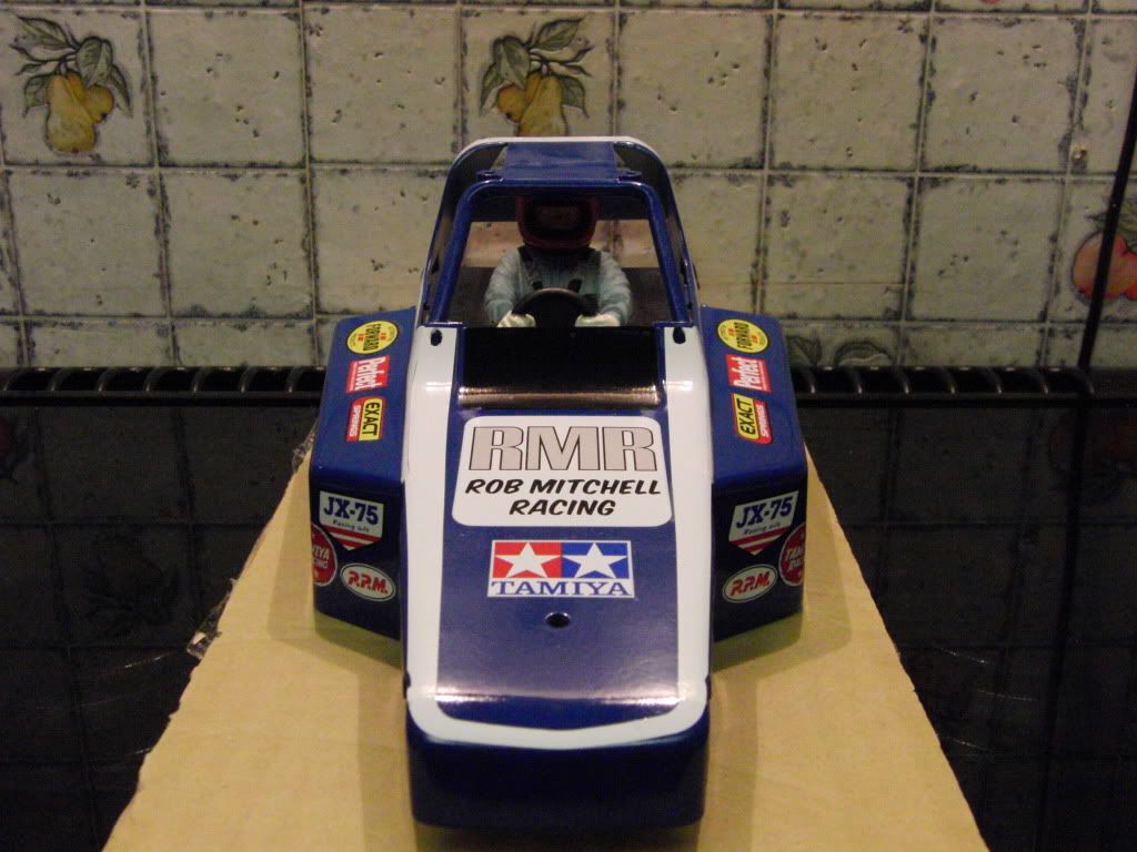

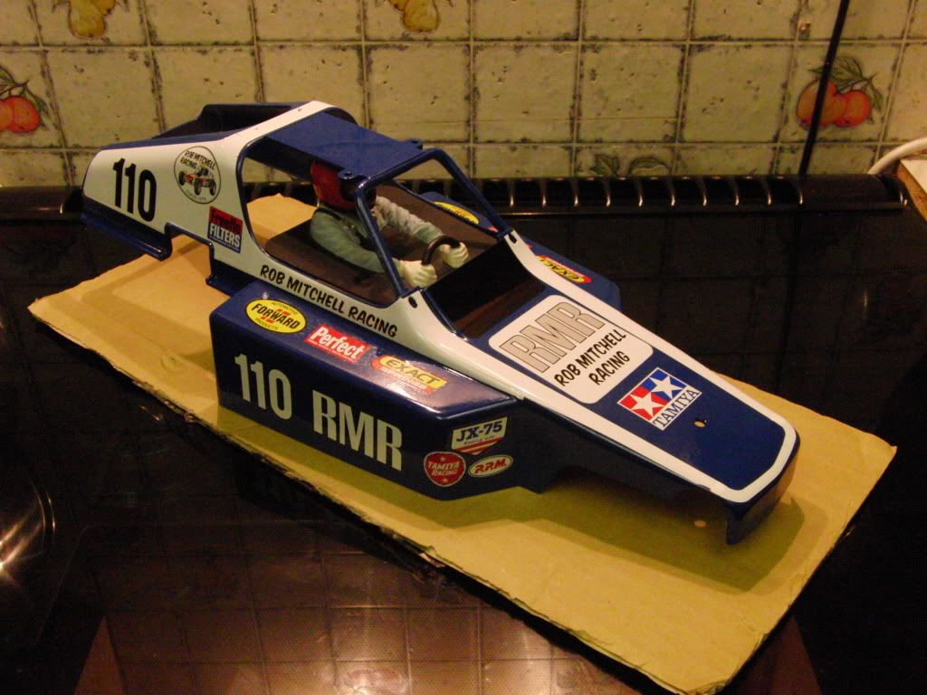

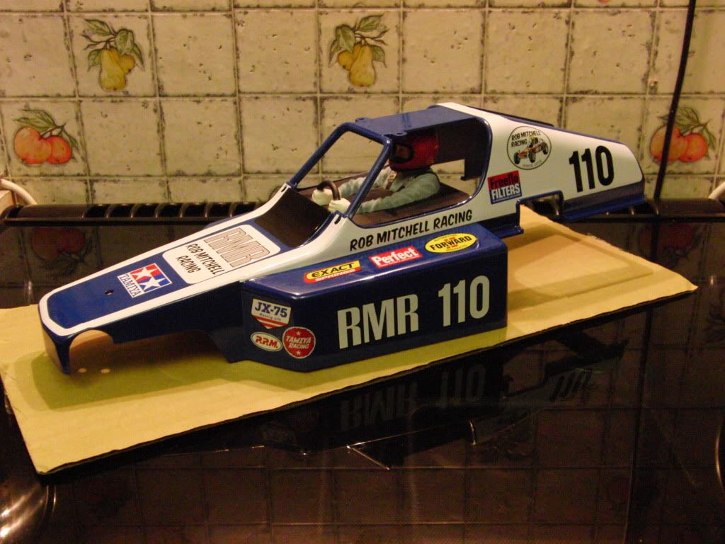

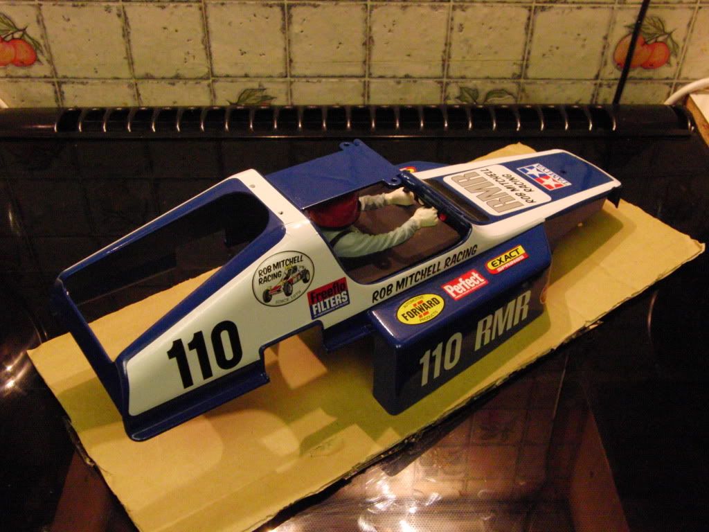

I'm pretty much finished building, painting (just gotta finish the roof) and decalling a Buggy Champ for my upcoming trip abroad... and it's official. I HATE the Buggy Champ decals. They're horrid. I hate them. I mean I REALLY hate them. They were so awkward to apply and really stuck fast without applying any pressure which only made them impossible to remove. Thank goodness I'd got them pretty much straight right from the start. They still went on badly though. I really wish I'd just painted the white parts instead because even though I put the side bits on straight (or as straight as I could muster) the rest seemed to go inwards so that the front looks squished. It's going to be a runner so it doesn't need to be perfect but it really didn't need to look this imperfect. Oh well. At least I've learned for next time. I should just paint the white parts and get some repro SRB decal sets.
Here's some pics of my shell.
When I did my Buggy Champ decals I used soapy water, the decals just slide around until you get em in place, then squeeze the water out.
By the way...I think your BC looks great.
I knew there was a technique I'd forgotten! :) As soon as I got about halfway through the decal sheet I just knew there was an easier way but I just persevered and powered on. :)
Thanks. Despite the decals it doesn't look particularly bad, does it? I think the shade of blue is a nice choice, even if I do say so myself. :)
Yours doesn't look too shabby either. Actually yours just puts mine to shame.
