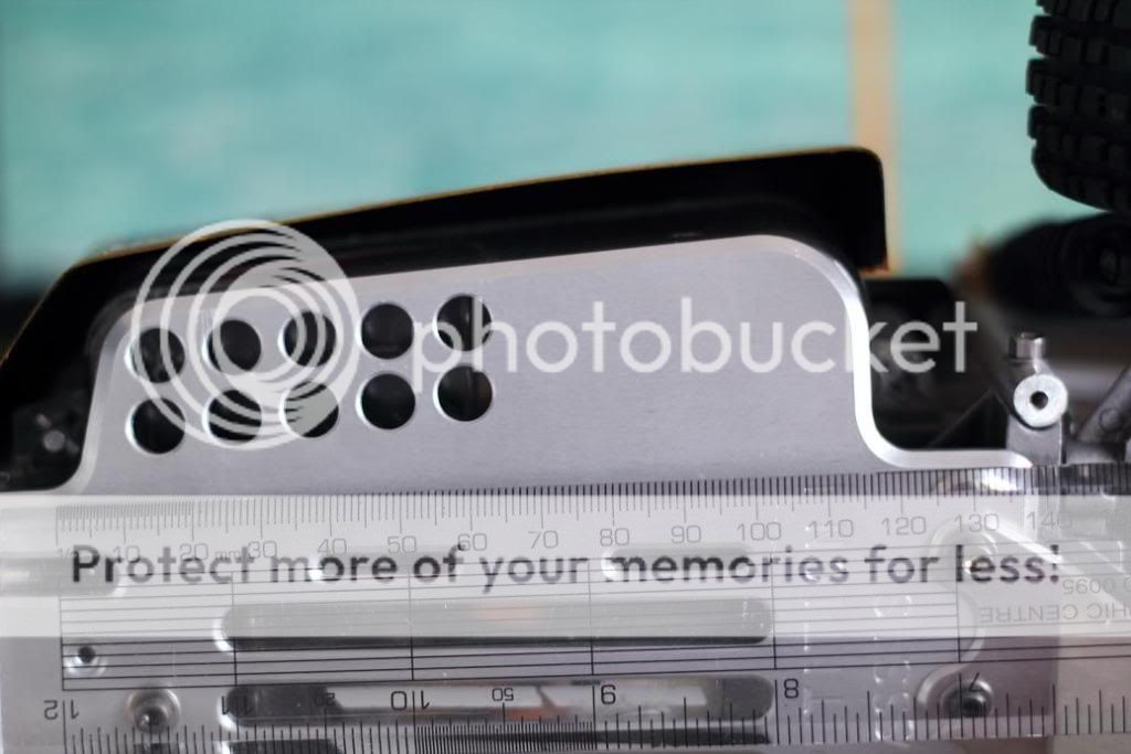

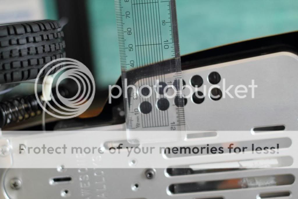

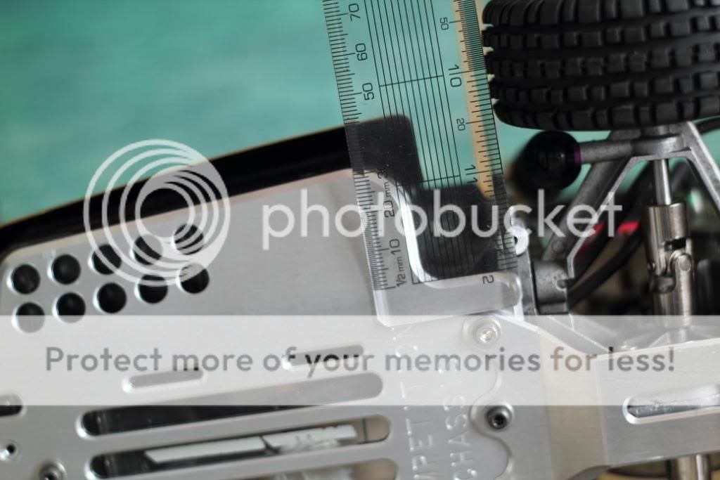

I urgently need some help!
Has anyone got an Awesome Alloys Super Champ butterfly chassis plate to hand? I need the measurements for the wings as I'm trying to get one made up. My Super Champ is in pieces and my body is badly broken (i.e. incomplete) so all the measurements I've tried to take so far are probably well off. Or if someone has a pristine Super Champ shell that can be measured up for a butterfly chassis that'd be just as good. I've been trying for the last few minutes to get what's left of my shell to hold in position so that I could try to measure it but it's a bit warped aswell so it's not going too well.
Has anyone got an Awesome Alloys Super Champ butterfly chassis plate to hand? I need the measurements for the wings...
Not sure if there was a specific SC version vs RR/SC one. This one is fitted to a RR. HTH
