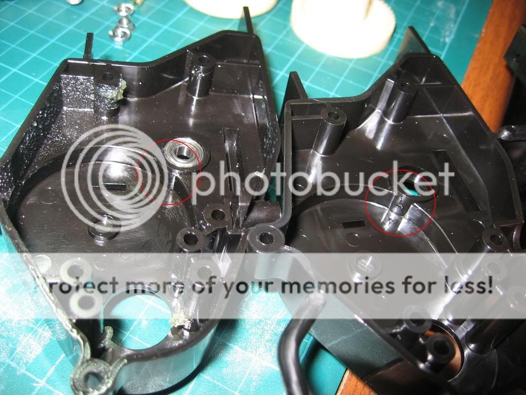

Guys, I have a related question.
I recently got a new gearbox case for my BB. When placing in the spur gear on its shaft, it seems its binding against the wall of the case and does not spin freely. At first I thought this is because the case is new and not "broken in" yet. But reading this post and becoming aware there are pinion and other differences between the Bear Hawk and the Blitzer Beetle, got me thinking maybe I got a Bear Hawk case which is not identical to the BB's?

Thats pretty strange. The Bear Hawk gearcase (A-parts) is identical to the Blitzer parts. Must be something else.
There is a molded spacer on the gearcase halves which should prevent the gears from getting in contact with the case.
Did you reassemble it according to the manual? Do you use ball bearings or bushings on the main shaft?

I had the same problem back in 2002, The Bearhawk and Blitzer gearboxes are slightly different.

Thanks guys, kevinthegerbil that post was really helpful. This is an example where looks can be deceiving. The parts only look identical and Tamiya fooled us again. Now where in the world will I find a Blitzer gear case (part 9225332)? I was wondering about part A5 being missing, now I see it's a different parts tree!
How many teeth does the BH spur gear have? The BB one has 50. I wonder if the BH spur is smaller?
How did you end up solving this? Perhaps just dremel the BH case a bit?

Wow, I have both Blitzer Beetle and Bear Hawk and never noticed the difference!
My dealer also quotes that the Part no. 9225332 replaced both parts no. 0005392 und 9005503. Strange! ;)
But anyways, I can get the 9225332 parts tree. If you want, PM me.

This picture shows the BH A parts tree on the left, and the BB on the right.
Sometimes the differences are so elusive, but they are there. Put the BH (on the left) and the BB gear cases side by side and spotted the difference that prevented the spur gear from spinning freely. Tamiya never ceases to surprise.
