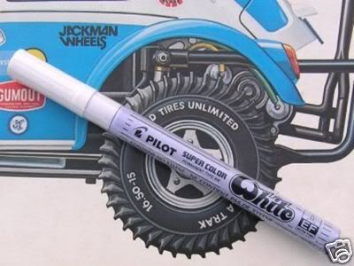

I used a white paint pen made by Pilot...
(Pic taken from a current ebay listing :))
That seemed to work well too, took quite a while but the results were impressive, and after quite a few runs over the past couple of years it hasn't come off!
