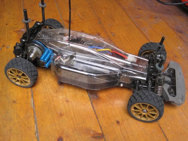

I bought 58417, its a different shaped shell though so I cant guarantee it will fit yours but it fits under the normal subaru with plenty of room at the rear for other shells.
heres a picture of mine (ive added more since the pic, its a bit more beaten up too hehe)
The car is pretty good as it is for bashing, most of the hop ups I think are more for when you start racing or put faster motors in or to bling it up. Slipper clutch can prevent damage from jumping and stuff. The plastic parts flex and take more pounding than the alloy parts which are also heavier so ive read. Ive got universals in which feel tighter but still unsure of how they perform against the originals. Heat sink bars can fit onto the standard alloy motor plate.
have fun building your car :) youll see when you first drive it that its pretty good out of the box.
