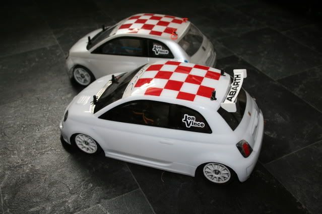

Well its the new year so a total refresh of my M01 was required. I totally stripped and cleaned every plastic part, blasted and re-oiled all the bearings, cleaned all the grease off the gears and in the diff. Whilst rebuilding it I fitted some nice M01 hop-ups I have been lucky enough to find here on Tamiyaclub :wacko: The motor heatsink is a far better design than the M03 one - it actually sits on the face of the motor so should at least take some of the heat from the motor rather than relying on the motor screws like the M03 one does :angry: The bushing set replaces all the step screws with top hat bushings and new screws which seem to allow the suspension to move nicer. The "pièce de résistance" though is the ultra-rare "Aluminum Racing Steering Set" that replaces the horrible plastic front swivel pieces with nylon top hat bushings and aluminium swivel pieces - very nice indeed ;) I realised at the last race of the year that the servo saver wasn't sitting properly on my posh Hitec servo so I bought a Kimbrough one to replace it - this meant that the standard M01 steering arm was too loose in the holes so I used a piece of 2mm threaded rod to replace it. Thats pretty much it - apart from a new sticker job on the shell which makes it look a little more "racer-ish" :)
I am the only racer at our club with an M01 (a fact which I quite like) so lets hope I can keep the car near the front to show all these M03 and M05 boys how its done ;)

The sticker job...
and my favourite sticker of all :D
