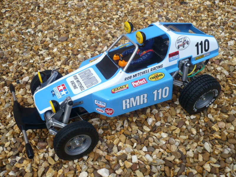

i sprayed my BC body with tamiya TS paint directly onto the white plastic, and it came out flawless.
i got the ts-10 paint off ebay. 6.99 a can.
i used about a can and a half of the stuff. it goes on beautifully!!

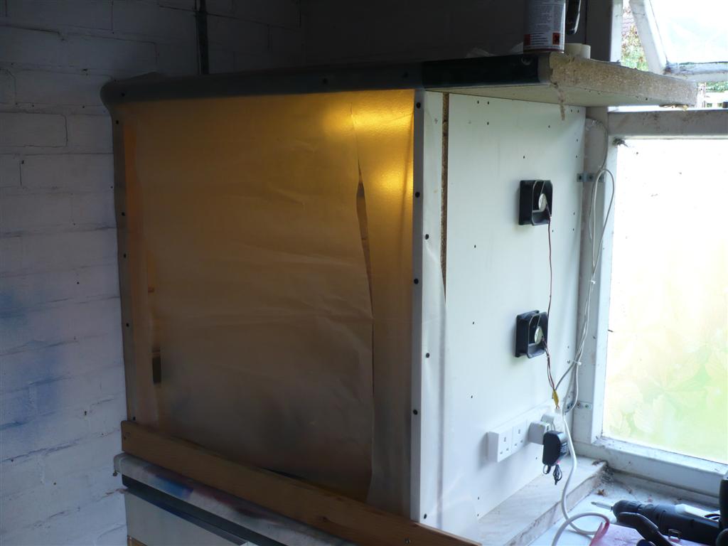

i sprayed the shell in my "spray booth" in my garage
