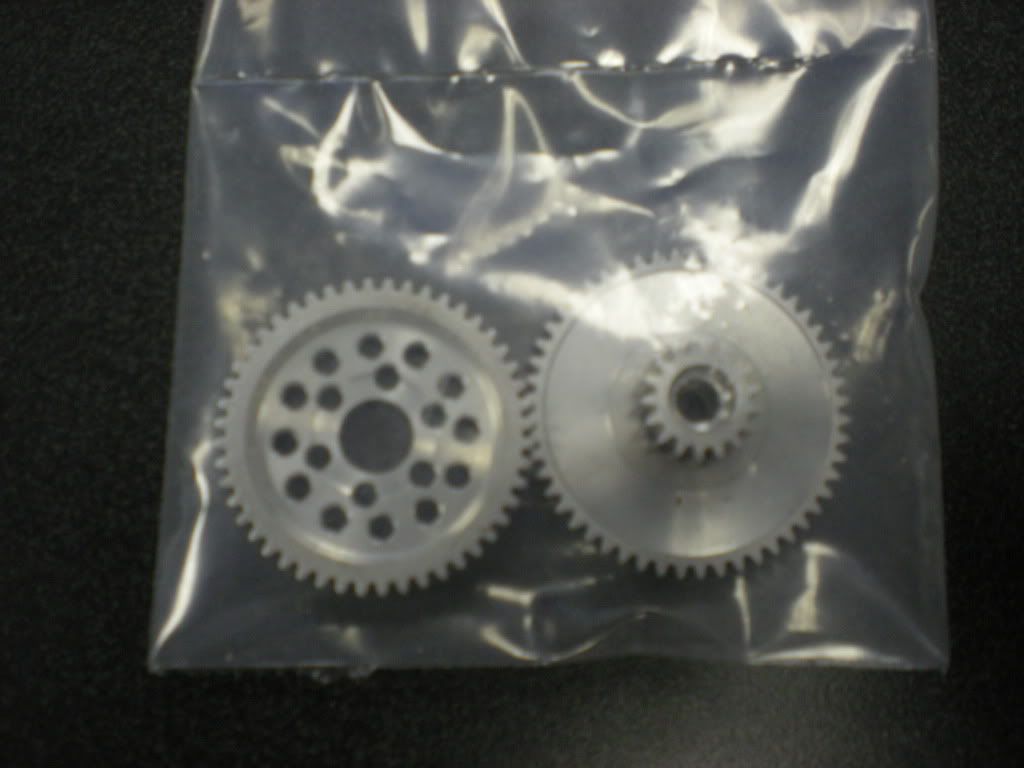

Just bought these babies!
Still in test mode trying to test out all of the aspects of the fitment and all that.
So far so good exept that the balls in the diff have a loose fit :( I well see how it goes.
Specs-
-B-foot ball diff (like the thorp) comes with counter gear
- Gussing they are alluminum?
-$37 USD to the door.

The ebay seller stated the manufacturer as "GT gears"

Yeah, it is the ball diff gear and counter gear that you get. You use these as an "upgrade" from the THORP style ball differential, which I already had. I ran the thorp style diff with all of the thorp accessorys until I destroyed the counter gear. So I bought these and used all of my other thorp parts again.

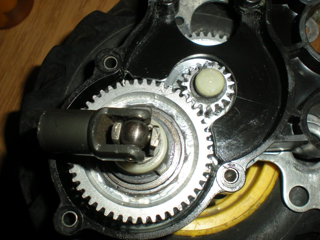

All right. Got in some packs with the gears installed. Didn't run right at all.....
Soooo. Broke it down again.. and it seems as if the counter gear( where the pinion runs) was dragging on the outdrive houseing for the Thorp Ball diff..hmmm ok? Almost destroyed it, but its savable. To solve the problem I shaved a small amount of material from the outdrive and it all works good now. Except I blew a fuse on my ESC and I have to wait to get another fuse... Oh well B)
