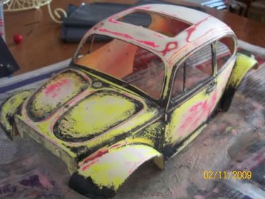

After many years, I have finally dug out my old Monster beetle from the loft, with the intention of restoring it back to its original state for my son (and me :D ) to enjoy.
Ive managed to locate most of the smaller body parts like the number plate light housing, spot lights, rear lights etc...
Parts so far that i require to replace are: wiper arms, window, front lights, decals.
It was MB red when my dad first built her for me, however for some reason throughout the 90's i wrecked it by coating her in luminous yellow, pink, and matt black :rolleyes: .
Because of this i have firstly paid attention to the shell. i got myself some Mr muscle and started to strip it back. Found that it is white plastic.

Getting there with the shell. Got to get some more Mr M. This thing is caked in paint. :o

Man some of you guys have all the luck with MM, I tried it and it didn't even touch the paint :o
Yeah that's the one. It also has the bearing sleeves on it for the gearbox if you decide to rebuild it at a later date.
Man some of you guys have all the luck with MM, I tried it and it didn't even touch the paint :(
Ive put a lot of work in with wet 'n' dry though.

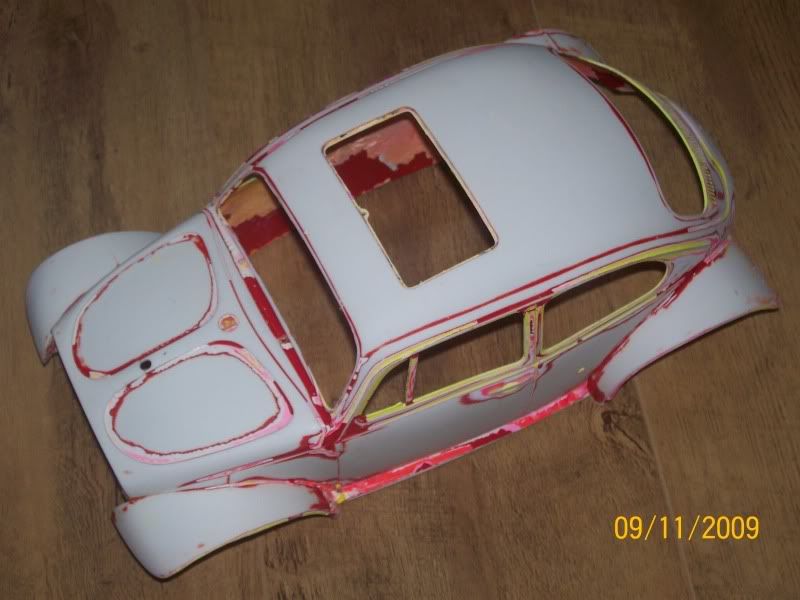

Update on the resto. Got the glass through the post that was smashed, super glued the offside corner of the front screen. You will never see the damage as its hidden by the shells pillar.
I used a spare part i had to act as an aerial holder. Also used the inner of a trigger spray bottle for the aerial tube. Works perfect.
I fixed the spotlights to the nose cone using some mecano strips, securing them into the back of the headlight bowls. All good peeps.
Body is flat and ready for primer now also. I was thinking about either painting her in the original red or maybe a 70's orange!
what do you think?
