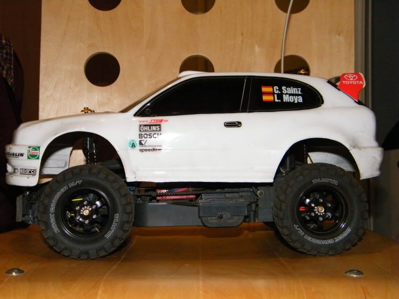

IMO you could make any rally car chassis into a high ground clearance "buggy" by simply putting bigger tires on the car and raising the body with body post extensions.
This is my tarmac rally car
This is my intermediate "buggy" Dakar style rally car
This is my high ground clearance "lifted" rally "truggy"
As you can see, one chassis that can be configured for 3 different types of terrain. The only difference between the 3 configurations are the wheels/tires and body post height.

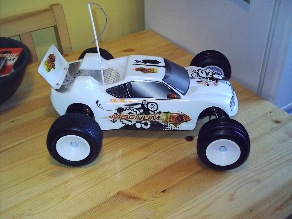

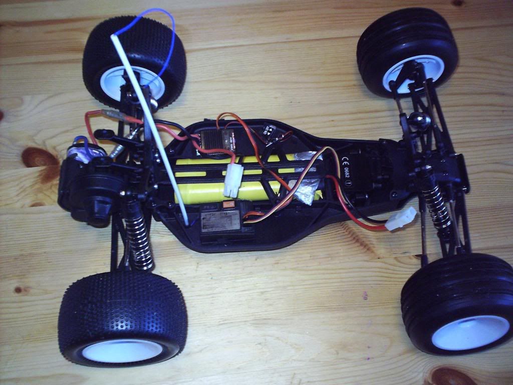

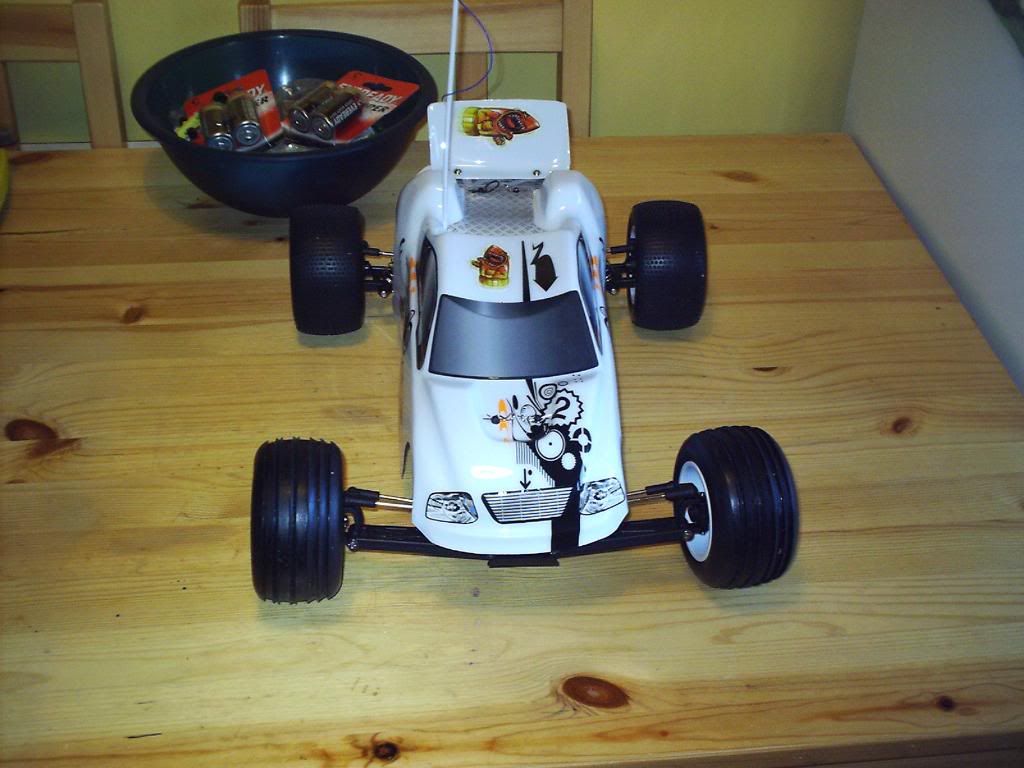

Right its up and running thought id share my thoughts on it.Now being used to working with tamiyas perhaps its my fault as im using tamiyas as the benchmark where as i should may be be looking at it as a radio controlled kit by itself,but here we go.
I`m not greatly impressed by the kit to be honest.The chassis and lower arms and the ball ends seem to be made from a very hard plastic,almost bakelite type material that i very much doubt will take the abuse a kit of this nature will get.It seems far too brittle and the type of material that will become even more brittle in cold weather,similar to upvc. The body is a very thin lexan type affair,and admittedly its never been one of my favourites it seems to be very flimsy,thin and light and i woudnt be surprised if it ripped very easily.The tyres seem to be very thin rubber with no stability in them whatsoever.
The build itself tbh i thought was poor screws dont fit properly and to make things worse all of them except four are allen head screws.Even with good allen keys the screws stick in the material and strip the heads. The instructions i found to be as clear as mud!!!
Silly little things probably that Tamiya do that do actually make the difference,like all screw lists at the side of the instructions are in fact 1:1 so instead of messing about sorting out which screw is which, on a tamiya you simply measure the screw on the diagram and away you go,where as the ansmanns you have to sort out whats what and bags arent labelled in the order you use them.
The Instructions dont follow any specific order either seemingly,you build the front end then go to the rear end then back to the front for the steering,then back to the back for the gearbox,then back to the front for the suspension etc. It leaves you with the overall feeling of GRRRRRRRRRRRRRRR!!!!!!
Like i said its maybe me being too picky,but if they have had the idea of budget range to bring in youngsters into R/C kits or to compete with tamiya and kyosho kits etc theyve missed a golden opportunity.
Right,now that the niggles are out of the way the plus points :)
1) it shoudnt but the steering sets up in five seconds flat!!! Center your servo in the usual way then a quick twist of steering arms and your off!!
2) The steering arms front tie rods and rear tie rods are adjustable,rathar than solid moulded so any slop is instantly got rid of
3) The construction is basic,no frills so easy to fix if it breaks.Floor pan,four bottom arms,two steering arms front and back suspension trees and four body posts!!!!
4) plenty of space inside so cableing looks neat
5) there are some nice touches in there like moulded cable clips for the motor wires,All round oil dampers though they would benefit from heavier oil, ball diff and ball bearings on the ends of the steering pins!!!
And the most important bit.It is a fair bit of fun to drive.I had a spare ansmann clash motor and esc that i have given him for now and even with an old 1400mah battery it goes a bit.run time isnt that long obviously,but we had a bit of fun both over the rough in the back garden and out the front street on the snow and ice.
Its made my lad happy but if i had the choice again hand on heart I would pay an extra few quid and get a Tamiya.
Coming from a racers perspective and having built the Mad Rat (buggy version of the Macnum) my views on it do differ slightly.
As a racer one of the reasons for buying it was for the carbon reinforced nylon chassis and suspension parts, they keep the geometry stable because they don't flex like Tamiyas ABS parts do. The same plastic is used in all high end cars as the stiffness makes the handling more reliable and any suspension adjustments can be felt when driving. Softer plastics makes it more likely to flex in an impact, but it means for racers the handling isn't consistent enough to follow the same line lap after lap.
Lexan bodies are used because they are much tougher than the hard plastic used on others. Saying that, the Ansmann bodies aren't the best quality and my Mad Rat wing was ripped in half following a big accident. I expect the non Ansmann replacement I bought will last considerably longer.
They aren't supposed to have any stability, the rubber is soft so it grips and the foam insert is there to hold it up. The kit tyres work very well, and are no softer than any other decent stadium truck tyre.
Leaving out an allen key set is ridiculous, but every allen key I have ever had in a kit has gone straight in the bin as they are next to useless compared with a proper allen driver. Allen head screws are standard hardware on race cars as they make for easier assembly and disassembly for the regular maintenance racers do to their cars. You will find the same problem trying to drive the screws in to an Associated B4 or Losi XXX. The Tamiya Durga is made of the same plastic and you are advised to replace the kit pozidrive screws with hex drive ones as they are then easier to drive in.
I suppose again it is what you are used to.
The build order is designed so the parts are assembled as separate modules, so you can see how to disassemble it in chunks if/when you break it.
Some decent points Terry and i hadnt thought of it from a racers perspective tbh, More from the point of someone who enjoys building and bashing. So the build order might come in handy after all!!
