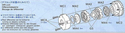

Have you tryed taking one of the small bevels gears of the star shaft and putting it between the other two ,then put diff back together . like in pic
Thanks for all the replies, but I was hoping that an engineering whizz out there would have a neat easily switchable solution...by which I mean something like the F350 type locking pin affair or even an actual 'switchable' control. Crikey, I don't want much do I?!!! Oh well, if you don't ask, you don't get!
Mike
