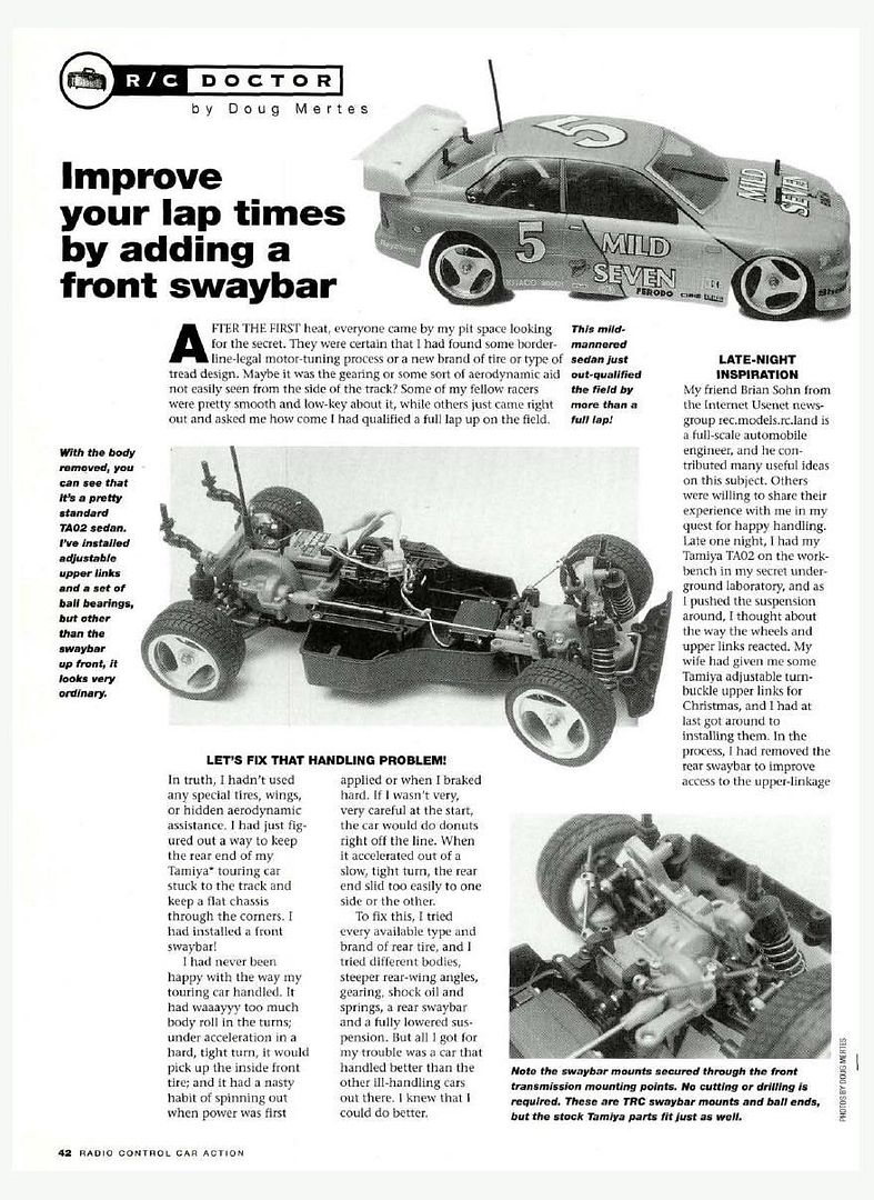

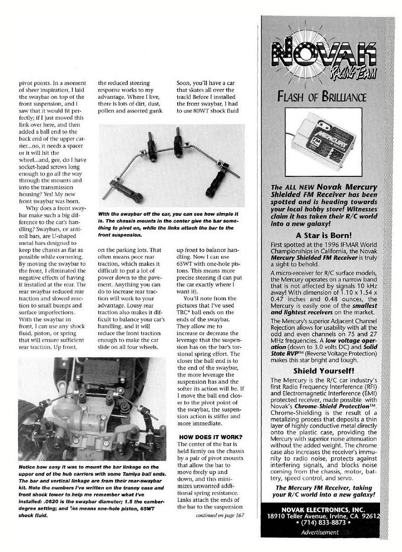

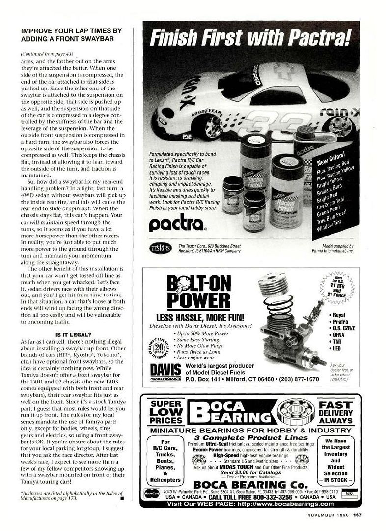

Tamiya only offered a rear swaybar for this chassis, as a front swaybar wasn't really needed with all the understeer it would create.
If you're still curious, RCCA did an article years ago about this very idea:
-Steve
*EDIT* I can't for the life of me figure out how to get these to post full size, so my apologies for my compu-ineptness...
OK - Pictures are now full size when clicked on.
I will never understand how this forum works :D
thanks alot! that info helps me out. i sort of figured that the front sway bar that came with the car i got didn't look like it belonged. it sort of looked like one off a kyosho product. i have a lot of parts i have to go through and get rid of especially stuff previous owners threw in just to get rid of it.
